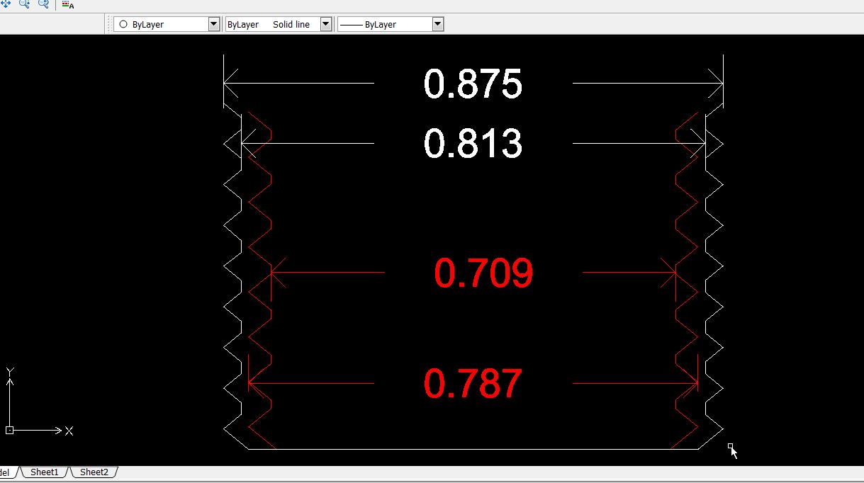

7/8-14 is 0.088" up in size. You shouldn't even need to run a drill into it. Tap is going to be expensive though..
   / Where to buy a metric bolt #14
.088" is alot when talking drills and taps. No way you are gonna run a 7/8-14 tap in a hole threaded for M20x2.0.
7/8-14 requires a 13/16 bit (.812")
The M20x2.0 would have been drilled with a 18mm bit. (~.708")
Just aint gonna work. The root of the threads in the existing M20 hole are still smaller than needed for the 7/8-14. IE: of you drilled it out for 7/8-14, you would not only remove the threads of the M20 hole, but also about 0.040" of virgin material.
So...yea, you would have to drill if you want a UNF 7/8 bolt

Finished diam of M20 hole is 0.787"....
In reflection, there may not he enough material for a 7/8 thread.
   / Where to buy a metric bolt #16
.787" is only where the threads have been cut.
The "peaks" of the threads in the hole will still be .708" diameter.
Give a 7/8-14 requires a .812 drill, that will remove ALL of the M20 threads AND a little virgin material. How can you possibly say there may not be enough material?

This may help. These are the threads to spec, superimposed on top of each other.
M20x2.0 in red
7/8-14 in white
The threads look flat on the tips, because they are. Threads with a drill and tap are NOT 100%. Those dimensions are assuming using the reccomended 18mm bit for the M20, and 13/16 bit for the 7/8 UNF. And assuming cut to the maximum depth spec of the particular thread
