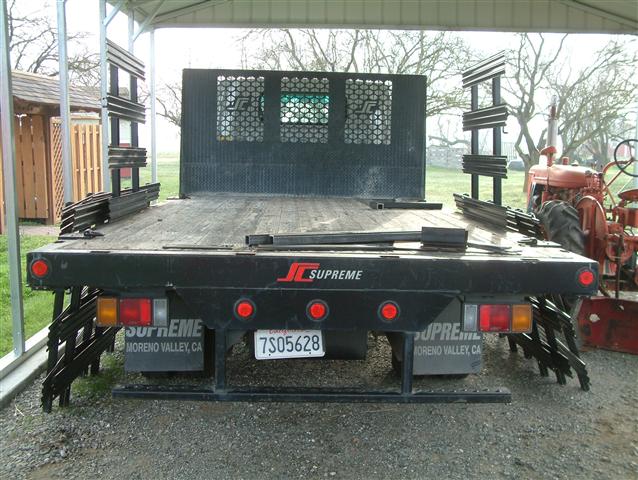

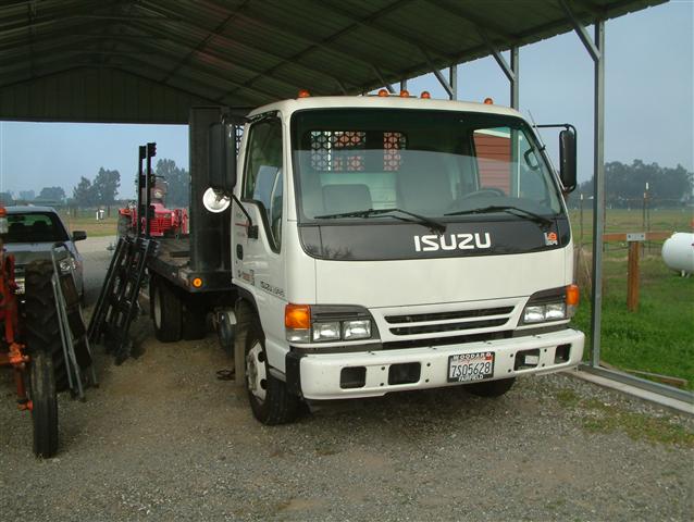

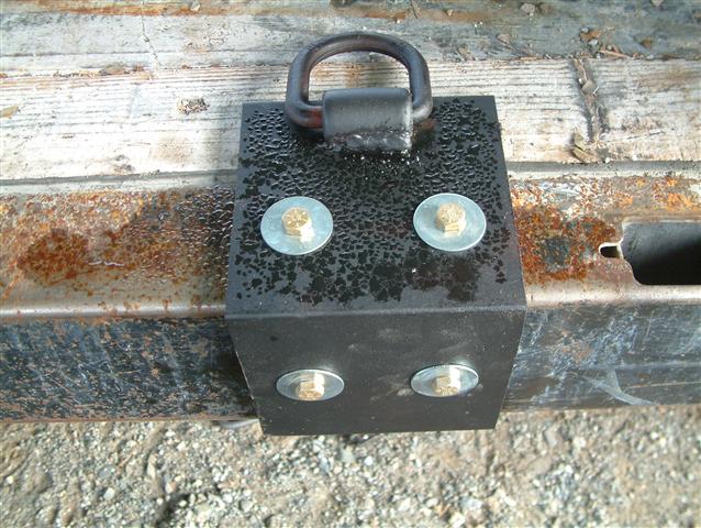

Last week I added four D-ring tiedowns to the Isuzu NPR stakebed (8L GMC V8 gasser) I bought last month to haul my parade tractors.
The weldable D-rings are rated at 12000 lb, welded to 6x6x3/8" angle, bolted onto the stakebed frame with four 3/8" grade 8 bolts. The frame material is only 3/16" thick so I decided to use bolts rather than weld the angle to the frame. Also I don't feel comfortable welding around that 30 gallon gas tank.
Next job: install an 8000 lb Warn winch.

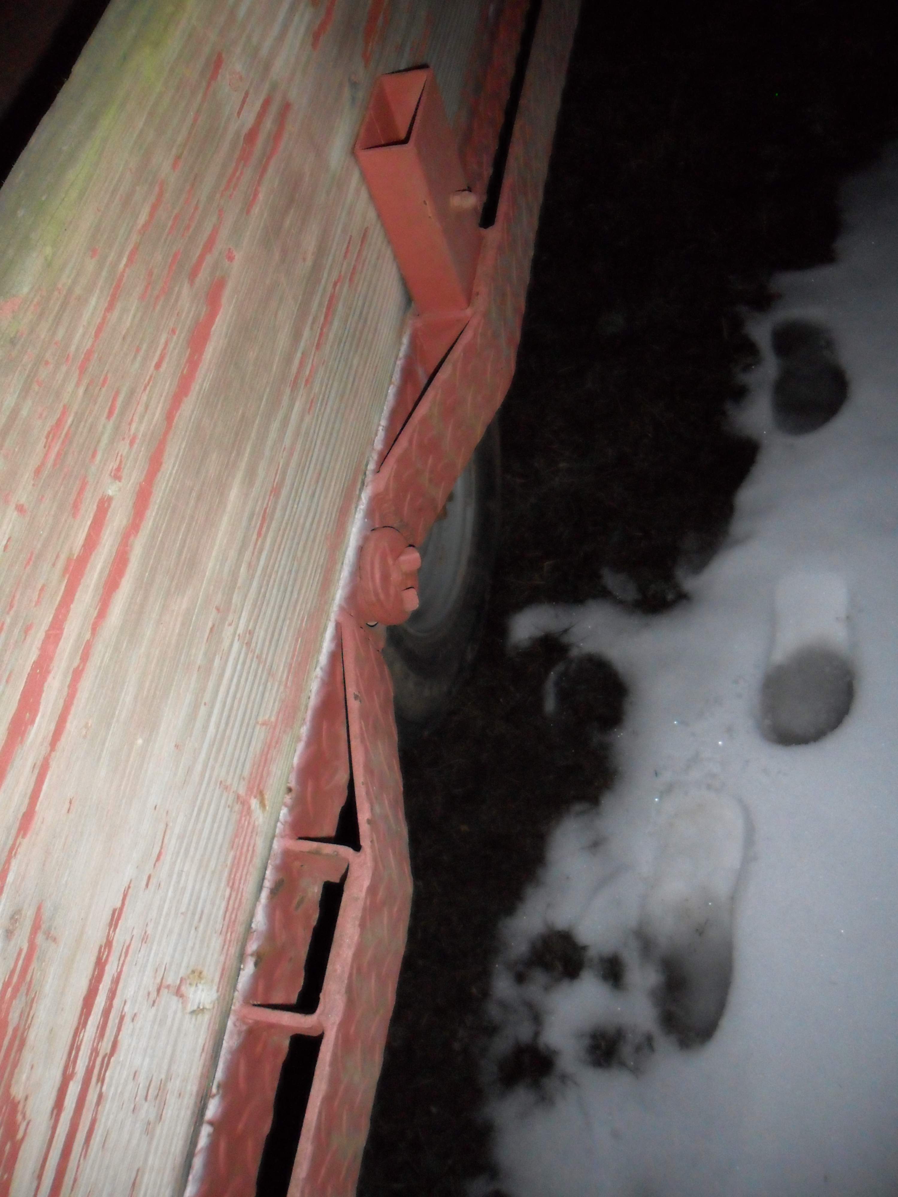

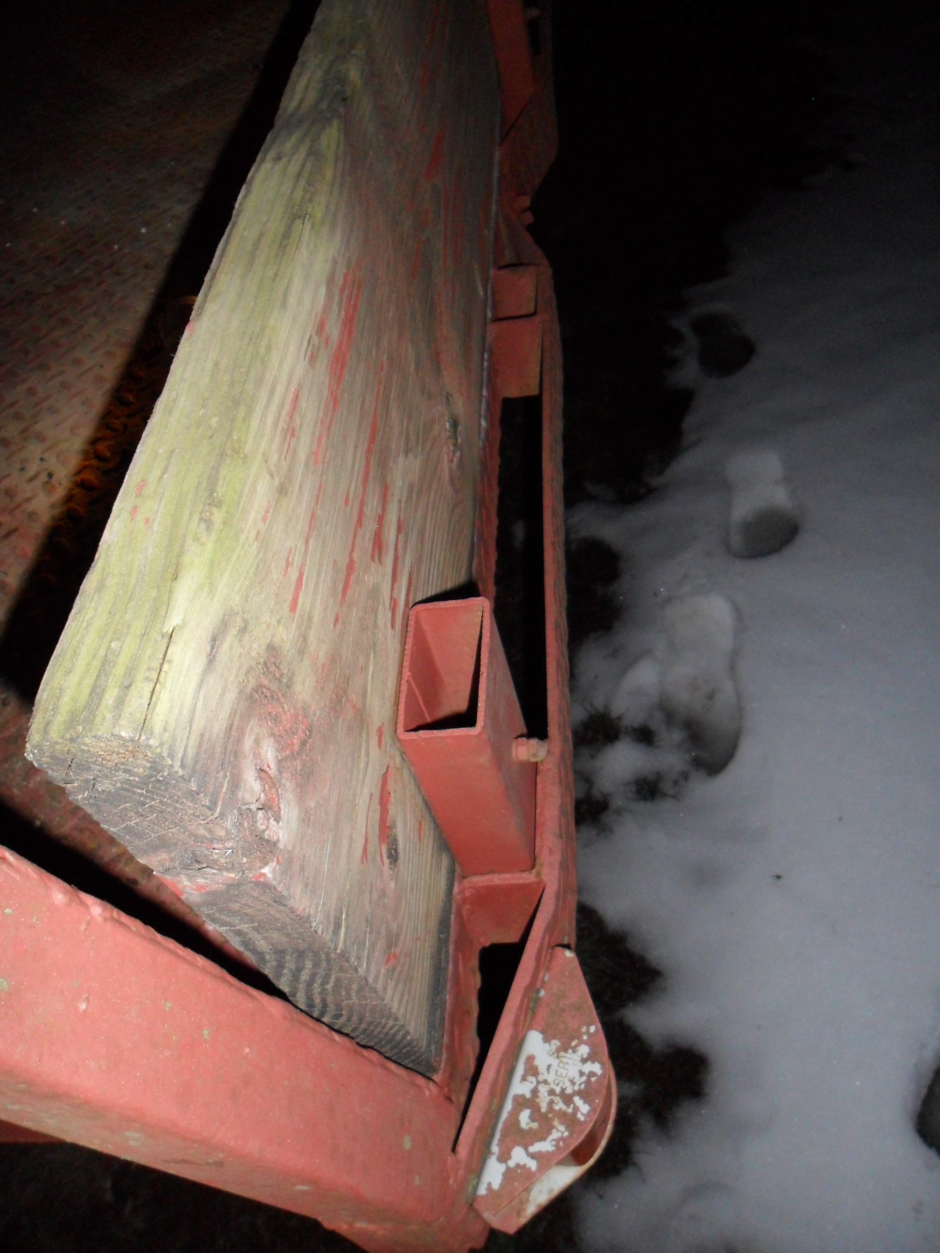

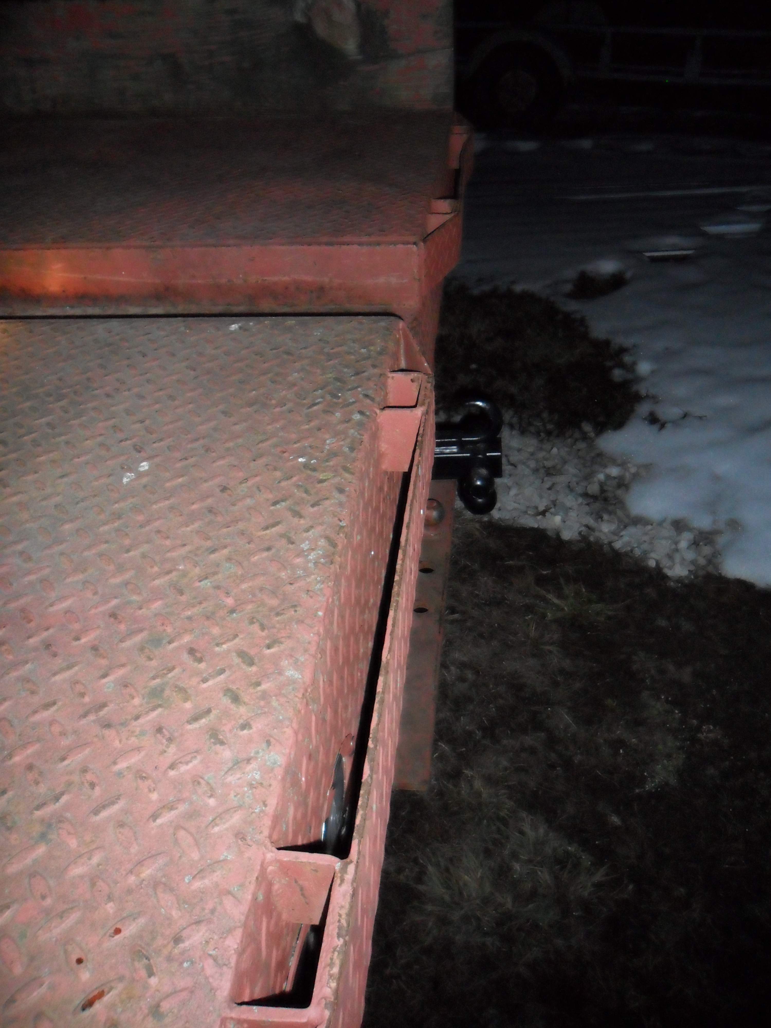

Slash Pine mentioned stake pockets. If adding them will not make your trailer too wide, they work very well. They will allow you to put sides on your trailer, or just to have stakes in place to keep longer material from sliding off the sides. I prefer them for hooking chain to. You drop the chain thru the bracket and then bring it up the outside and hook the chain on the top. This will keep the hook from releasing if the chain should become slack. To keep the brackets / pockets from twisting and catching on obstacles, most people will weld a strip of 1/4" flat across the outside of the stake pockets linking them togather. This length of flat will also help stiffen the bed. The pictures attached are on a truck bed I built years ago. I used tread plate for the strips. Now I use standard sheet metal strips so I have a smooth surface to attach the required reflective tape. I live in Missouri and the stake pockets which are designed to work with 2x4s are readily available in the local tractor supply stores. Prices range from $2.25 to $6.00 each. (The ones in the picture I bent in my press to accommodate 1 1/2 x 3" tubing.)
Have Fun! John
