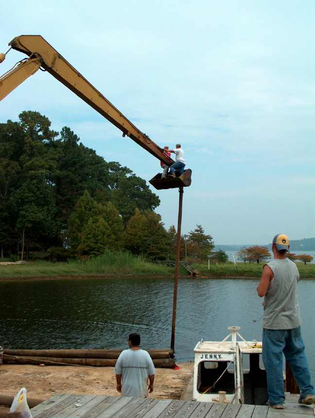

The type of construction really depends on the type of water bottom you have. Here in east Texas we have a sand and clay bottom so you have to drive the posts into the mud far enough that they can support the weight. I will attach a series of pictures that show how they used a trackhoe to push and pound pressure treated telephone poles into the bottom anywhere from 6 to 8 feet deep. They basically kept pounding on them until they wouldn't go any farther. The first is the picture of them swinging one of the long poles into position.
Terry
