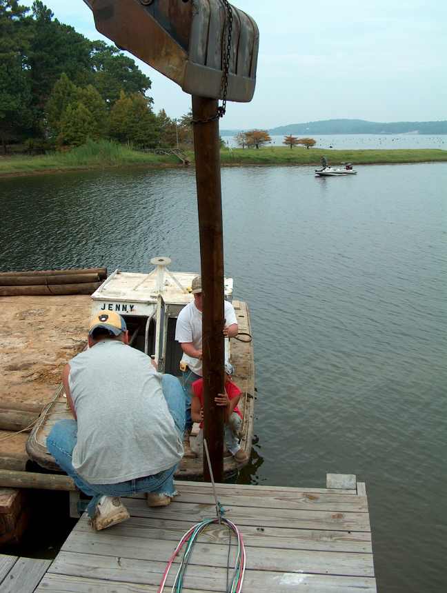

This is one of them driving in a short post for the pier.

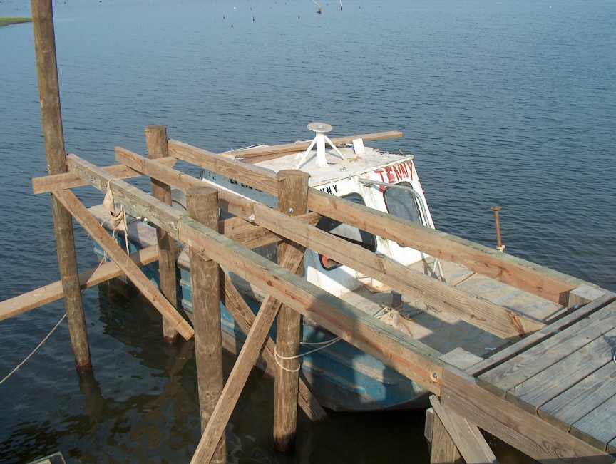

   / Where to find info on building a pier/boat dock #12
This shows the short pier posts and one long dock post installed.

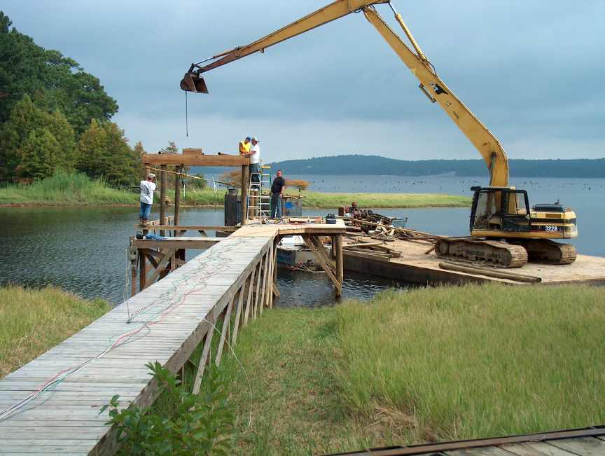

   / Where to find info on building a pier/boat dock #13
Here is a picture of the trackhoe and the crew working on the boat lift roof frame.

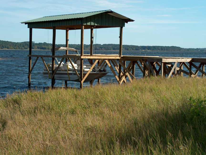

   / Where to find info on building a pier/boat dock #14
This is the almost finished product.
Terry

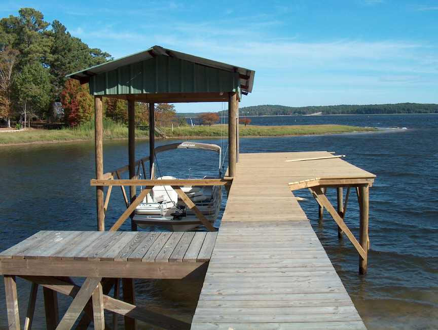

   / Where to find info on building a pier/boat dock #15
Side view of the finished product.
Terry
   / Where to find info on building a pier/boat dock #16
Here we use air hammers even smaller electric hilti hammers to drive 6 inch steep pipe possts in for floaters. My friend William even made one that has spud poles the walkway pivots hold it inplace against the current. William had a work barge with a tower on it, the tower had a sliding 500pound weight attached to a car axle type drop hammer winch. then later and old dozer winch. the poles were plubmed them hammered in. If its a TVA site you may want to check with the authorities to see what the deck square footage is there . Here I think you can have 3 decks that have 400 sf each.
   / Where to find info on building a pier/boat dock #17
Terry,
Great Pics. Love the trackhoe on the barge!!!!!!!
Eddie
