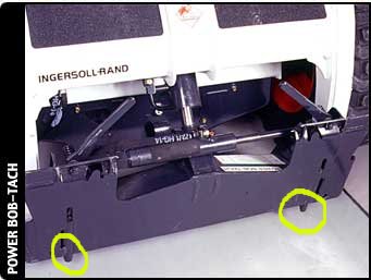

<font color="blue">This dealer also had two of the quick attach for the loader end. They were buried in the back of his shop under some pallets, etc. </font> Something important to look at. How easily do the pins (wedges) retract? Marked in yellow on photo. Had one that got bound up from non-use, ended up cutting the bucket brackets off, removing the qa from the machie, torching out the wedge and replacing. Not a lot of fun if you can avoid it. On mine, buried inside are two grease zerks to lube the wedge.

Thanks for the great info and picture!!. I will take a good look at the pin/ wedge on these quick attach brackets when I get back over there. If I remember I will take my camera with me and can post a picture.
