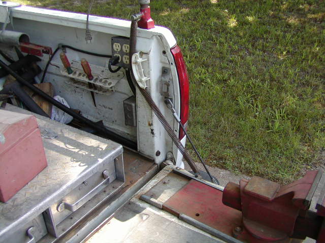

Last night, I debated showing you my table mount, quick change vise's. I built them before Harv educated me. I like his idea best because it is will work any where there is a receiver. My table vise's work great but won't mount anywhere else.
Now tonight you mention working on your tailgate & you ring my bell again. Harv may know a better way on this also, but here is mine, just in case.
16 gauge sheet metal on all of tailgate except where vise slide is, so you have a smooth work table. Be sure to turn up 1/2" at rear so parts don't roll off between bumper & truck.
Mount vise on 1/2" thick steel & make 2 part slide for it to move in. Drill hole to drop pin through if you need to lock it in place. The 2 part slide is mounted in pickup bed and on tail gate. Slide vise in & close tail gate. Open tail gate & slide vise out.

Another view.
Note springs from dishwasher door. One on either side. Adjusted so the tail gate will just barely stay down. If you open & close it 20 times a day, sure does help as well as offsets the added weight.

Are you running the 120v outlets from an inverter, or do you have an onboard generator?
   / Where to mount a vise? #17
They are running off a Tripp Lite PV1200FCA inverter purchased in 1997.
I recently found a Coleman PowerMate PMP1200 inverter which is much smaller, lighter & cheaper. 119.99. I think would do the same job.
PS:
I forgot to mention the Tripp Lite has remote control features which I don't think the Coleman has. I have a switch at tail gate & in cab to turn it on as needed. Unless I need more air than is in tank, I turn it on while driving down the road to refill the air compressor tank, so the batteries are not worked as hard.
