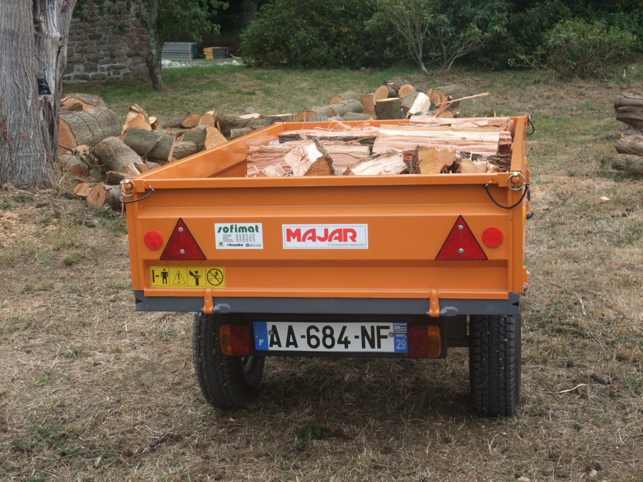

Here not only must the plate be lit, but all light signals from the towing vehicle must be repeated: red lights, brake light, turn signals. The whole thing generally goes under the trailer floor.

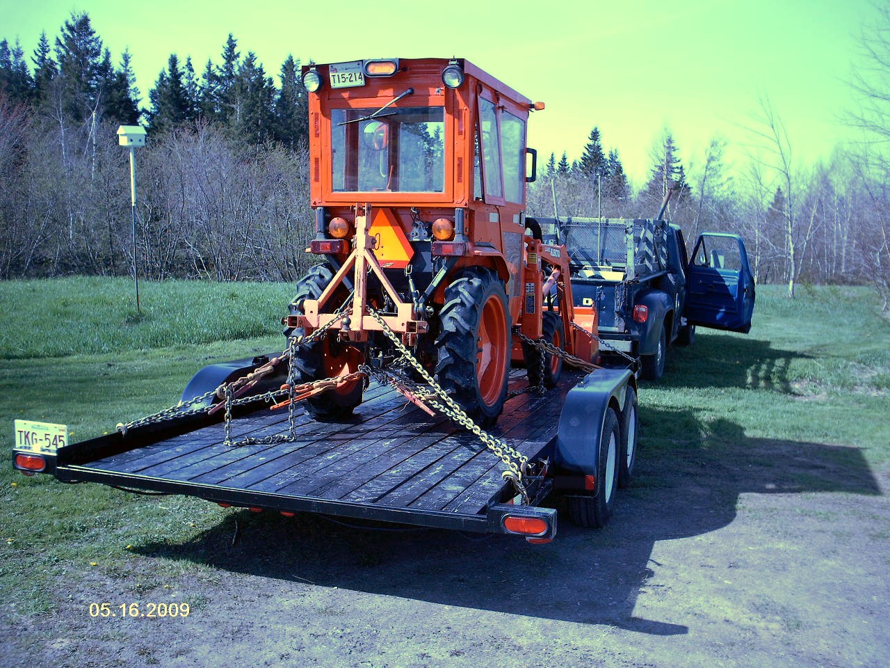

Here's how mine is mounted....on top of the tail light box and illuminated.

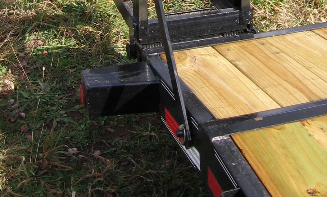

herringchoker, your tail lights are like mine. They are a welded on unit with the oval light held in with a grommet / gasket.
They are not bolted or screwed on like some.
That would be my only obstacle. The license plate brackets / holders that fit tail light bolt patterns.
On my lights I would have to drill holes to hold anything to it. Not saying I cannot do that.
Maybe on top like herringchoker's and a small clear light at the bottom?
Thanks again all for the ideas and input. I will look at various brackets on the web and see about getting one to work

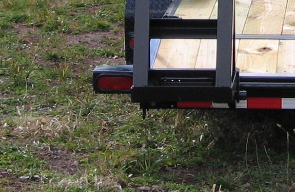

If the ramp is wide enough I can see it would be very easy to splice in a parking light wire from the taillight and rout to the tag for a light if once mounted it onto the ramp,;)
here is my tag mount
   / Where to mount license plate?
#20
Yeah, that was kind of what I was thinking.
The ramps are 16 inches wide so there should be room.
Then make a mount with a light (or buy a bracket with light to adhere to mount) to fit under the ramp. And for the wires, I would get the loom and run it from the tail light. I would have to leave slack for up and down and right and left movement of the ramp. Would be nice if i could get a coiled wire, like a phone handset cord, small enough to use that would keep the slack coiled up and weather tight.
