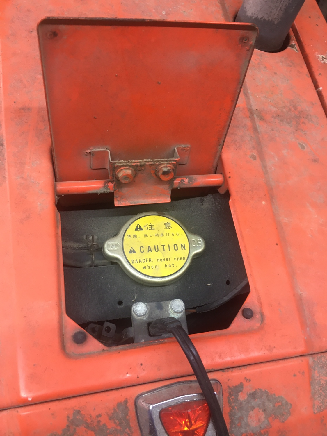

I placed my connector under the radiator cap door.
When I get on the tractor its quite visible that it is up.
Yes I have had to get off the tractor many times and unplug.

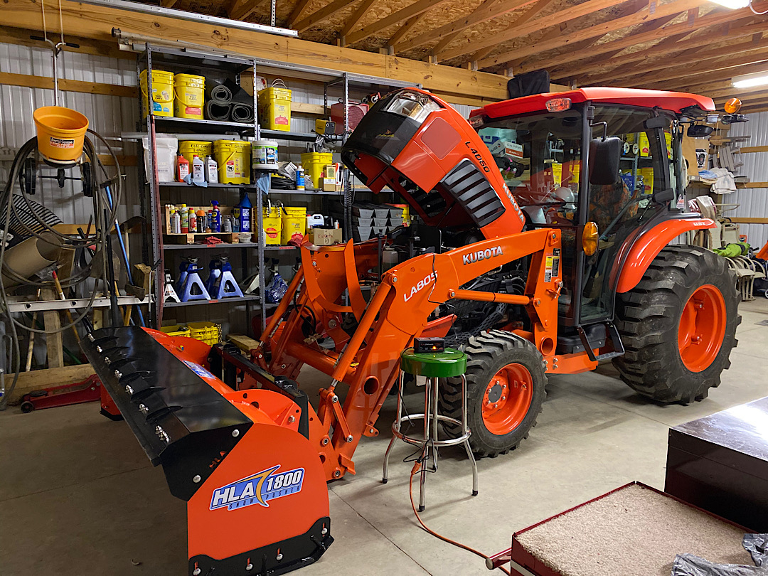

Just peaks out of drivers side cowl. I can maintain with hood open or closed. JD stool with maintainer on it and plugged in, always sits in front or near drivers door.

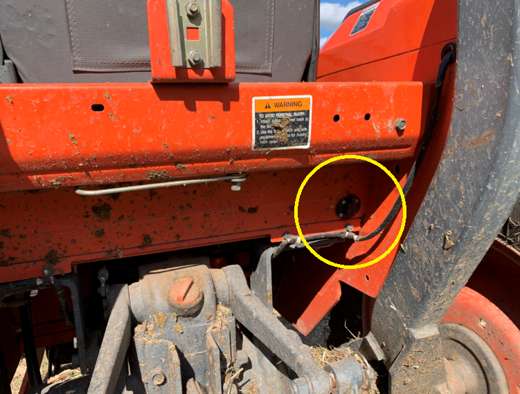

I purchased a weatherproof "SAE connector port" and installed it behind the seat. The wires run through an existing hole in the sheet metal under the seat, then navigates under the operator's station, connecting to the starter cable bolt.
My need was for an electric herbicide pump and tank that mounts on my 3 point. I guess if I have to use a battery charger/minder, I could set that unit on the seat to be sure I don't drive off with it connected.
