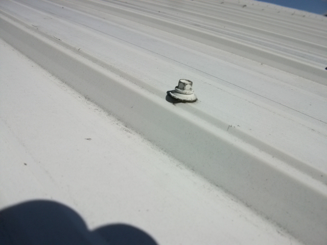

a hole with no screw or nail on the top of the rib will rarely if ever leak,
I completely disagree. A hole in a rib will leak just the same. My pole barn that is nailed in the ribs has a number of leaks. all from around nails in ribs.

I agree with those that follow the manufacturer's guidelines, however, a hole with no screw or nail on the top of the rib will rarely if ever leak, a hole in the flat will almost always leak.

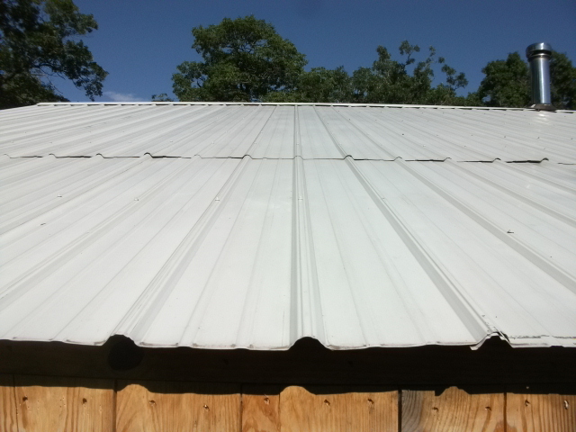

So we have a consensus, screws are better than nails. :thumbsup: Just to clarify my comments on fastening through the rib I have attached a few pics to make sure we are all talking about the same thing. Since I have had no failures in the 20 years I have been using this method I will stick to it. I do tend to use a minimum of fasteners when doing a roof as you may notice just to minimize the penetrations but I would fasten on the flat if I was doing siding. Bottom line is that if your roof don't leak you must have done something right, :D however you fastened it................
