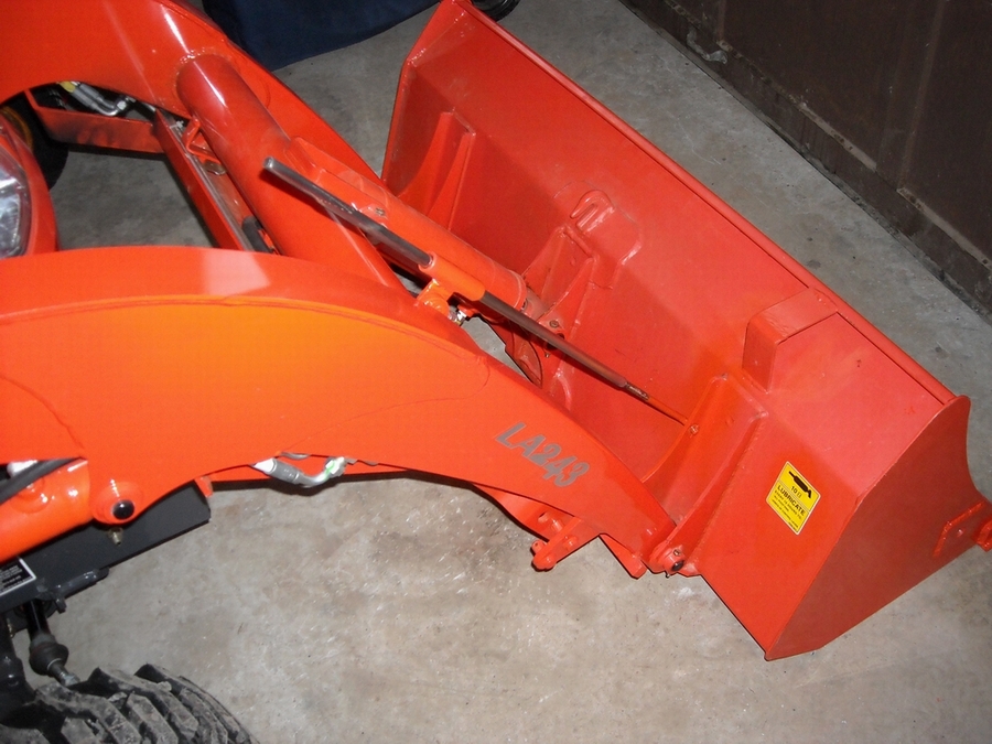

Depends on the size of the tractor and how much weight the bucket will lift.
A powerful loader can bend the top of the bucket with the chain but my little toy will stop lifting long before and bending of the bucket.
Here is a photo of my rig and I am happy with the one hook and where it is placed. Note that I only have a single bucket piston. If I had two pistons then I would want one above each piston.

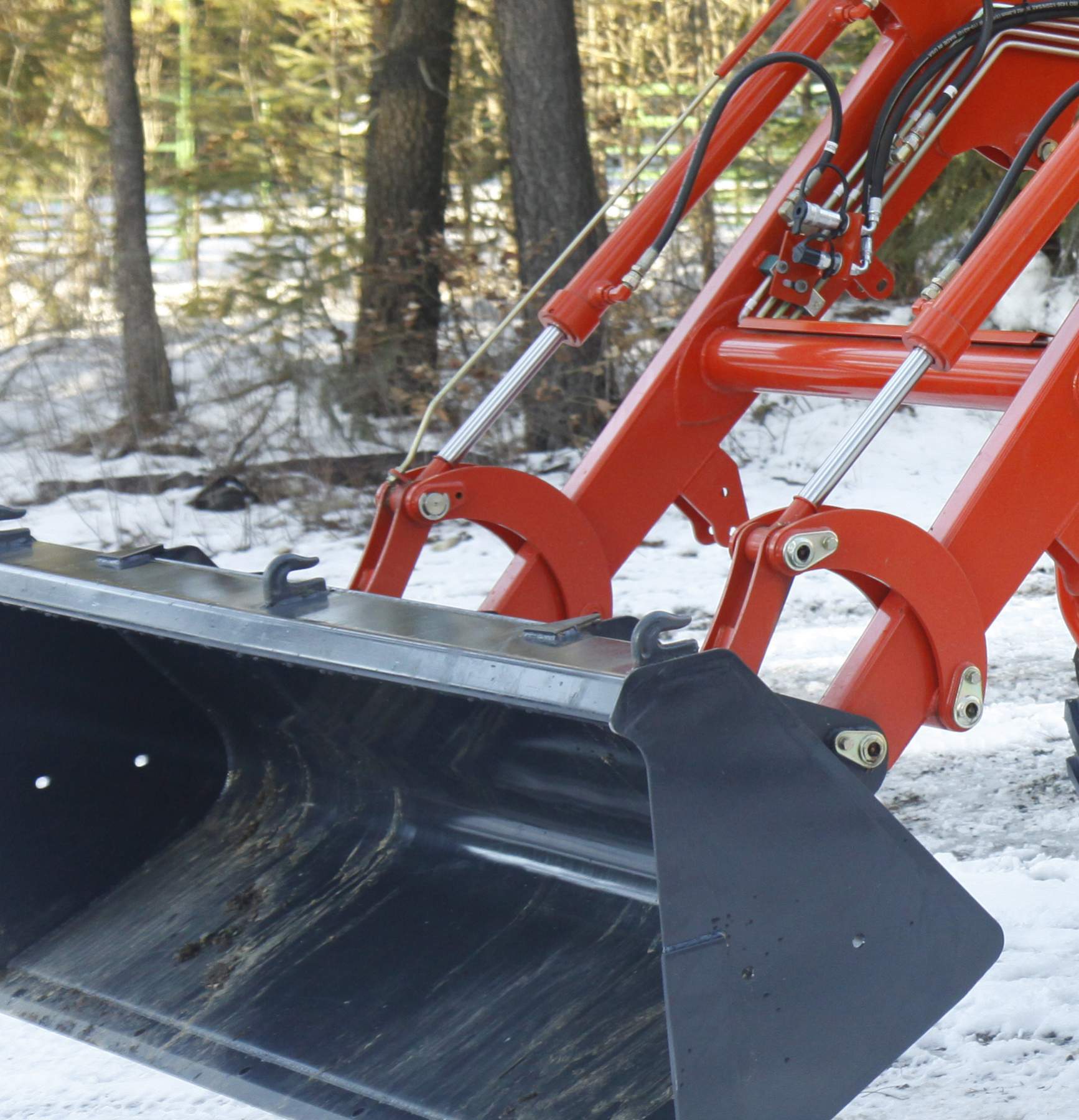

on my 6 foot bucket i welded 3, on my older 5 foot bucket i welded 2. the Kioti bucket has a nice place already set up for hooks. im not sure how yours is set up. you may or may not need an added plate, depends on what the bucket looks like. always size the hook to the chain. i use 3/8" logging chains, so have 3/8 opening hook.
