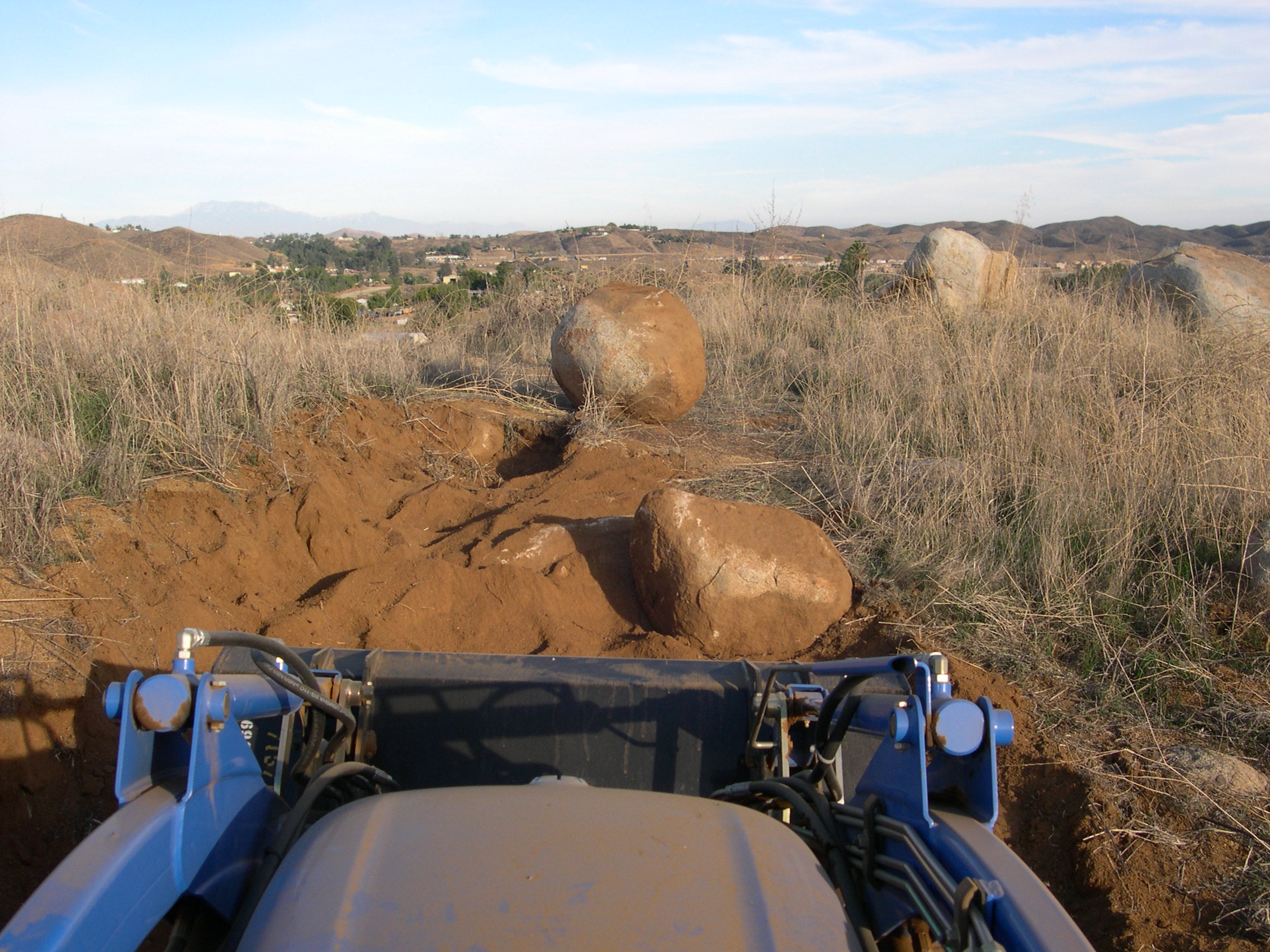

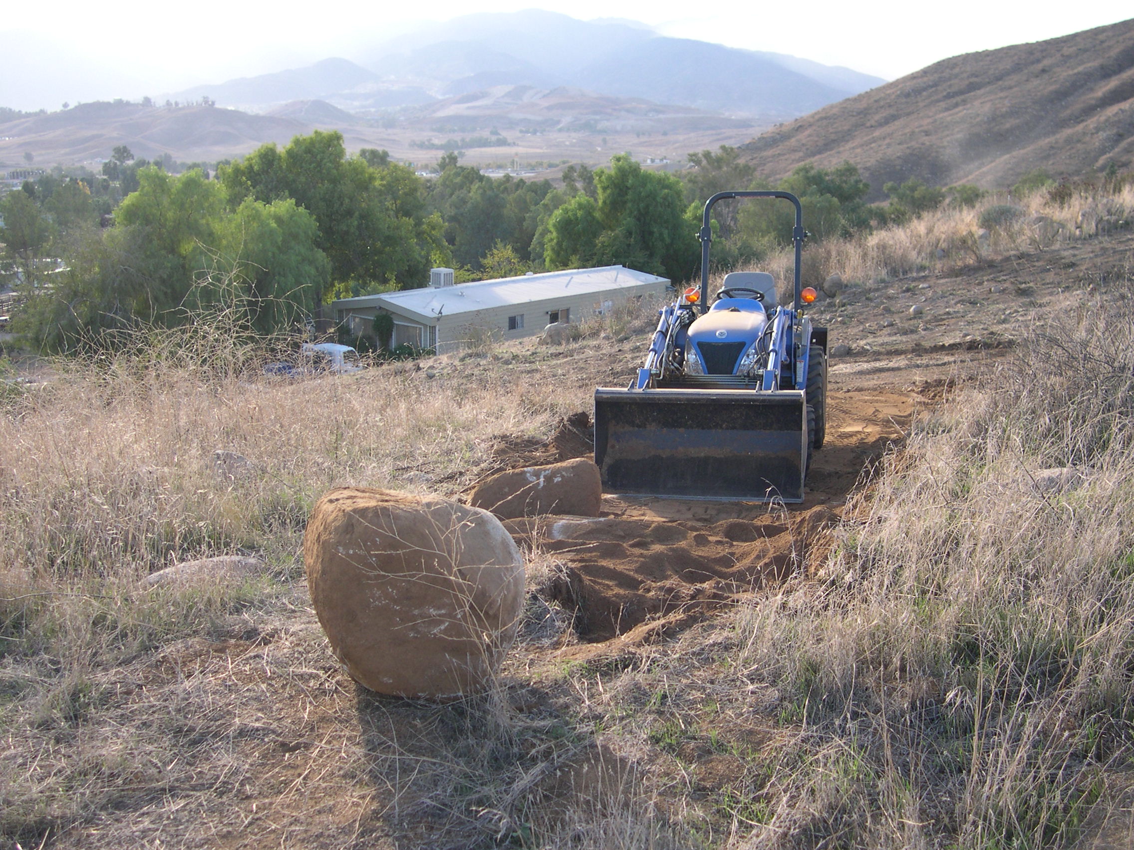

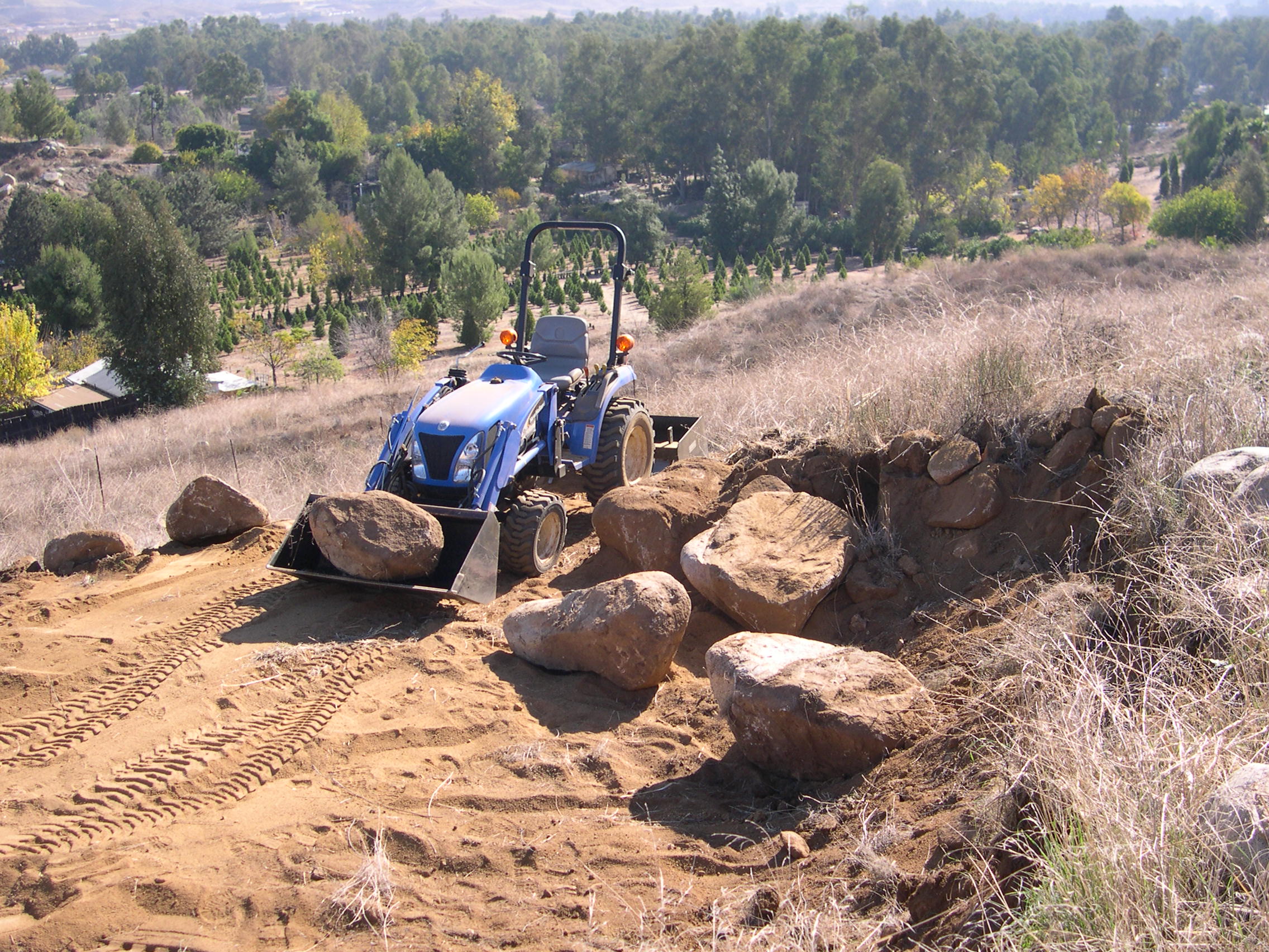

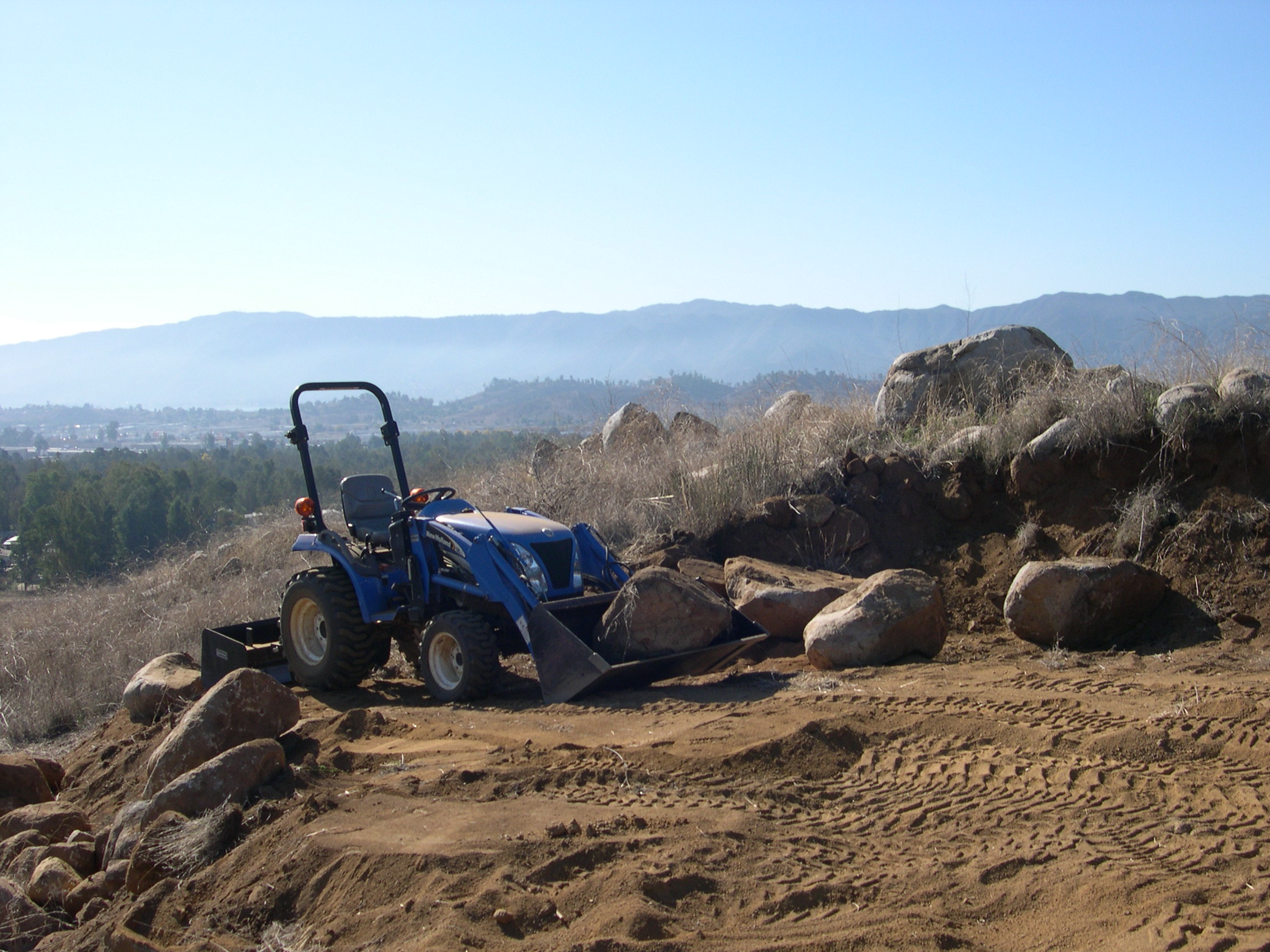

It is amazing what you can do with a little tractor once you get the hang of it. I had a New Holland TC24da on 2.5 acres of rocks and had fun digging them out and pushing them around if I could not carry them in the bucket. I am now on more land and moved up to a TC40da. Attatched are some pictures of the work I did with the TC24.
Brian
