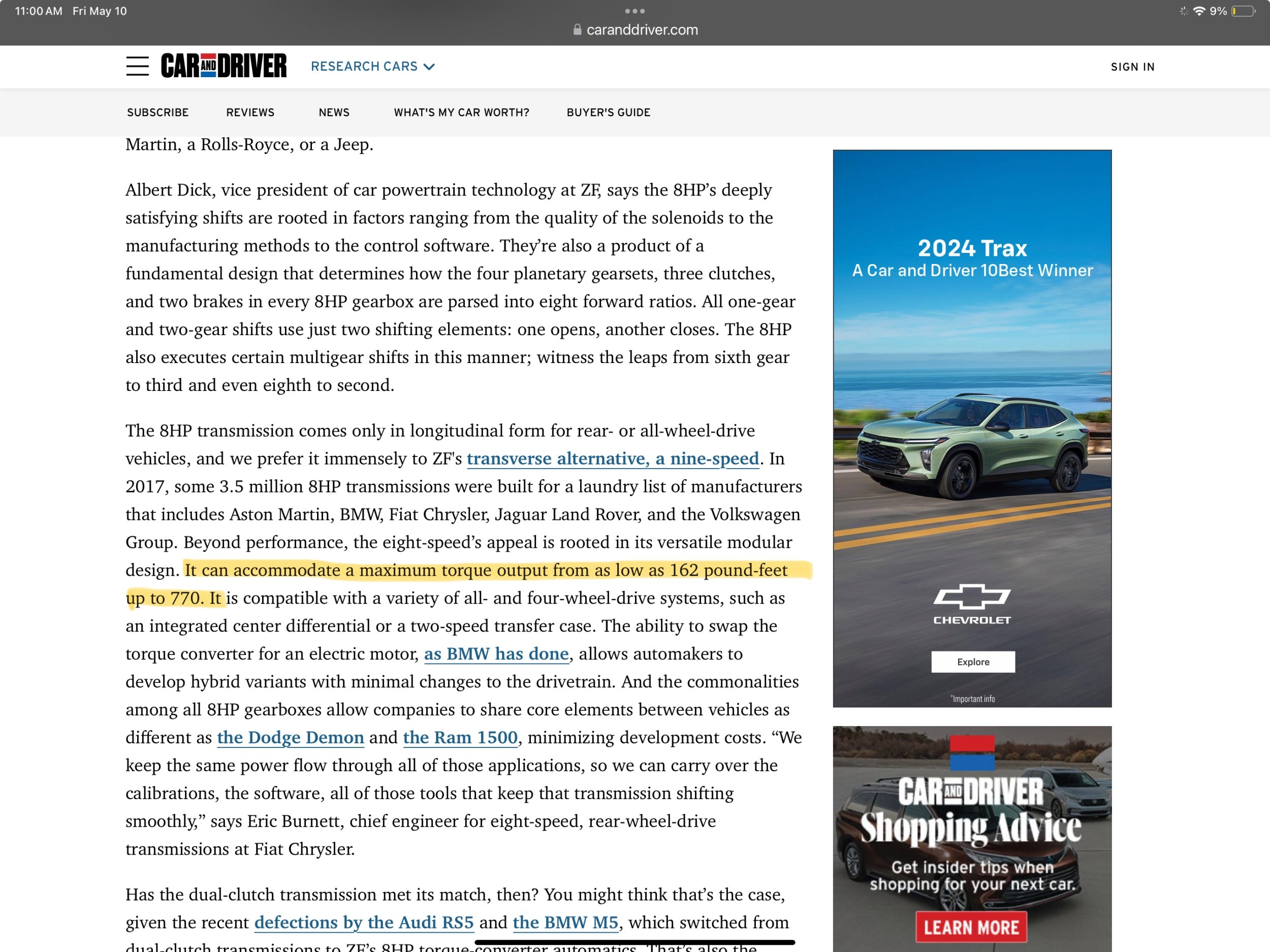

I didn’t say the ZF8 can’t do it, but they need to harden the transmission to hold more. The “powerline” looks like it might be the ticket. If the column shifter goes away and the service interval increases that would be awesome.
I nerd-out over transmissions from owning tractors. To me, the transmission might be as important as the engine. The ZF-8 would get me to the dealership.
Would be wild to own 3 vehicles with ZF 8's lol
