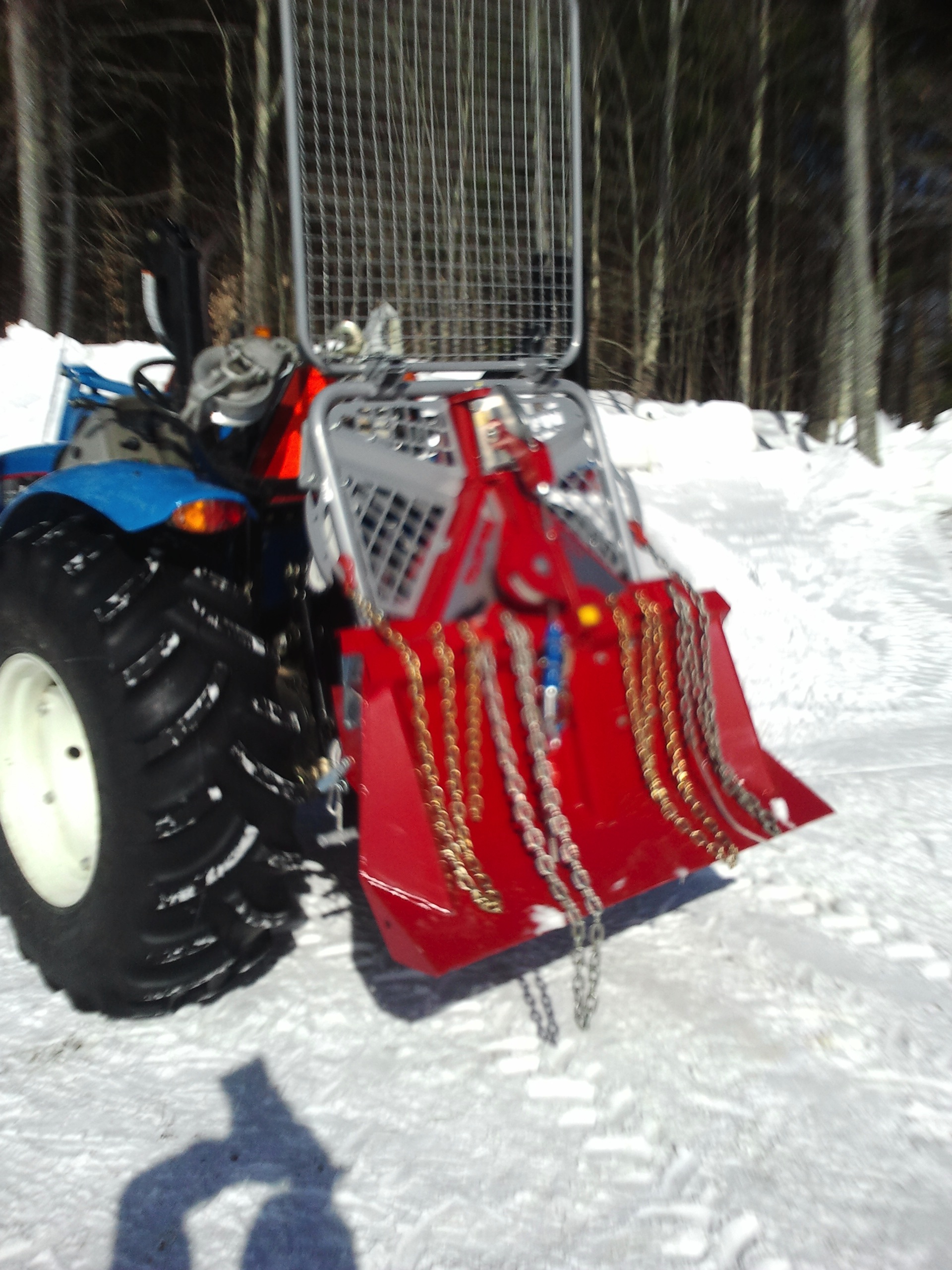

Well, I just sold my old Fransgard v-2600. Put it on craigslist at about 8 this morning and had it loaded on the buyer's truck by 1:30. Maybe I sold it too cheap.
Now I need to scramble around and find myself a new winch. Was all set to get another Fransgard (V-5000), but went instead and looked at the Tajfun's and was impressed. 45A sounds like it will fit the tractor nicely. The dealer also is a manufacturer of grapples and will give me a decent deal on a package.

Winch got delivered the other day. Haven't got a chance to use it yet because the snow is about 3' deep in the woods, but I think I'm going to like it.
Image.jpg Sorry for the blurry phone photo. Came with three chokers too!

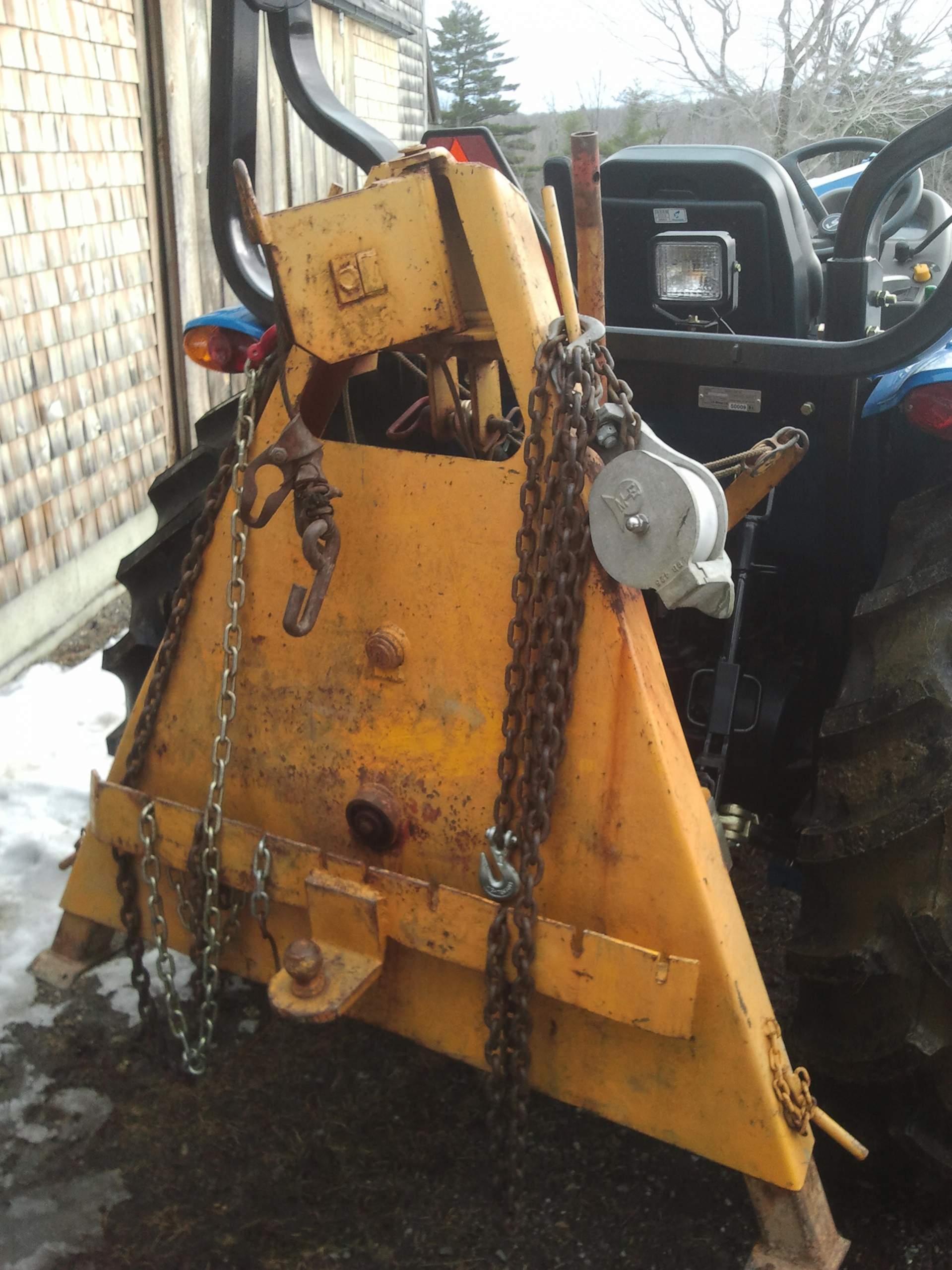

She replaces this old quill:Image 1.jpg

Very nice, now you need to wait for the snow to melt down:eek: to go play!
