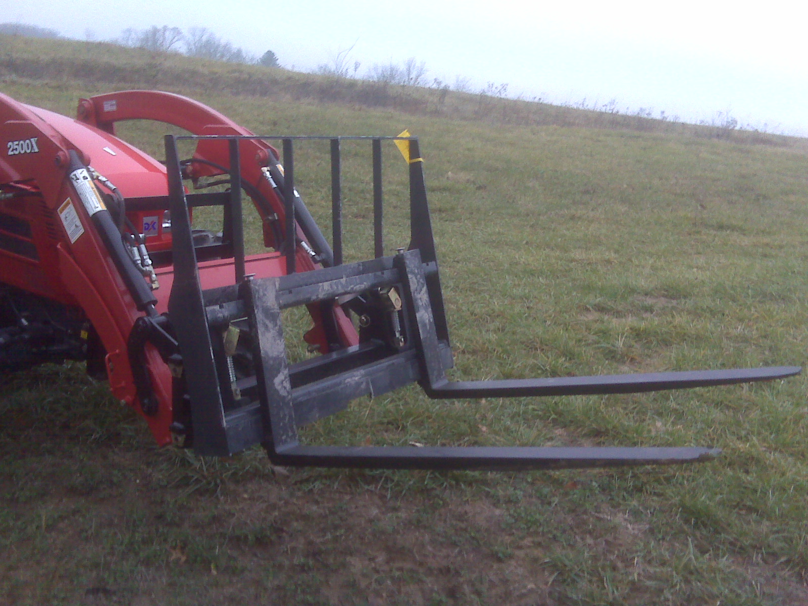

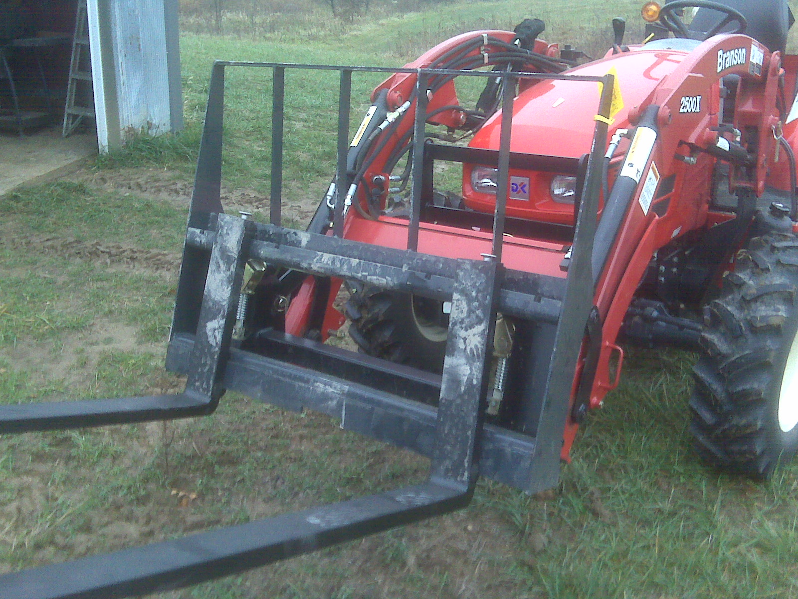

Definitely a set of forks. I use mine almost more than I use the bucket now. They can kind of do the same work as a grapple, but not as efficiently. Still much better than just a bucket for moving logs and brush though. I also use mine for moving round bales, lumber and building materials, fence posts, put a platform on it for a mobile scaffolding and so forth.

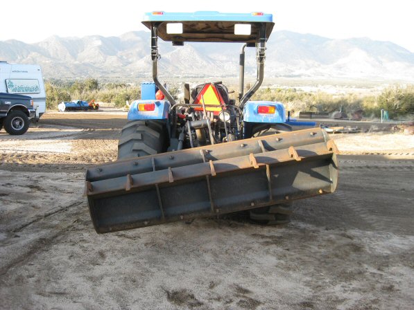

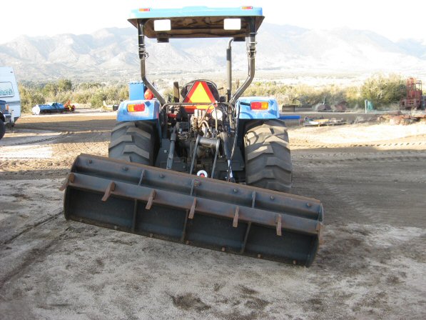

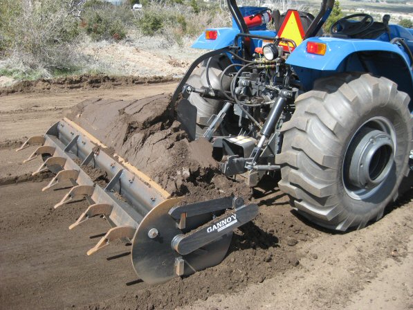

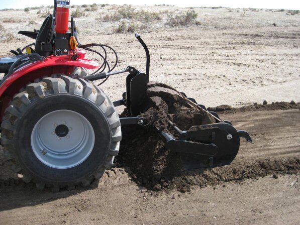

Trust me when I say that since you have a roll over box blade, you will have far more use for a hydraulic side link than the top link. RO boxs do not get used in the same manor as the std type BB. There is no need to be constantly changing the pitch of the box with a roll over.
As far as the "TnT" cost for your tractor, I would recommend a set built with 2 1/2" dia cylinders, with 1 1/2" dia rods for your size tractor. Hoses with QD ends and hydraulic flow restrictors. This cost would be $575 + shipping. PM me your zip and I can get an accurate shipping price for you.
Here are a few pics and as you can see, I like the roll overs enough to have 2 of them. :thumbsup: :thumbsup:

I bought a set of clamp-on forks from fleaBay for about $160 with free shipping. I wasn't expecting much, but they are great. Extremely heavy and well-built. The only draw-back with clamp-on forks is that the load on the forks is 2-3 feet farther forward than with dedicated forks, because of the depth of the bucket. With very heavy pallets, you can exceed the tipping weight. For casual use of 1000 lbs or less, they are well-worth the money.
   / Which attachment would you buy? #18
For me it's no contest.... The pallet forks are the big winner.....
I have the clamp-on style and they are good but the qucktach are great... They put the load closer to the pivot point and increase your load capacity....

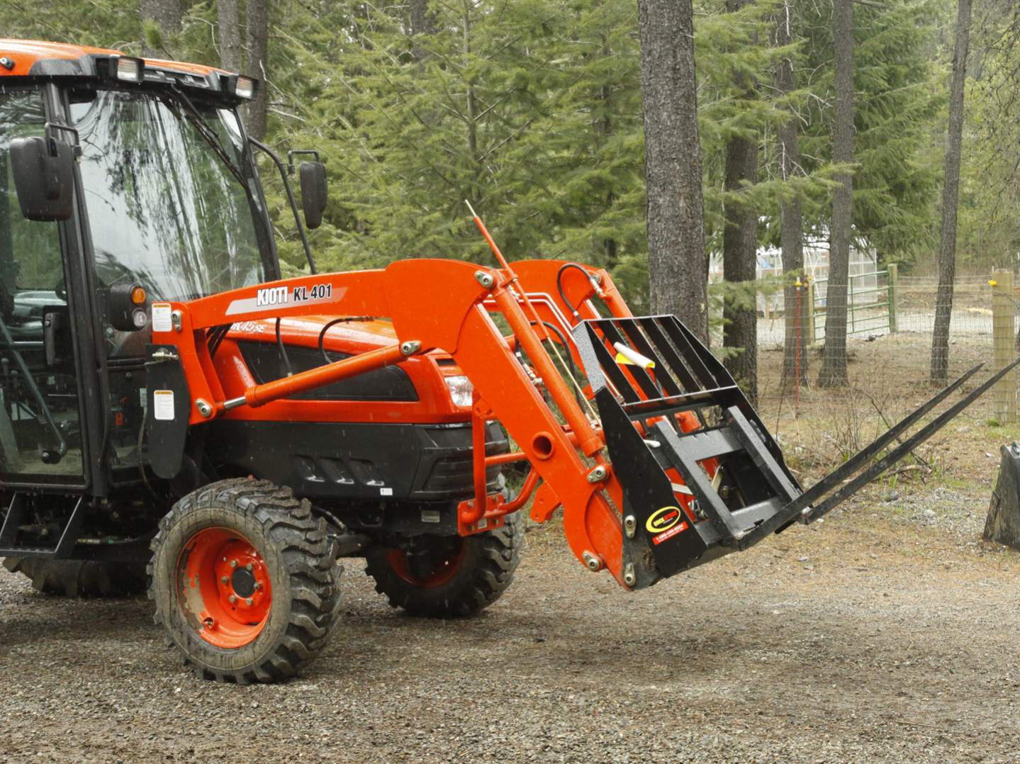

I bought QA forks this year anticipating moving palleted materials and gatering firewood tops. The bucket is not much good for logs, and I'd rather process the wood near the furnace instead of in the woods. And a 72" bucket can realistically only hold a max of 1/4 cord.
I recently had to lay a drain tile in my driveway, and not having a hoe, I used the forks. The tricky part is that when you center them, they can pop off the frame. But once you break through, you can put the guard back on and dig a 14" ditch quite easily.
Hard for me to advise, since I have forks, but not TnT. Does anyone make a root grapple that goes on the pallet forks? If not, they should, that would be very cool!
If I were you, and I'm not, I'd spend the cash on the Tnt:D

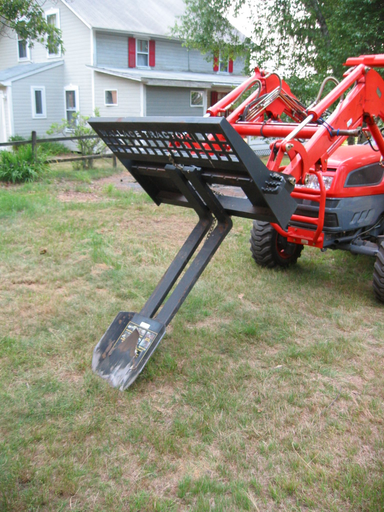

It is possible to mount a grapple arm on a set of pallet forks. Would be pretty handy if you are using forks to carry big logs around but wouldn't make a fork grapple into a brush chomping rig like a standard root grapple.
