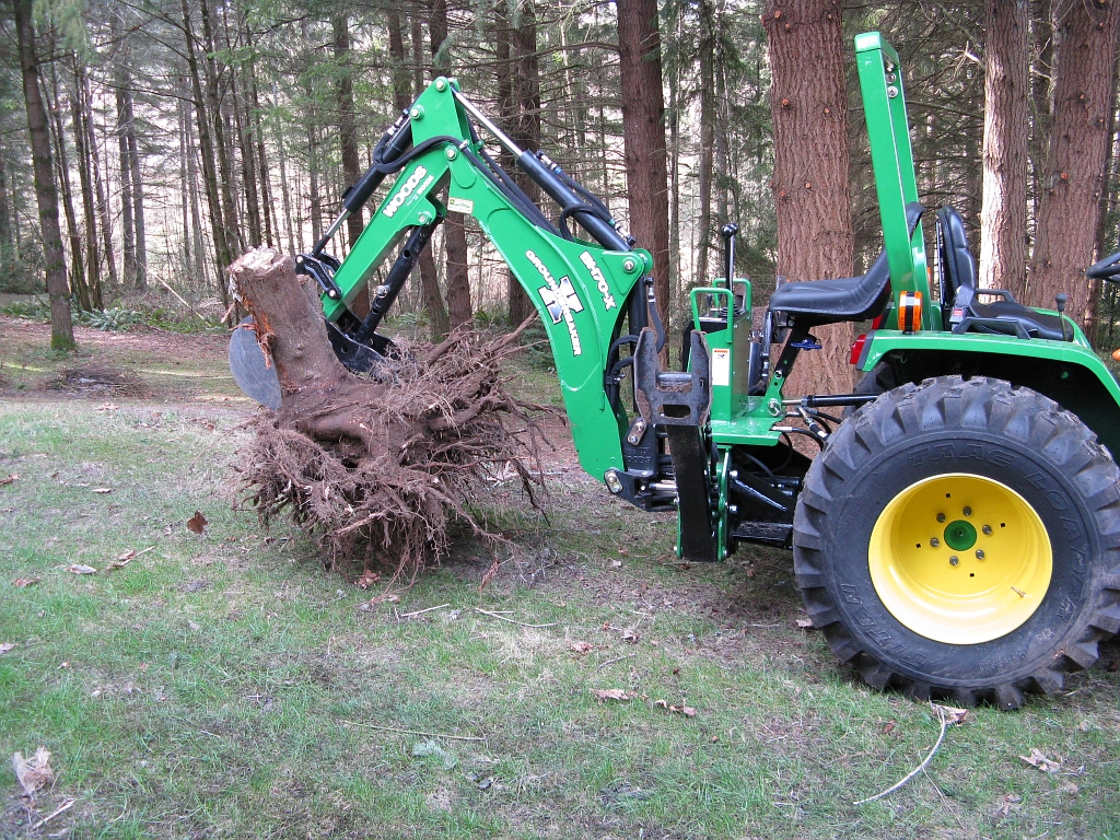

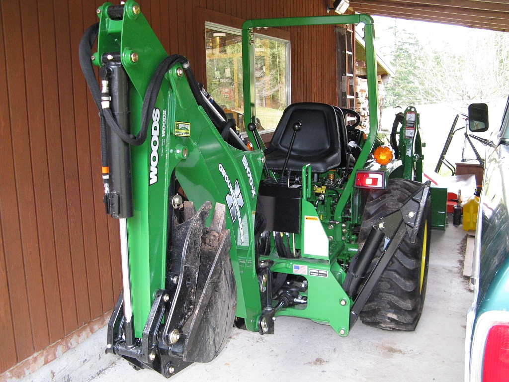

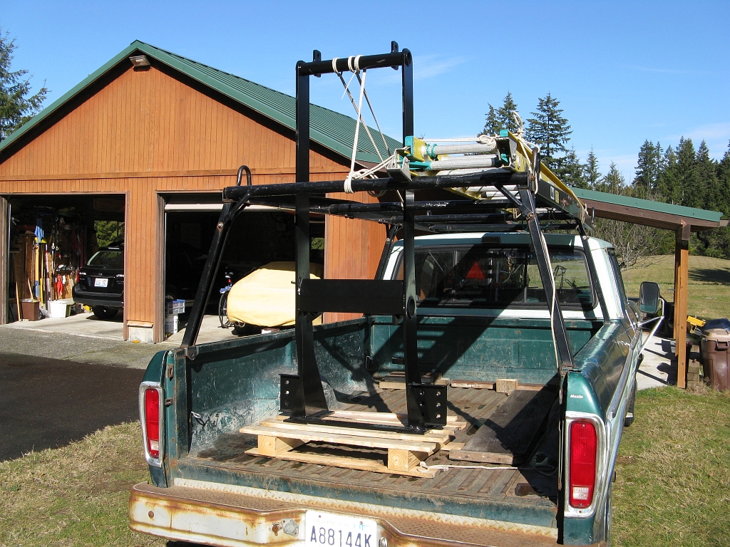

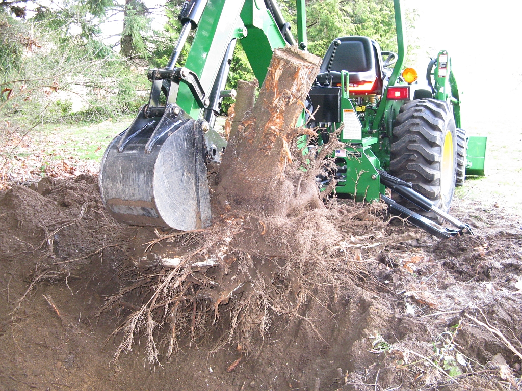

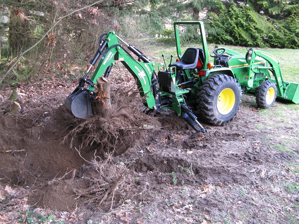

/ Which Backhoe for 790? #6
I have the Woods Bx-70. My JD dealer recommended it over the JD hoe. It's more beefy than the JD and the big selling point is its thumb. That makes all the difference in the world with digging out stumps and ripping out brush. It has a full frame for the 790 and can be quickly disconnected. I put mine on dollies when off to make it easy to move around.
It's very easy to install the power beyond and the sub-frame. I did it all myself without any help.
See my pictures...

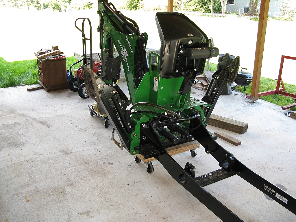

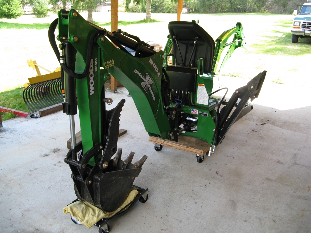

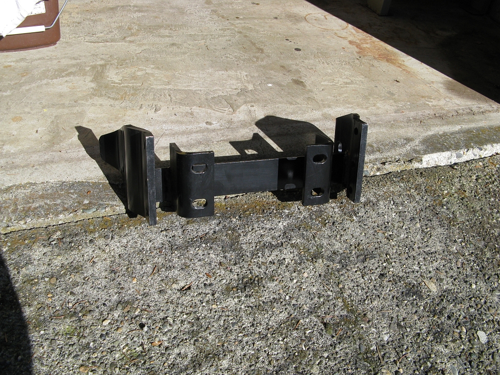

/ Which Backhoe for 790? #7
Here are some pictures of the BH-70X 790 sub-frame and the hoe dismounted.
