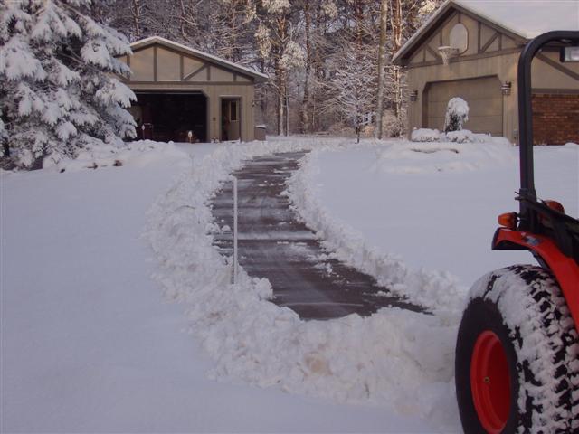

   / Which blade for B3030? #6
I got a 5 foot when I bought my B3030. After the first few times of using for plowing snow I traded it back to my dealer for a 6 footer. The 5 footer does not push the snow out past the tires far enough as others have said. I have loaded rear turf tires and it does great in the snow as long as 4WD is engaged. You will like it.
