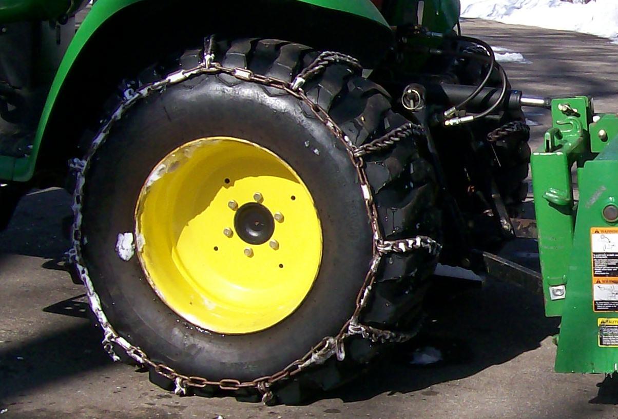

   / Which Chains are best for R4 tires? #5
What surface are you running on? 2-Link chains, nice and tight work just fine on R4's, if you have asphalt or concrete you want to stay away from the v-bars as they will ruin it.
I had these VERY tight as recomended by the chain dealer. I've since loosened them a bit based on suggestions from the good folks on this board. They stay out from between the lugs a little better but if I had it to do over again I'd have gotten Duo grips.

flowerfarmer, thanks for your photo - it looks like you had EXACTLY the problem I was worried about, and the chains in your photo look just like the ones that my dealer mistakenly ordered for me from WALCO here in Ontario. (Good thing I didn't take them!)
Can't you put 2 X 2 links between each ladder and make your own Duo Grip?
