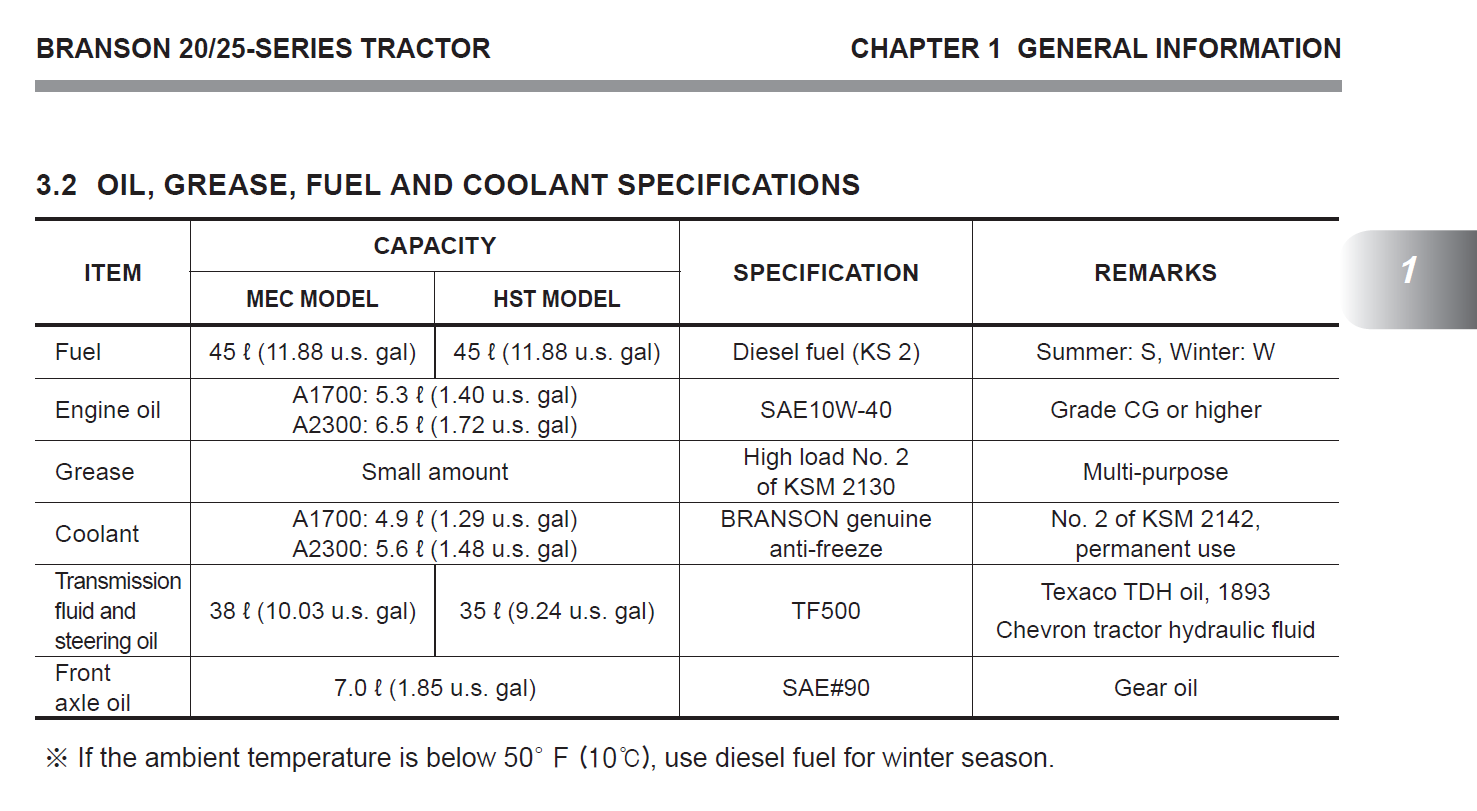

Here is a picture from the 20/25 series Branson service manual. Hope it helps.

Thanks again. I continue to research and the KSM standard appears to be the European equivalent of ATSM.
I’m not finding an American option for KSM 2142, so I went to the Cummins website and looked at their recommendations. They suggest Fleetguard products.
https://www.cumminsfiltration.com/sites/default/files/LT36237.compressed_0.pdf
I’ll keep searching, but I can’t help but wonder how old my manual is to have an ATSM listed coolant.
