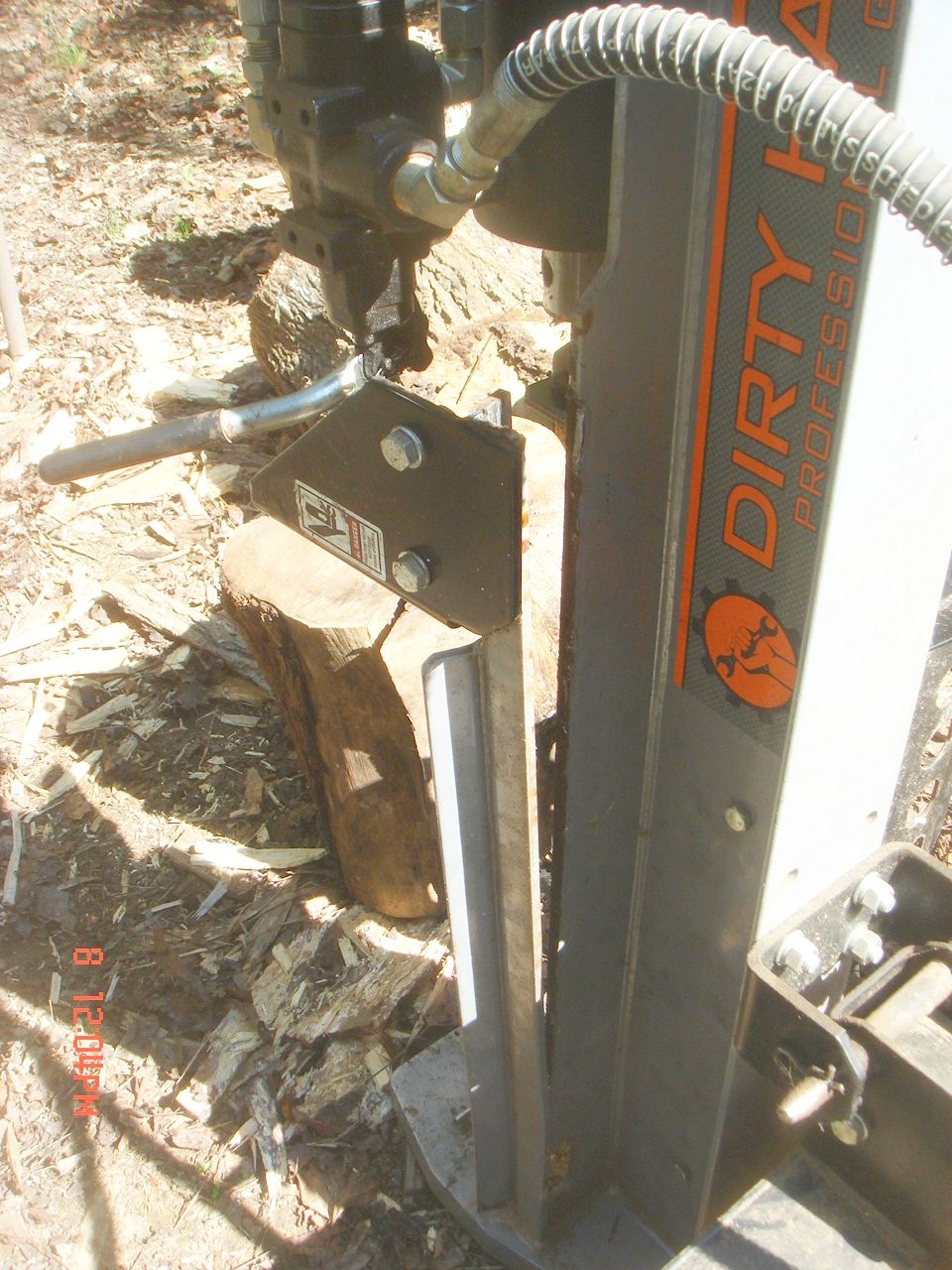

OK, the reason Dirty Hands Brand is no longer literally 'popped up' this morning when the entire weld (24 =/- inches) let go all at once. Based upon the condition of the parts the weld was never done properly and there was no evidence of PENETRATION along the length of the break!
So, I have to dismantle this thing to convey the six-foot beam part to the welding shop and I can't begin to lift the cylinder much less the beam. I have no winch, chain hoist, etc. just my B7800 Kubota with a BOOM (let's hope not) POLE and FEL.
However that's not what I need to know. I may have no choice but to disconnect the cylinder from the two hydraulic hoses attached to the Control Valve body. See pictures. Which part do I try to UNSCREW (for lack of a better term)? A or B
Then, what to expect in terms of fluid discharge? Torrent, flood, a little, a pint?
Then, what to do with the loose open ended hoses? (to keep from contaminating the rest of teh system, etc.
Thanks

B is a swivel fitting, so you hold A with a wrench and spin B with the other wrench.
It will leak a little bit of fluid out. Not an huge amount but it's oil, it doesn't take much to make a mess.

I managed to dismantle the thing wo needing to disconnect the hydraulic hoses. Putting it back after the welding is done - well, knowing which fitting to turn on may prove essential! Thanks for the succinct feedback. Much appreciated. I'll try not to make a mess :)

A trick: put a shop vac in the hydraulic fill hole (not deep enough to touch the fluid 😀 ), and turn it on. When you open a line, it will suck air through and keep the fluid from dripping everywhere.
OK, I got the thing back together and split a large log into little pieces and, then checked the leaking fitting - it was leaking, of course.
I got a wrench and prepared to apply all my aging muscle to torque that fitting tight.
When I applied pressure to fitting C, it was loose and I started tightening up. One turn round, two turns round, then three an four before my wife shouted "hey the hose is kinking" - and she was right.
Apparently, the 'swivel fitting' wasn't swiveling like my sister Kate. Rather it wasn't budging at all. So, Do I apply a wrench to B turning it as I tighten the fitting on the pump body C ? https://www.tractorbynet.com/forums/attachments/241007-splitter-split-3-jpg.1471292/
Turning A & B in unison (and direction) with the turns necessary to tighten C.
That worked! Putting a wrench to the 'swivel fitting' A and not the hose fitting B did not work - it loosened the connection between A & B!
Regardless, all is tight now and the leak appears to have been corrected.
