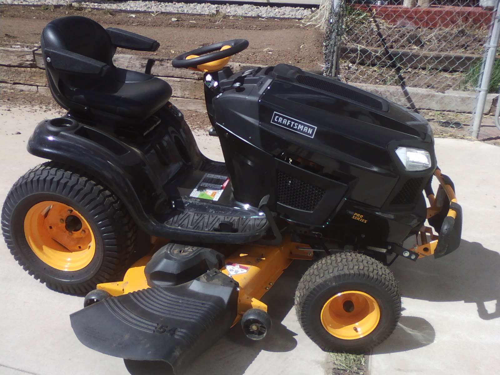

Here is a picture of my new Mowing Machine. :D :cool2::D :thumbsup:
