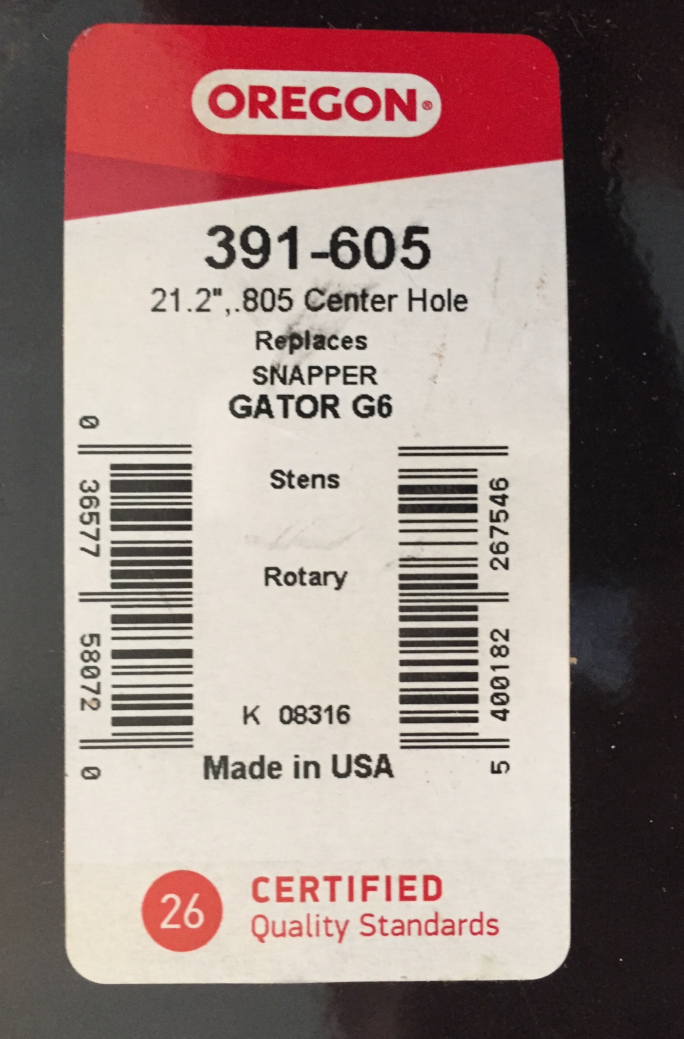

Sorry to bump my old thread, but I finally found the time to research Gator blades for my mower deck. (Accel Deep 42A)
The standard blades that came with the deck are 21-1/4" long, with a .808" hole size, as best as I can measure with my dial caliper.
The blades that came with the mulch control kit are 21-5/16" long; same hole size.
I found Gator G6 part # 391-605, which lists as 21.2" long (close to 21-3/16"), .805" hole size. Photo of blade label attached below.
The offset from the blade mounting surface to the cutting edge measures close to 5/8" on both the Gator blades & Deere mulch blades.
So the Gator blades are about 1/8" shorter than the Deere mulch blades, which I wouldn't expect to make much of a difference; I think I have a pretty good match here. I'm going to install these in the next day or so & see how they do compared to the Deere mulching blades, which I haven't been completely happy with. (Grass clumps, etc., left on the lawn) I'll report on my experience after the next mowing.
For anyone interested, I ordered the Gator blades from Forest Depot as suggested by sennister above; about $15 each. Their site says these blades are being discontinued by the manufacturer, but Oregon's site makes no mention of this. If I see good results from these, I'll order another set or 2 just in case they are in fact being discontinued.
I also noted that these blades are much thicker (& heavier) than the Deere blades. I suspect that they may result in more wear to the clutch when engaging the blades. Time will tell, I guess.
(EDIT: I don't know how I got the .797 hole measurement on the old blade in my earlier post above. I checked the .808 in this post several times, so I'm sure that's closer to the truth.)

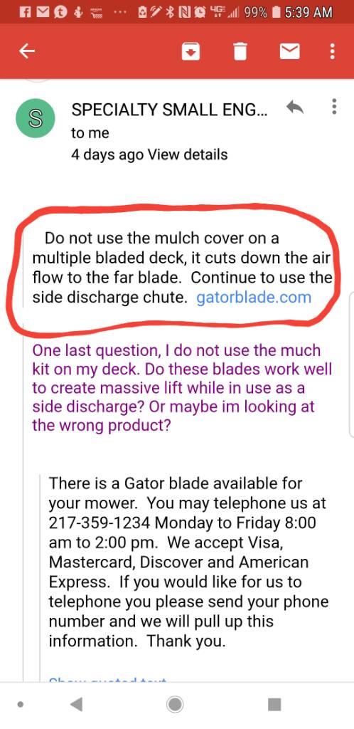

The gator blades I bought for one of my mowers said NOT to use them with a mulch kit. I do it anyways and haven't had a problem.

I was going to say it.... but since you did, I will call you up. I emailed back and forth with them about blades for my XT3 GSX that does not have any upwards suction. I explained that I side discharge and they responded that side discharge is what I need to do with their blades.
Straight from the horses mouth...

Thanks for the comments regarding engaging the blades at a lower engine speed; hadn't thought about that, but it makes sense that it would be easier on the clutch. I found today that engaging at idle will stall the engine, but a small increase in throttle works fine.
I got these blades installed today & mowed a small section of grass as a test. So far, they're a big improvement over either the original JD blades or the blades that came with the JD Mulch Control Kit. No clumps or rows of clippings whatsoever.
The section I mowed today was with the mulch door closed. I'll try it both ways tomorrow when I mow the rest of the lawn & see what happens.

I got around to mowing the front with the new blades today, & did a bit of experimenting. The grass was a little taller than I should let it get between mowing, so IMO, it was a good test opportunity.
I started with the mulch control door closed, & found that with the new Gator blades I had much less evidence of grass clumps & rows of clippings as I drove around. Huge improvement as compared to either the original JD blades or those that came with the mulch control kit.
After a few times around, I opened the mulch kit door & let the clippings blow out, as suggested above. This mode appeared to result in far less evidence of clumping or rows of clippings. However, as my path around the yard got smaller & smaller, the clippings began to pile up in the middle significantly, and at the end I had to drive back & forth over the last area to shred & spread the piled up clippings.
I suspect that if I were to go counterclockwise around my yard, with the mulch door open & blowing the clippings out onto the already-mowed area, I might end up with a cleaner result. I will by all means try this when I mow again.
Sorry to continue to be long-winded about my choice of mower blades, but being old & retired, such things have become a much larger part of my life than in the past. :laughing:
