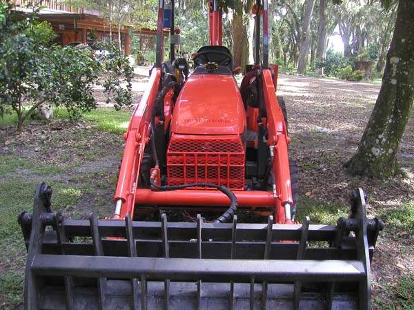

I've got the 66" standard duty ANBO root grapple on our L-39, it weighs about 850 pounds and has 1/2" steel rakes, most of the frame is 3/8". It is plenty heavy duty and the hydraulic cylinders are massive with 1/2" hydraulic lines.
I would get the heavy duty one myself, if your FEL can handle the load, just get a short one, you don't need one 72" wide, I think even a 48" wide one would be plenty adequate in 98% of operations.

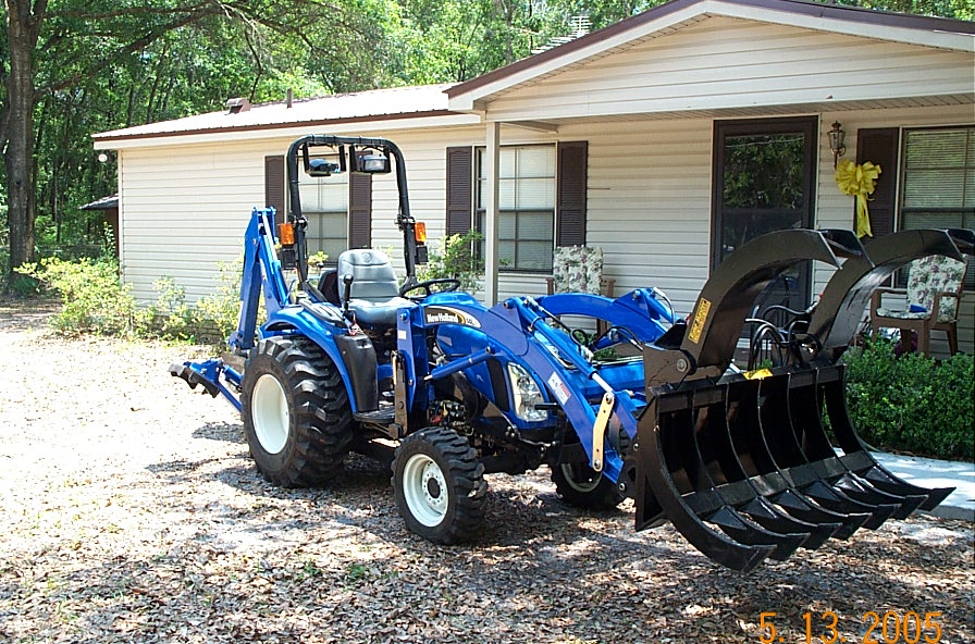

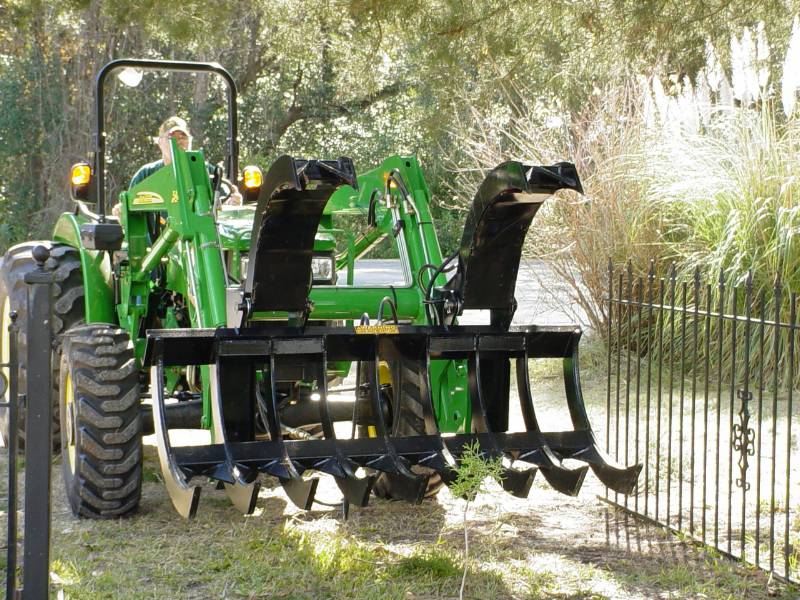

Here's a another I would highly recommend. RakeMaster - The Most Versatile Clean-Up Rake
I've attached some photos of my 5' one on my TC33da HST. Love it and it's tuff. Also thru in one of the guy who builds the rakes with his JD and I think this is a 6' on it.
