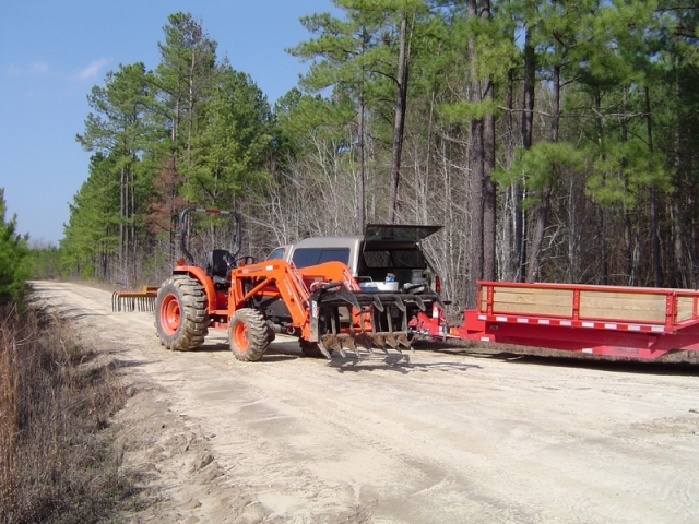

I have an L3830 and have a WRLong RBG2 in the 60 inch width. It is the lighter of the grapples and weighs around 365 pounds. For you, the light Markham is what I would get. I am happy with mine. I welded some extra cross members along the back, where it was more open. When using one around stumps, go slow...so when you snag a stump by mistake you don't bend teeth, etc. Great tool to clean up clearcuts and remove roots and stuff in the soil. Allows the soil to drop out and the debris to be collected. I would also think about getting a landscape rake in the 7 foot size to go on the back... Markham...good value for the money.
