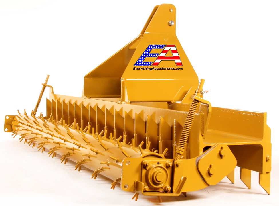

For the final grade, our EA Pulverizer, as linked by teg, is a great tool for the job unless you want to fork out $6k plus on a Harley Rake!

   / Which Implement for final grading of new home. #22
Rent a Harley rake. It'll do everything you want except set the grade lines
:thumbsup: I agree. A Harley Rake is a pretty amazing tool for prepping a seed bed.

Pulverize, box blade, and tiller seems like a lot of overlap in implements.
   / Which Implement for final grading of new home. #26
I agree that seeding in the fall is best, even planting cedar hedges. it's been suggested to use your front bucket,, have you tried this? I personally would give that a shot ( in reverse of course ), you could slightly tilt your bucket forward and use a little down pressure to get the grade your looking for, then straighten your bucket flat and use "float" to get that smoother grade. look at all the fun you'll have:) I would try a section and see how it goes. Either way, good luck.;)
   / Which Implement for final grading of new home. #27
Please share your opinion, here's mine.
tiller = loosen dirt, break up grass clumps
box blade = move soil to establish grade
pulverizer = firm up and prep seed bed.​
If one has a drag harrow or another method to level the soil surface the pulverizer could be eliminated or replaced with another implement.
