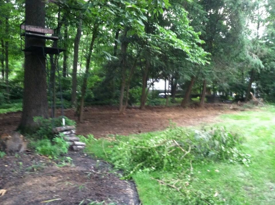

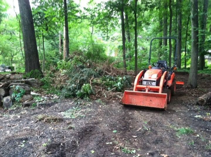

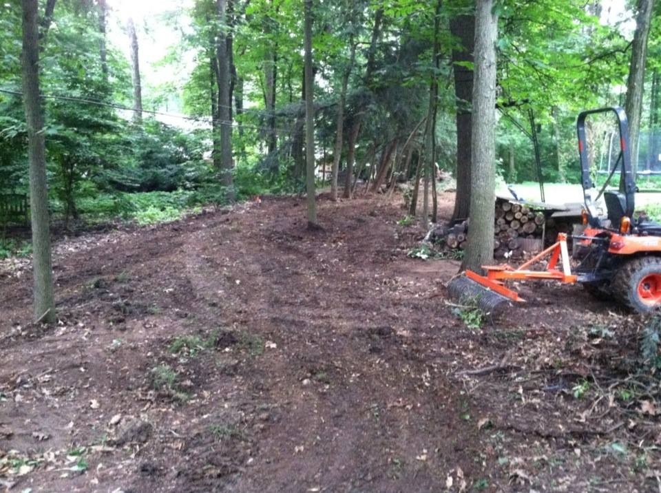

Below are three photos I took on the job earlier in 2013. I was impressed with the rake's ability to get the sticks, leaves, and minor plant growth. The setting that seemed to work best if I recall proper was the rake set perpendicular to tractor travel and 3-point hitch set on float to flow with the uneven ground.

Looks like the rake did a good job.
