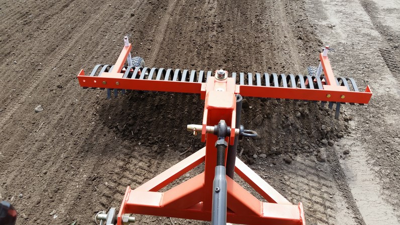

I have a landscaping project coming up next year on my property. I will be landscaping my front and back yard. While not overly huge, it is a desent size. my property is 1.5 acres and a good portion is going to be grass. The area is level for the most part but it needs a bit of work to remove some high spots and fill some low spots, as well as grading it for better drainage. The soil that the grass (wild grass and stuff) is growing in is mostly sandy fill that I put down several years back to bring the yard up some and the grass just grew in. It will have to be killed off, rototilled, or removed. I realy dont want to remove it because that would mean I would have to bring in a bunch more fill to keep the yard at its current elevation. Would I be able to rorotill it instead and mulch up the grass and then level it. I will have to put down a layer of black dirt before I plant the new grass. I will be using my Kubota L2501 with the LA525 loader for the project and I am wondering if there is an impliment I could use to help make things easier for this project, or would loader suffice. I would like to hear some opinions on what implement would be best for a project like this. Thanks

First, have your soil tested. The soil test will tell you if soil pH needs to be adjusted and what nutrients and micro-nutrients are required FOR THE SPECIFIC TYPE OF TURF you wish to grow. I speculate your yard will require lime to decrease soil acidity. I am not familiar with Canadian turf but in USA most turf grass grows well in "sweet" soil rather than acid soil conditions.
Kill all unwanted grass strains with Glycophosphate/Roundup ten days to two weeks before commencing soil prep.
If you own or can rent a PTO powered roto-tiller it would be a good implement for mixing and leveling the soil. Roto-tiller will also mix in nutrients recommended in the soil test. If the soil moisture is optimal you may be able to smooth roto-tilled, friable, soil with your FEL bucket. Undoubtedly, some manual raking and rock picking will be necessary.

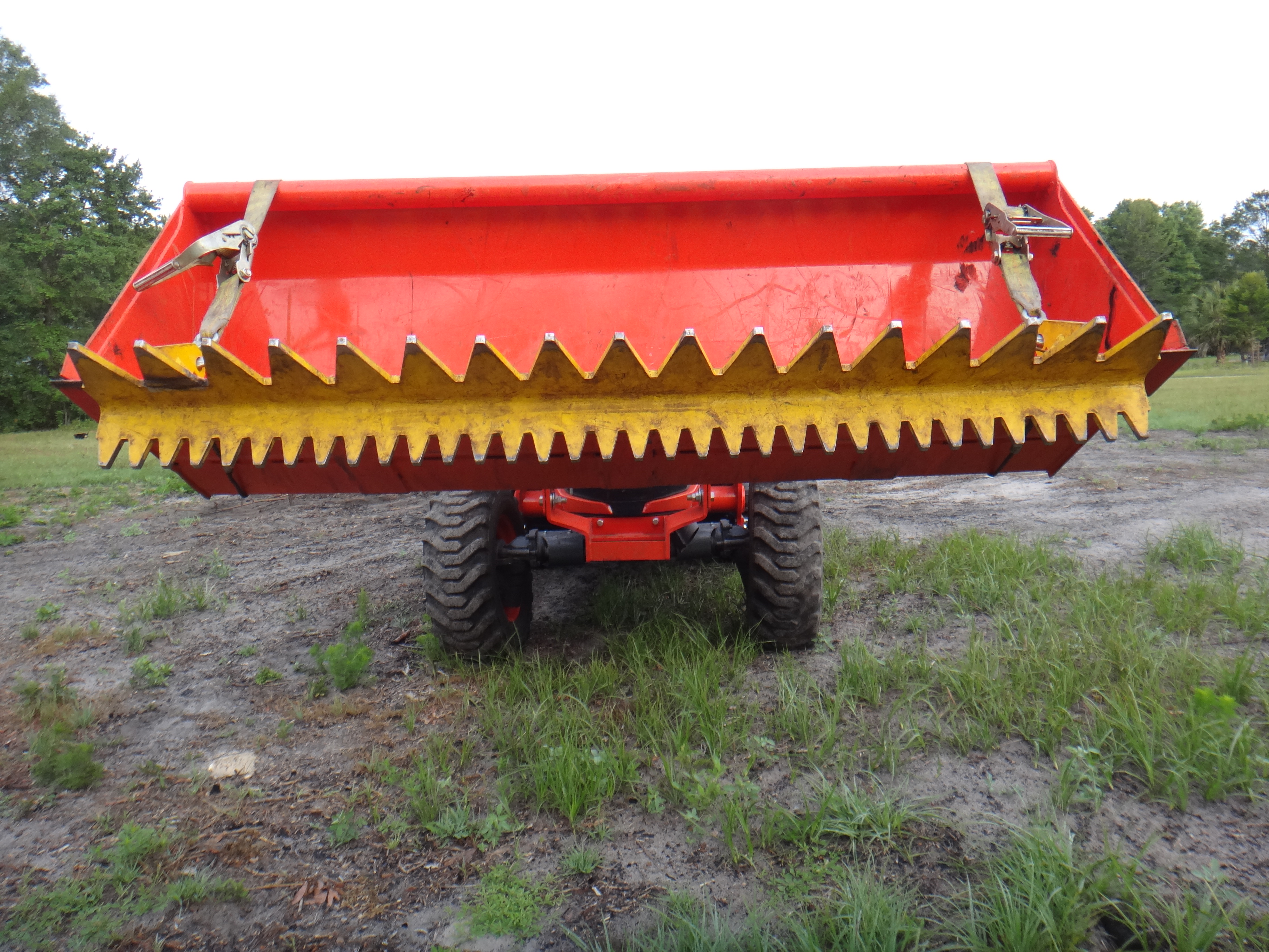

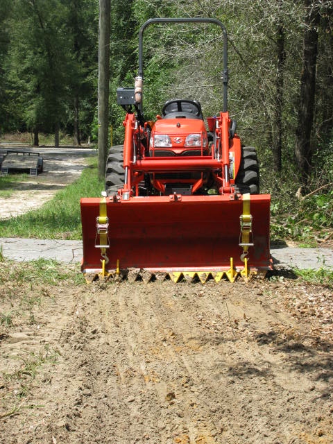

If you cannot lay hands on a roto-tiller a Ratchet Rake bucket attachment will take more time but achieve the results you wish. You can purchase a Ratchet Rake from the tractorbynet.com store; "STORE" button at top of this page.

I can do a pretty good leveling job just using my FEL but lots of folks use a box blade. A box blade is good if you need to move a lot of dirt from high to low spots but FEL works if you are just filling in pot holes with small amount of dirt.
A land plane might be good to drag over your finished project (after filling in pot holes to best of your ability) as it will then final level the whole yard.
Edit: you will need loose dirt from tilling for a land plane or box blade to work correctly.

The best implement to use for what you are trying to accomplish is a PTO powered "power rake". Some people refer to them as "Harley rakes"
It's much too expensive of an implement to buy for one or two uses, but perhaps a local dealer or rental yard would have one available for rent.
