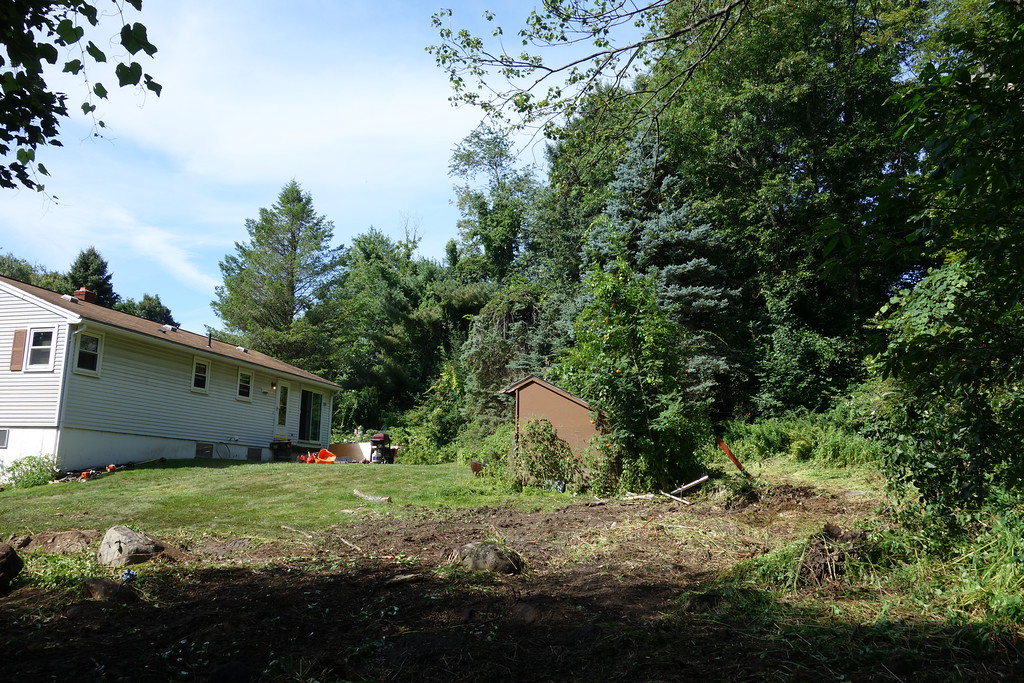

I'm not saying yea or nay on this Harley rake, don't know exactly what on is. I'd like to see it tie into some ground seeded down in brome grass. I'm not saying it won't cause I'm not sure what it is. If it will tear up a brome field I'm sold. You got to have a pretty good horse of a tractor to pull a plow through a brome field. Do you have any pics of this thing.
I don't know what brome grass is unfortunately, but it doesn't work like a tiller, it has small carbide knobs on the rotating drum (which does rotate similar to a tiller) which dig up the ground only a small amount at a time. I will typically go anywhere from 1" to 4" deep but usually somewhere in between. What it does is pull all the material out of the ground in front of the implement, and then there is a small opening that all the soil will go back through, which gets deposited behind the power rake, but the larger things like rocks, roots, old metal in the field etc, all get carried in front of it. At the end of the row you have a pile of debris with almost no dirt in it. Or you can windrow and push everything off to the side.
However, eventually you will have a pile of rocks or roots or what have you, to pick up with your bucket.
This job the op is trying to do, is THE purpose of a power rake. Absolutely the tool for the job.
Here is a before and after of some heavier duty use.

Thanks for all the reply痴 and info guys, you gave me some ideas that I can make work. As far as all the, what I would call 都pecialty equipment goes, they are definitely out because I live in a remote northern community where none of that stuff is available to purchase let alone rent. I did check with a buddy that has a kubota B series tractor and he actually has a pto rototiller that I can borrow. I think it will work fine for breaking up the land because it is sandy soil and isn稚 hard at all. I also have a drag for leveling and smoothing cross country ski trails that would probably work. It痴 6 feet wide and 8 feet long. I will do most of the leveling with my loader bucket and then finish it of with the drag.
Thanks again for the info and ideas
Thanks for the explanation, that helps give me a good idea. As far as brome grass, I'm starting to think that maybe a Midwest thing cause you are not the first person who is unfamiliar with it. It kind of grows naturally here along road side and what not. It is kind of hard on the ground (drains the nutrients) so if you want to use it for hay you have to fertilize it every year to get a good hay crop. It has a tremendous root system that sort of spider webs beneath the soil. If you want to plow it under say to plant corn or soybeans it is best to spray it first. When you go to plow the terraces, boy does it pull and beak hard. As far as the grass and hay feature, it depends on how well you fertilized it. Properly fertilized it will be pretty thick and waste high. It make for an excellent choice of hay for cattle. Hope this helps.
