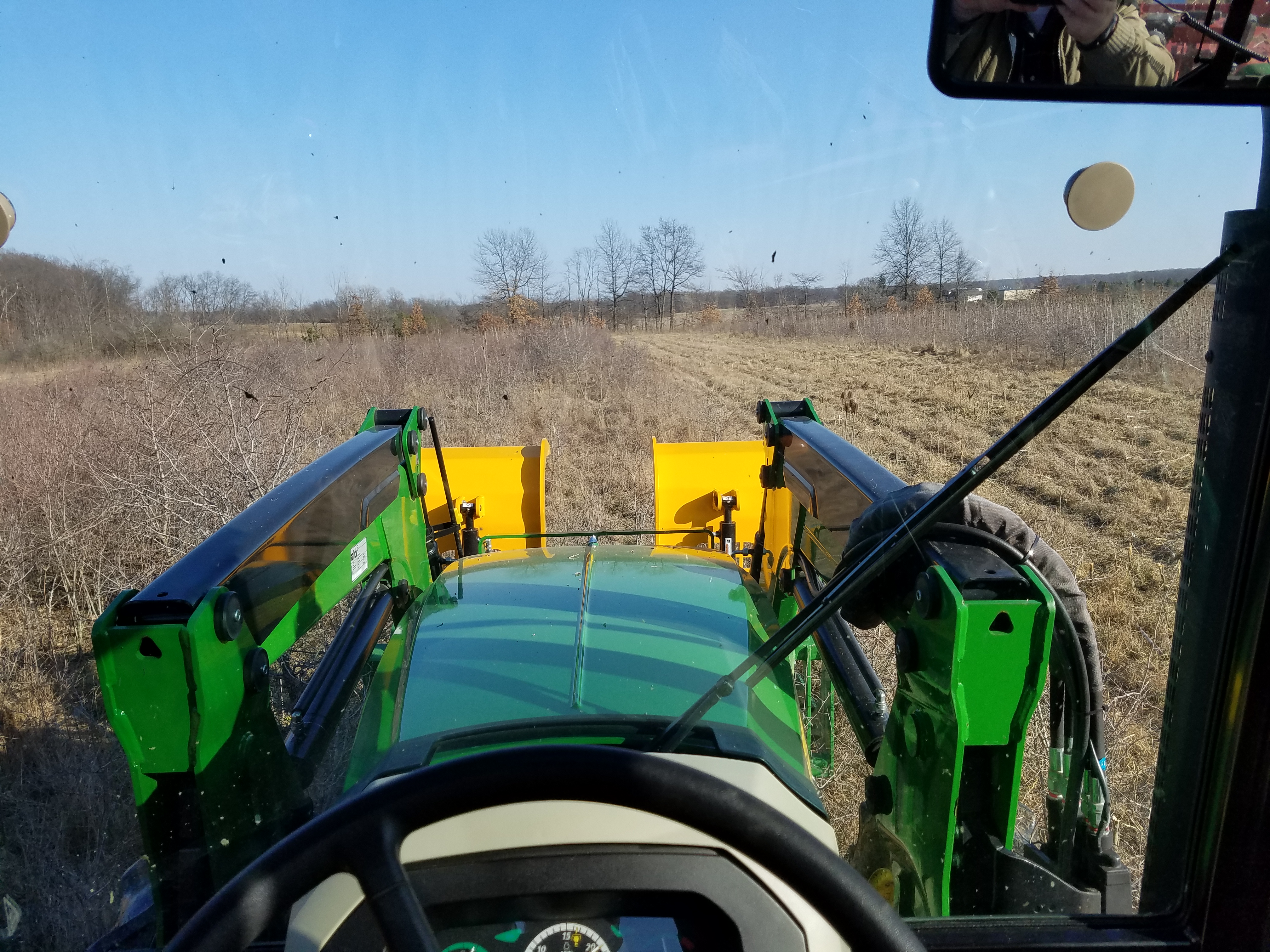

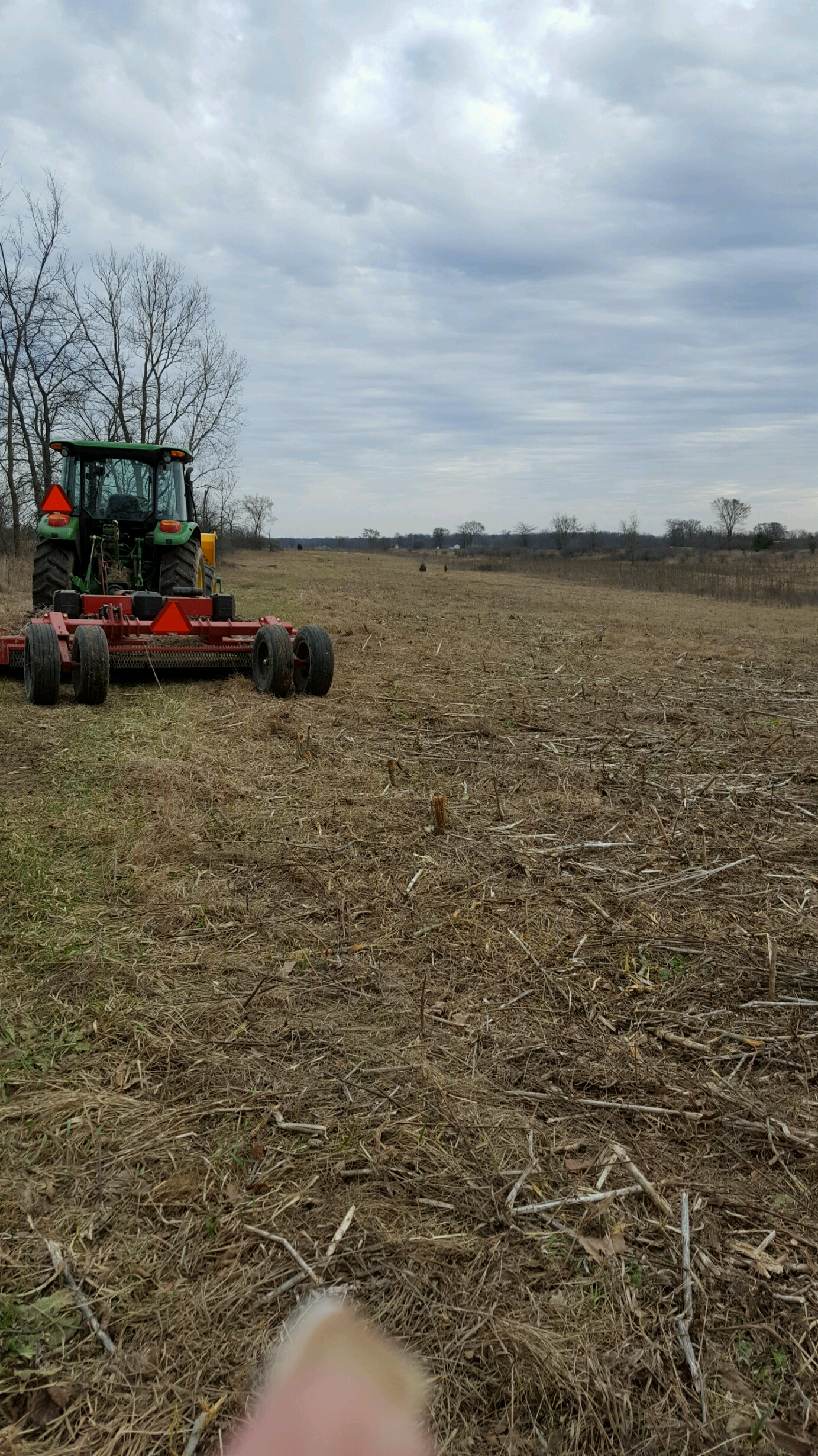

I struggled with this same decision and I am not sure I made the best decision, but I am happy with what I ended up with. There are pro's and con's both ways. In my case we purchased 34 acres late last summer that needs to be cleaned up. The land had been neglected for 10+ years and was overgrown with 6' weeds, thorn bushes, etc. Since I work "full time" I only have evenings and weekends for these activities and I wanted to get it cut before it started growing this spring. A week ago we took delivery of a pull behind Bush Hog 3210 with hydraulic lift, Deere 5085M, grapple, bucket, pallet forks and rear blade. This past weekend the clean up began. This combination worked very well and the Bush Hog is easy to pull, back up and maneuver. It also cut everything without issues and the tractor was a very good match for the mower and conditions.
We also have a 4' 3 point mount rotary cutter that I use with a Deere 1025R on the 9 acres where we live and it will see some duty on this land as well.
I purchased the pull behind with hydraulic lift because: 1. Readily available, 2. Puts less strain on tractor than 3 point and I am certain it is more stable, 3. Easy to maneuver and back up. 4. Can be raised very quickly if necessary.
Hope these thoughts are helpful to you.
In my opinion the only downside of the pull behind is the additional room it takes to turn it around at the end of a row. 2.jpg20170304_162315.jpg20170305_141405.jpg
