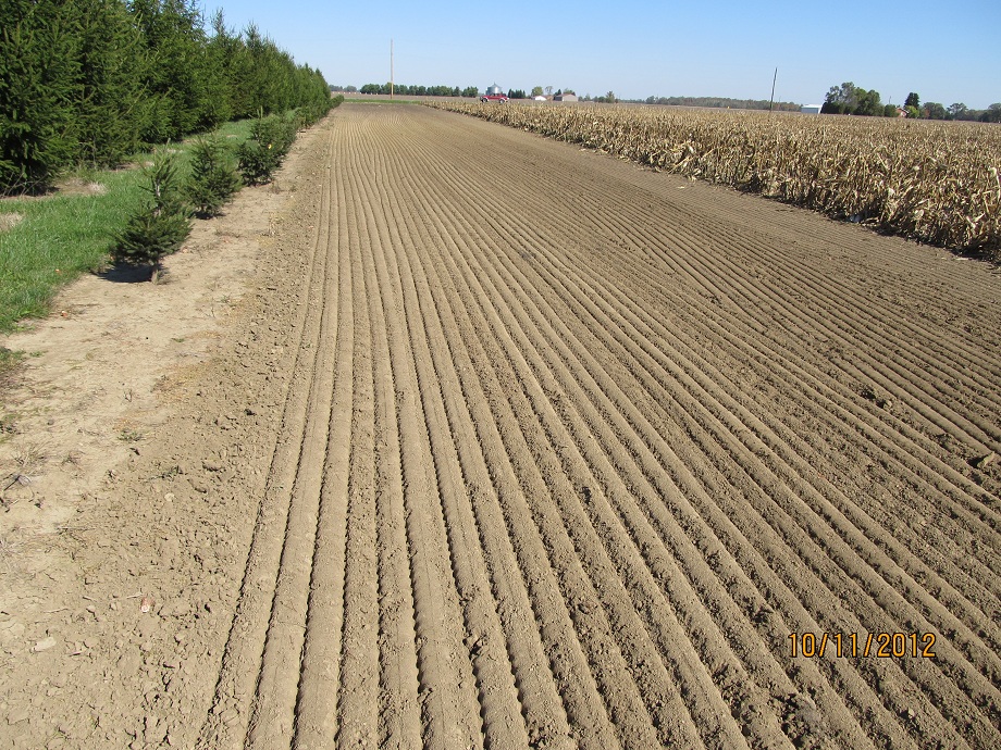

A portion of my cornfield I used for setup of equipment.
Piece of cake.
