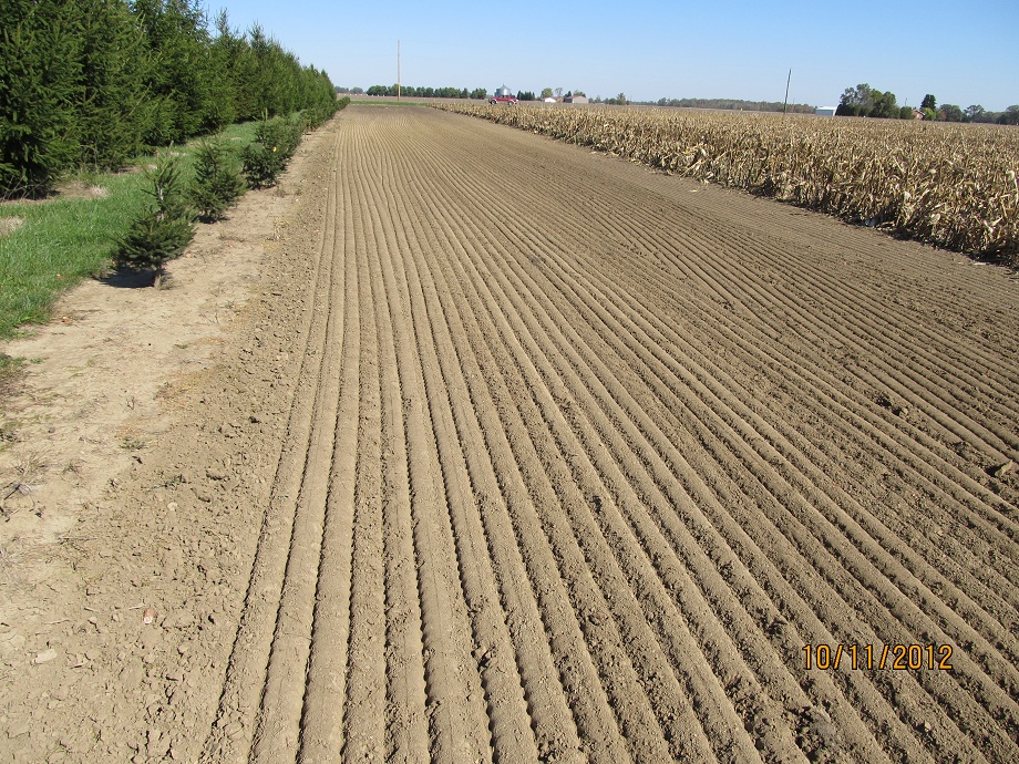

A portion of my cornfield I used for setup of equipment.
Piece of cake.

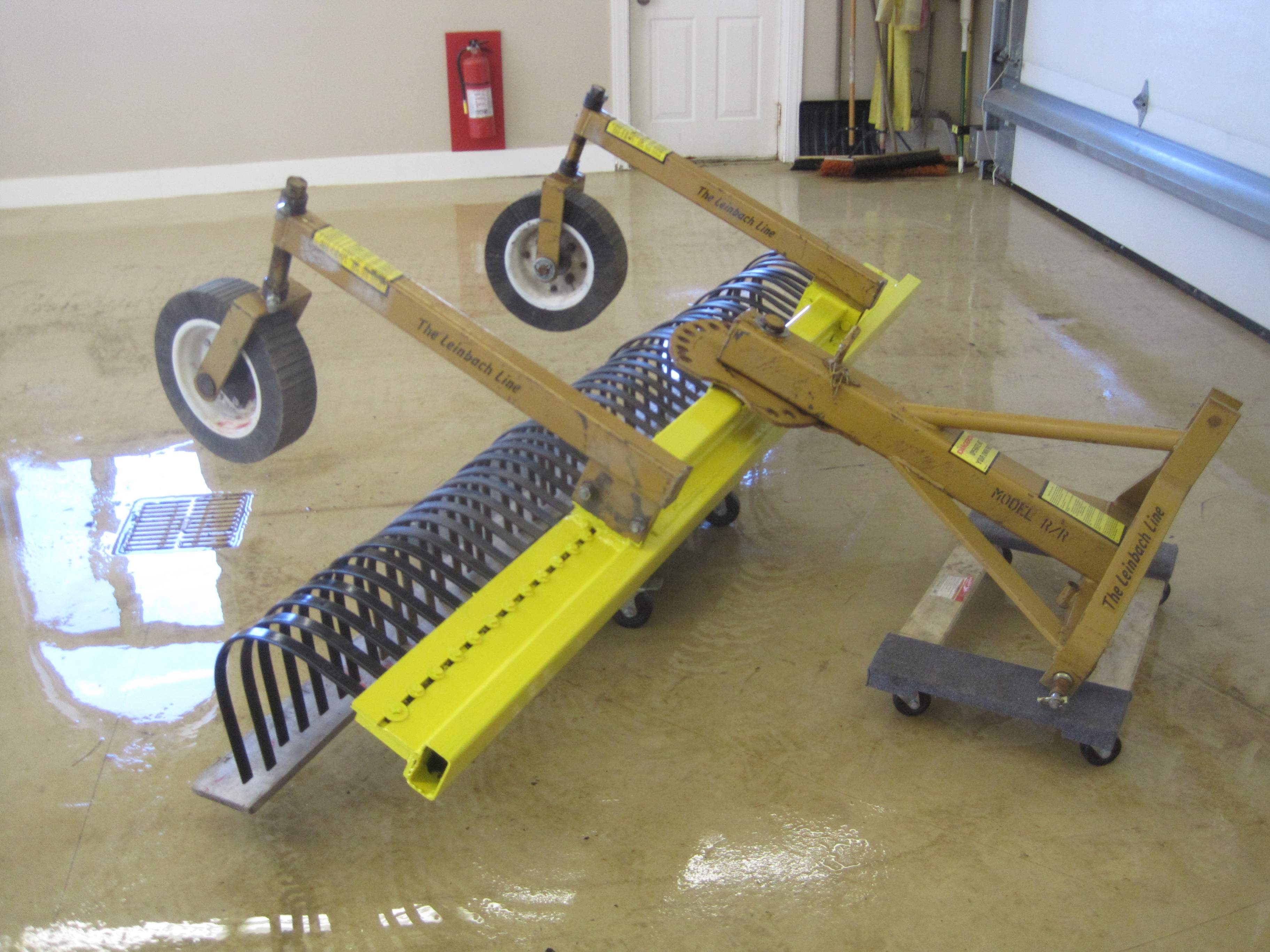

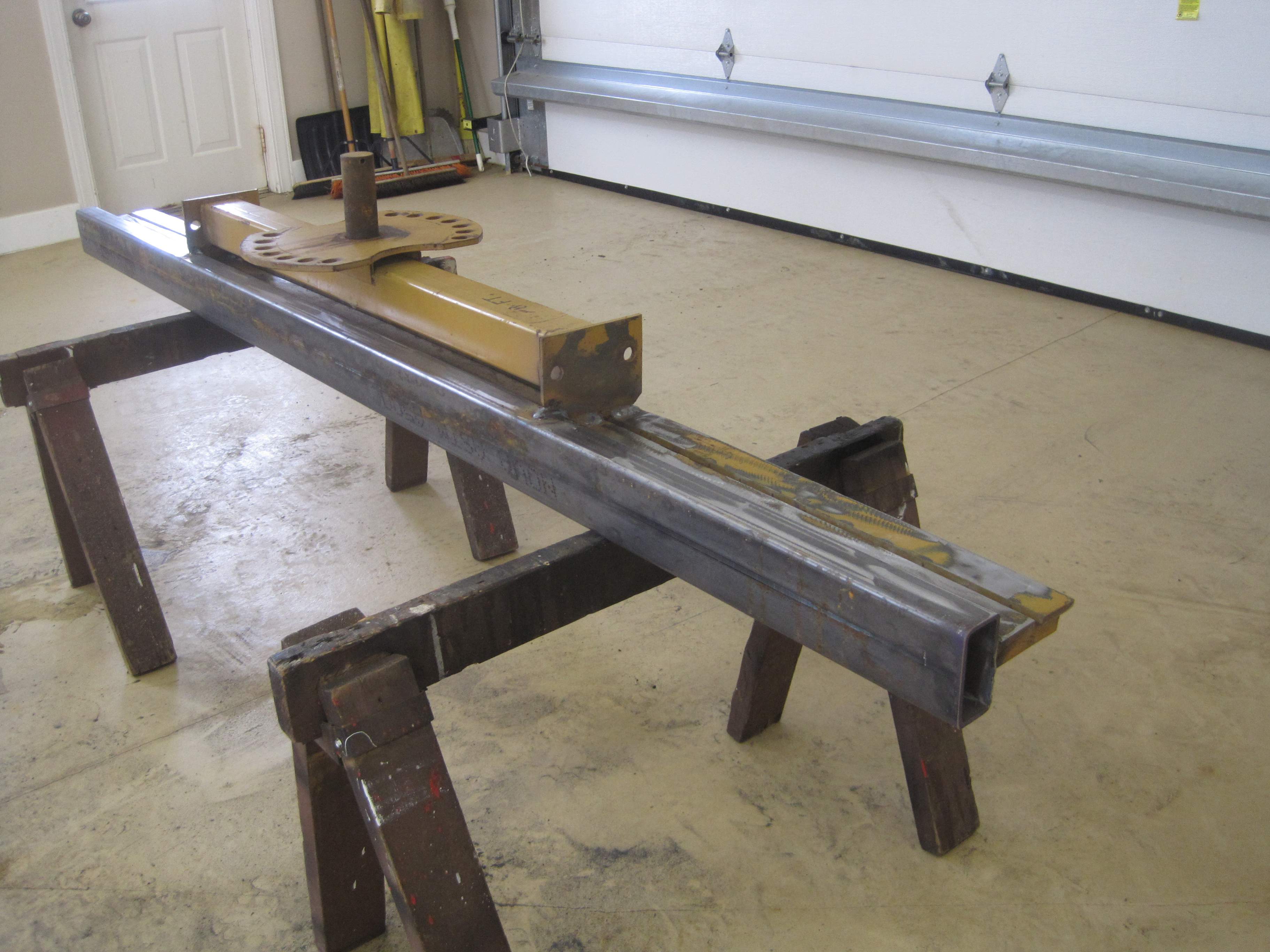

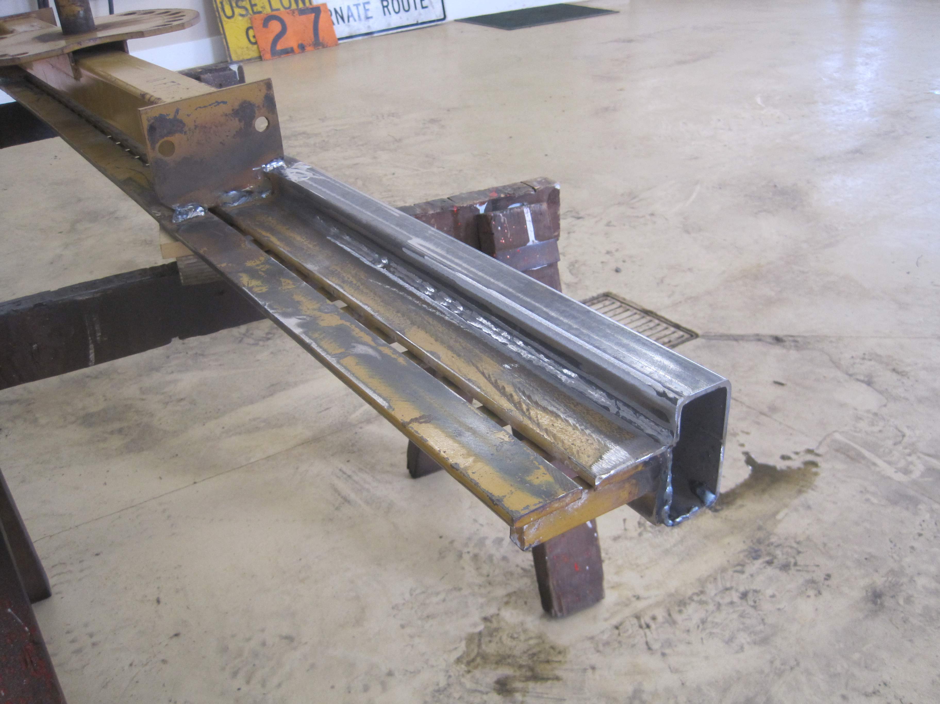

I have a 8' Leinbach rake, but the horizontal beam is kind of wimpy. It bent and twisted with normal use, causing the tines on each end to be above ground while the center dug a ditch. I cut the beam off and used a hydraulic press to straighten the bar. Welded a 2x4" steel rectangle to the leading edge to give it strength. The new steel added needed weight.
Standard replacement tines (agrisupply.com) are 27" ($3.30 each) compared to Leinbach 28" ($7.50), so I chopped 1 inch off all the original Leinbach tines.
Italian, or not, they still break.
Very nice work.
View attachment 363690 View attachment 363691 View attachment 363692
My Woods LR72 bent the same way your did. I was using it behind a 8N to rake my gravel driveway and a little other light work. I was able to straighten mine and brace it.
