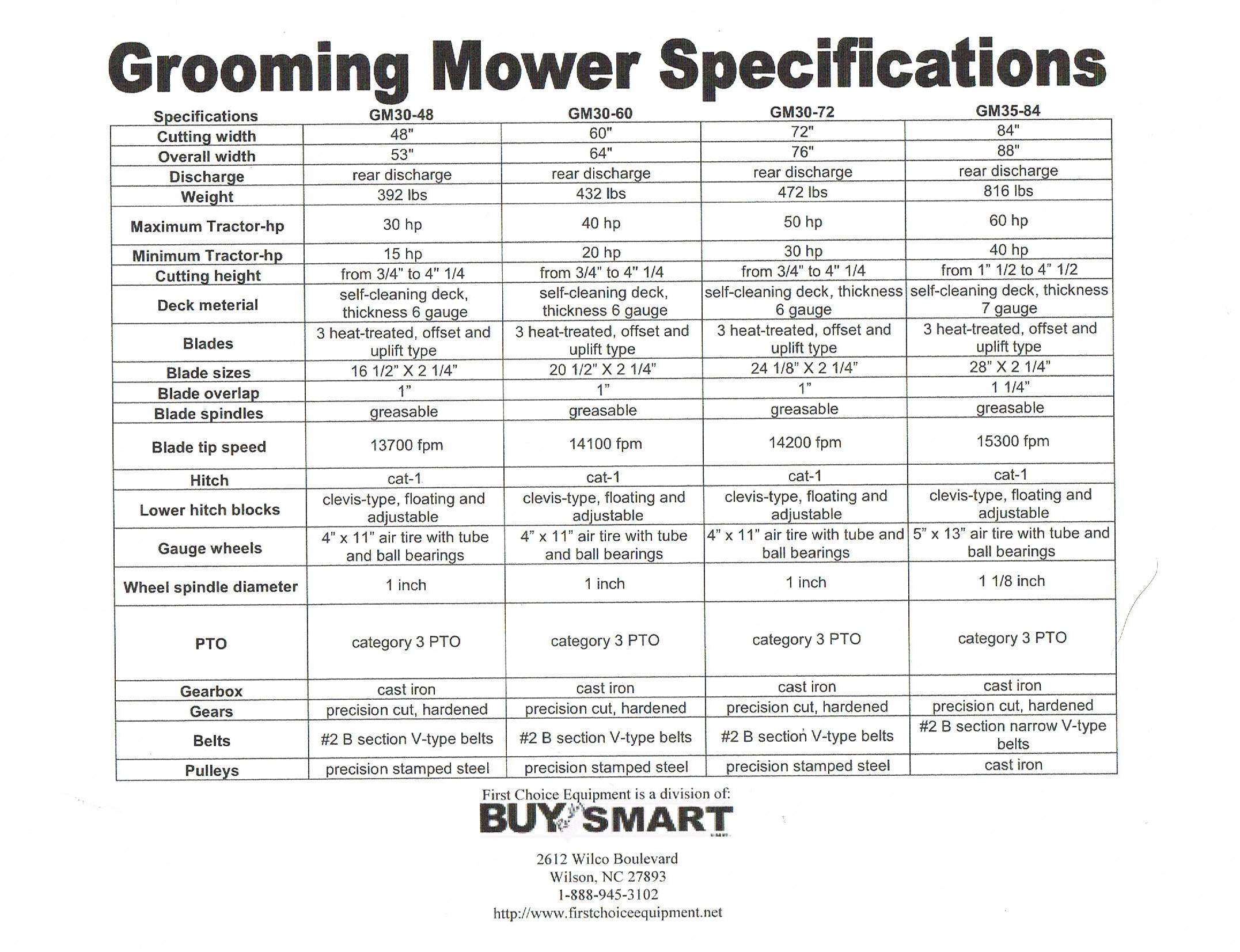

If you mow every week, you may get by with a 6 ft. The best choice may be a 5 ft. We have the First Choice and Phoenix (both made by Sicma in Italy) You can'[t buy a better finish mower. 5 Ft $1395, 6 ft $1895. Anti Scalp wheel is optional and cost $100. Ken Sweet

With a level lawn and mowing weekly, I'd go with a 6' mower. I had a 5' mower behind my 24 PTO HP Deere 790 and it could have easily ran a 6 footer.
So now, it's just a matter of how much you want to spend. RFMs aren't cheap...and they get more expensive the bigger you go.

Ken is right on. I do have a Woods 72" that I run behind my B3200 which has just a little more HP then yours. I cut about the same 3 acres and the tractor is hardley working, you should be good for either the 5' or the 6', but as you said no trees==6 ', go for it.

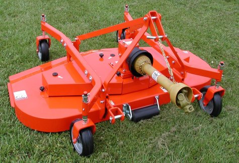

Did you look at a King Kutter RFM-72? It's made in America too... so that's a plus. You might check it out.
This is a picture of a 5' model, but the 6' model looks the same, just wider.
