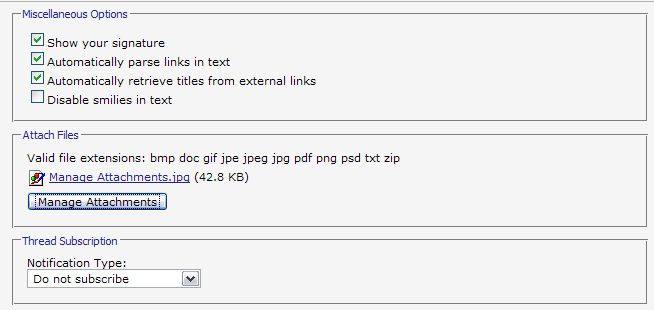

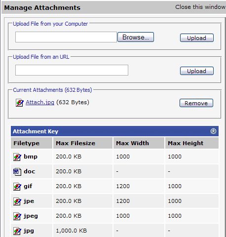

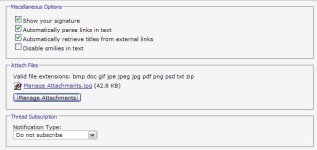

To post the picture, reply to this thread. When you're done typing in the box, scroll down a little on the screen until you see the button labeled "Manage Attachments". Click it. Under "Upload File from Your Computer" , click 'Browse' next to it, find the picture on your computer, select it, and then click 'Upload' next to the 'Browse Button'. Once it finishes uploading, close that window and hit "Submit Reply" just like normal. I attached 2 screenshots of the two screens you're looking for...the button you click first is the second one, and the screen you get is the first...

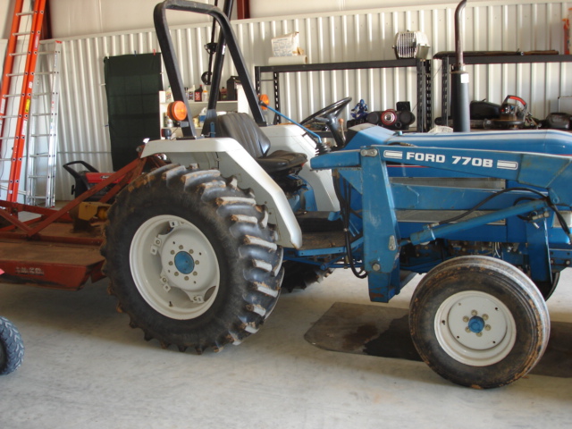

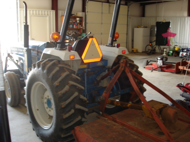

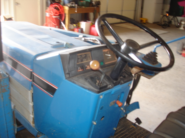

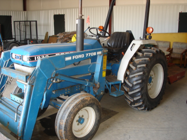

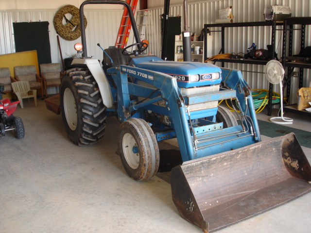

Attached are 5 pix of the Ford 1920.

Looks pretty clean, except for the leak under the front. Check it out good and good luck.

about the pics.. machine looks good.. but that front oil leak needs to be investigated.
gosh.. I miss that column shifter.. wait a minute.. no I don't! I like a ford 8-spd MUCH better..
