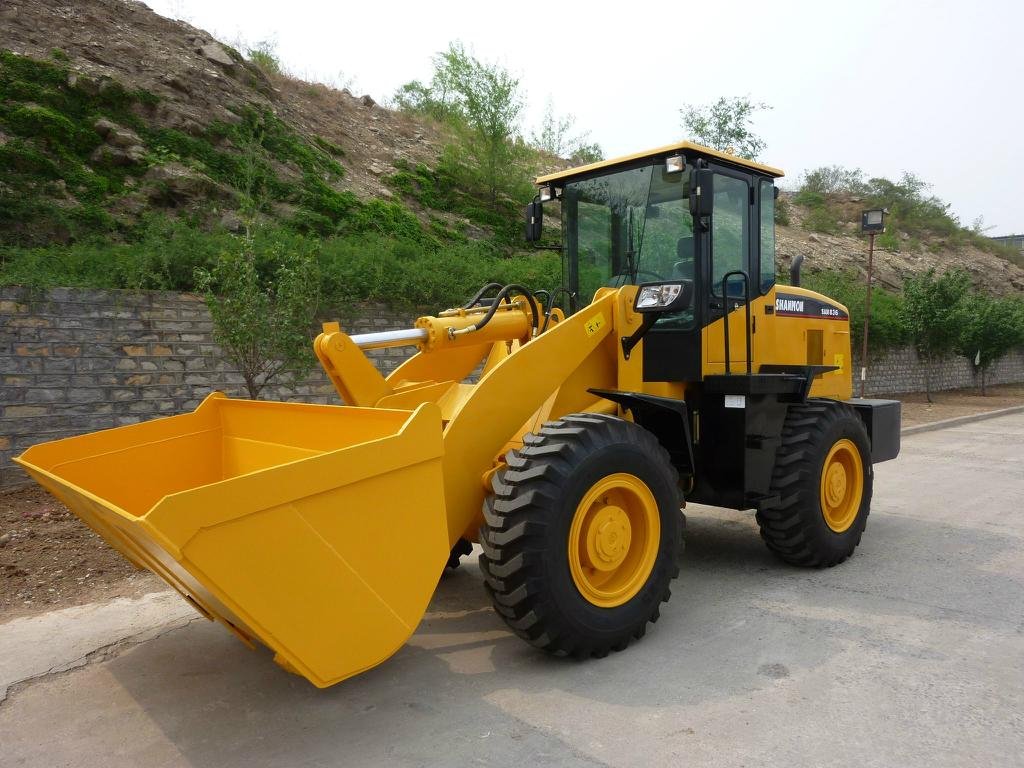

That’s the same way my backhoe is. I don’t like the cylinder mounting because it sticks up in the air, but there’s no difference in strength. Duel cylinder are plumbed in parallel and do nothing to help the frame from twisting. Btw the wheel loaders do that to reverse the direction of the cylinder to curl the bucket up with the extension stroke which is stronger. Most other loaders with a cylinder cylinder still curl up with the retraction stroke.

That痴 the same way my backhoe is. I don稚 like the cylinder mounting because it sticks up in the air, but there痴 no difference in strength. Duel cylinder are plumbed in parallel and do nothing to help the frame from twisting. Btw the wheel loaders do that to reverse the direction of the cylinder to curl the bucket up with the extension stroke which is stronger. Most other loaders with a cylinder cylinder still curl up with the retraction stroke.
Twin cylinders give much better load control than a single cylinder. A single cylinder is just manufacturer cost cutting in lower priced units.
