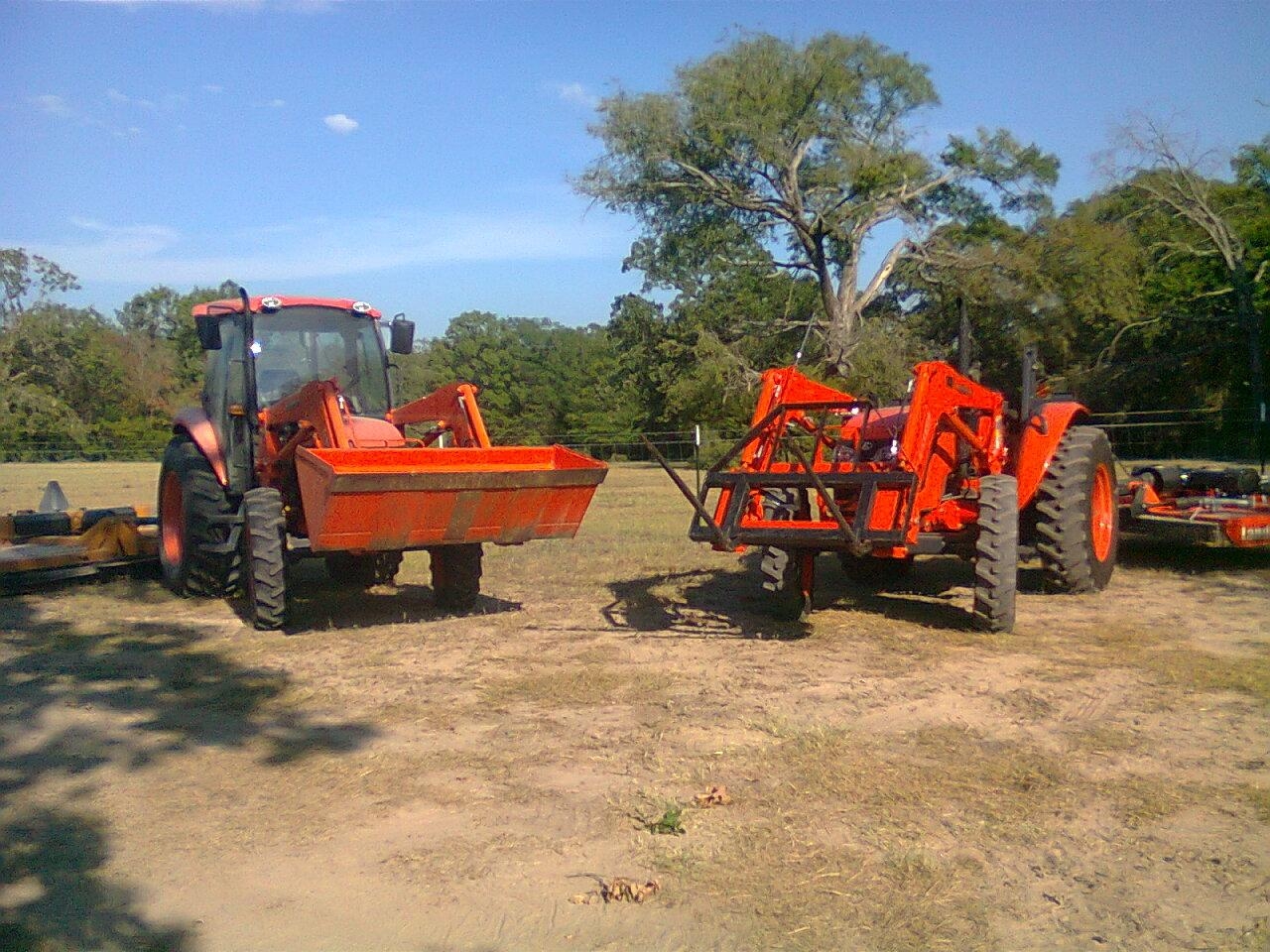

tractor2.JPG they are good tractors i must say:thumbsup:
