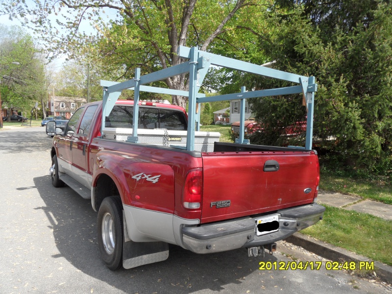

On my new to me toy, my F350 DRW 7.3L 4x4 I wanted a ladder rack, for rare use. The used ones on CL etc. didn't look adjustable.
Trac-One has a decent adjustable frame one for $300 BUT IT DOES NOT FIT Superduties, my cab is too high (plus I've got running lights on top).
So I went to my basement, and with a few 2x4's and connectors I've built a frame that will START to meet my needs. Six stakes, 3 crossbeams, clears roof by several inches, no pics.
And I'm looking at it and thinking I could enclose it w/ removable plywood sides running to the top to increase my load size as I "ferry" stuff down to my retirement home. Basically a removable set of walls with a tarp strapped on top.
I'm not planning on using it for hauling firewood or stone, just cardboard boxed household items.
So my question, for any of you that have done similar - What thickness and type plywood do you think I'll need for 70mph and rain? Will half inch do? Do I need to go to 3/4? Pressure treated? Marine?
thanks

I'd EXPECT to use the box maybe 2 or three times a year. I'll probably want the rack more frequently to carry ladders or long lumber. I'm leaning towards 5/8 Marine plywood for the box IF I can find it locally, the big box stores (HD, Lowes) don't carry marine, the only close lumber yard has to special order marine, so I might go PT and paint.
The rack cost about $70, half for hardware and half for PT 2x4's. I bought a bunch of the metal angle brackets, should have used scrap plywood for angle braces.
Of course I don't know AND DON'T WANT TO KNOW how many federal, state, and local regulations I've broken by not having a licensed carpenter and licensed mechanic put it together under the supervision of a licensed architect and licensed safety engineer with an inspection by a licensed ladder rack inspector.
It seems very sturdy so far when subjected to both vertical and horizontal forces. I've yet to test in the windtunnel called I95.

Remember that you will have forces pushing the sheeting out as you drive faster too. For this reason I would fasten the sheets to the inside of your framework, with a space cut in for your toolbox. It may not be as pleasing to the eye, but it will be very secure.
I can't tell from the photo, but also make sure that the frame is secured to the bed. This is most important when transporting anything that could become a type of sail. Probably easiest to use screws with large washers through the access holes in the stake pockets, so that the frame is secure and you don't need to drill into the sheet metal.
Otherwise looks good!

You're wasting your time building a rack out of wood. Not only do you need to figure the load but the forces involved with that load and road conditions. Hit a pot hole and that load gets doubled pretty quickly.
Used racks are a dime a dozen on E-bay craigs list etc.
Here's one for $260.00. You couldn't buy the lumber for that.
