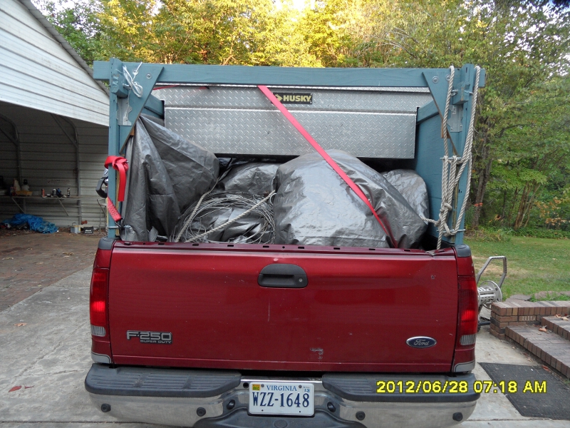

Update
Well I've used this now for 3 trips to and from Mississippi (~800 miles @way) and it seems to reduce my fuel mileage by about 1 MPG.
The first time I used it I just stuck my cross-bed toolbox inside. The second time I took the toolbox out of the back and "mounted" it temporarily on the upper bars.
With the panels off I haven't made the effort to take down the frame, since I keep on finding I have to transport a ladder or a few 12' 2x4's. However it still has enough clearance that when I picked up my Craigs List score of pallet racking they were able to load the uprights palletized with a fork lift.

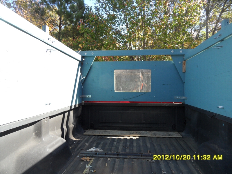

Another update and refinement.
I added a "window" to the front of the box.
I've had a piece of plexiglass for about 30 years, I think it was used for a desktop cover.
I cut a hole in the plywood and put down some window sealant around the side, laid the cut to size plexiglass down, put some wood strips on the plexiglass then drilled holes and put some small bolts I had thru.
Makes a world of difference having the window when the bed isn't full.
Now I have to break down and buy some shorter bolts. :) There goes another couple of dollars.
   / which plywood for truck bed sides? #36
Now I have to break down and buy some shorter bolts. :) There goes another couple of dollars.[/QUOTE]
Or just cut them down.
