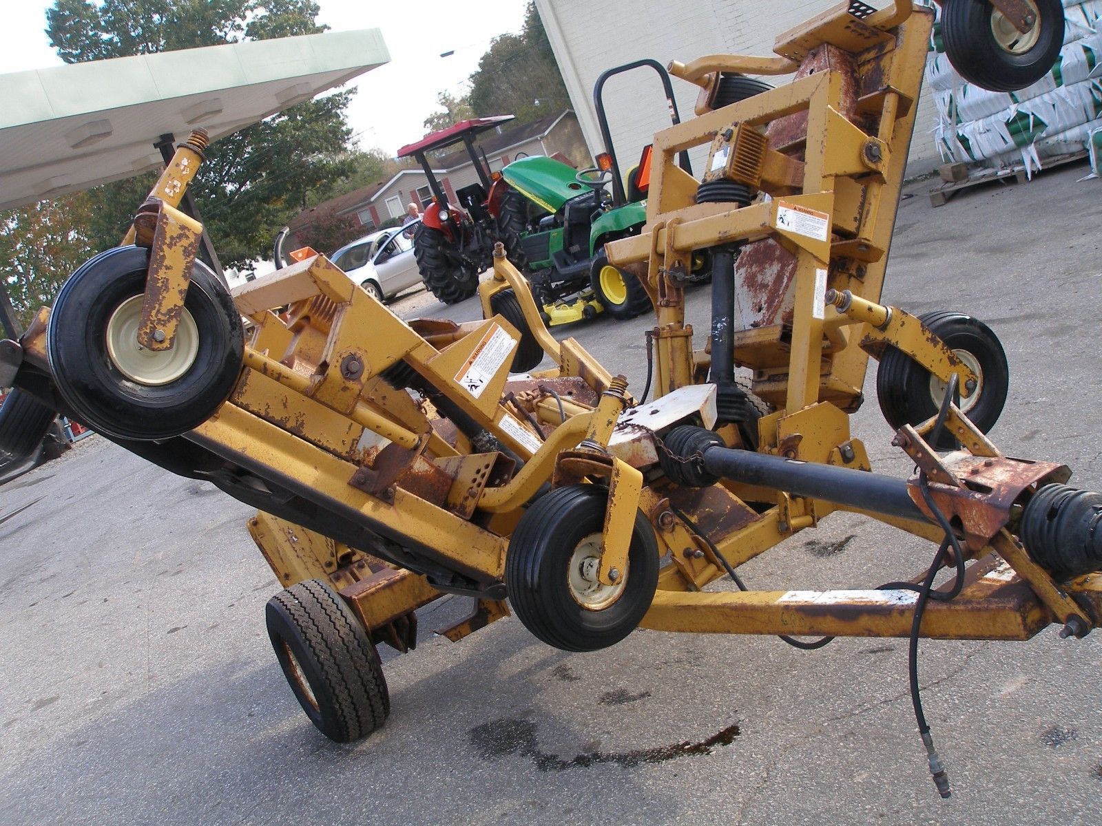

Hmmmm bspeedy,, the bat wing is nice,,,
BUT, I take a wooded trail to get to my daughters house to mow,,,
I think I would have to cut down some trees to be able to get the mower there,,,,
:laughing:
   / Which RFM? 32 PTO HP,,,, 6 Foot, 7 Foot, or 90 Inches?? #13
:laughing:
Only have to cut them down ONCE though. :thumbsup:
Transport issues would be the only downside I can see to the larger mower. Loading one of those on a trailer would be quite difficult, as well.
If you do go batwing, I'd like to know how it works out. Like I said, I've been tempted.

Some 12' batwing mowers recommend 35 HP, so I think one would work for you. Just really depends on what you are looking for.
#20
Yea,, the bat wings are nice,, but,,, the $9-10K price is a little hard to get past,,,
