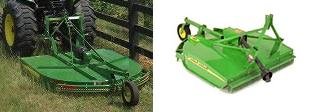

OK, I am looking for a rotary cutter for my 4310 MFWD eHydro. I learned already that I need to be mowing with the loader removed. (too much front end wear with it in place) Now I thought the Bush Hog SQ94T looked nice, but there just seem to be too many complaints about it holding up. (it is a 7' dual spindle, weighs ~720Lbs. and requires 25Hp.)
So I'm lookind at the LX6 vs. MX5. I am cutting grass, weeds, blackberries and tiny saplings. Not heavy brush. I mow about 60 acres, to keep the weeds down, for my stock to have grass. There are several operators, all wanting seat time, so I don't need to go buy a bigger tractor, yet.
The LX6 will cut 20% more per pass. It will mow out my tracks and allow me to get up close to fences, etc. It doesn't have as clean a top, is lighter duty and may not cut nearly as fast as the MX5. It is ~$1325
The MX5 is HEAVY DUTY. (OK,its a medium duty) Literchure sounds like it is a fast cutter, due to it's design It's a nicer design, both top and bottem. It is narrower than my tracks. It is $1400.
Any ideas pro or con?
How about ballast? According to the manual, either requires more ballast than seems possible. We aren't brush cutting, so it won't be raised much.
Would there be any problem with loading the front tires to cut down on the number of suitcase weights?

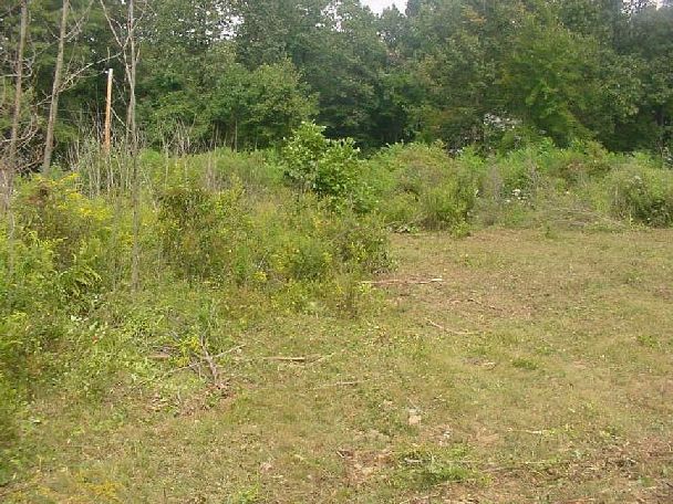

If you're going through stuff as shown in the attached picture, you'll want your loader on to knock it down a bit so you can see those hidden stumps and such.
As far as front weights...why not see how well the tractor picks the cutter up first. I've found I do not need weights for the RFM (~ 400 lbs), but the cutter (> 600 lbs) requires front ballast. My tractor weighs about 1800 lbs without the FEL. You 4310 weighs pretty close to 2700 lbs, I believe. As a percentage of weight (cutter to tractor), you may find you don't need front weights (although the FEL is recomended). I also normally just lift my cutter high enough to get the front off the ground (say, 10") leaving some of the weight on the cutter's tail wheel. So far, no problems, but I don't have more then 20 hours on the cutter.
