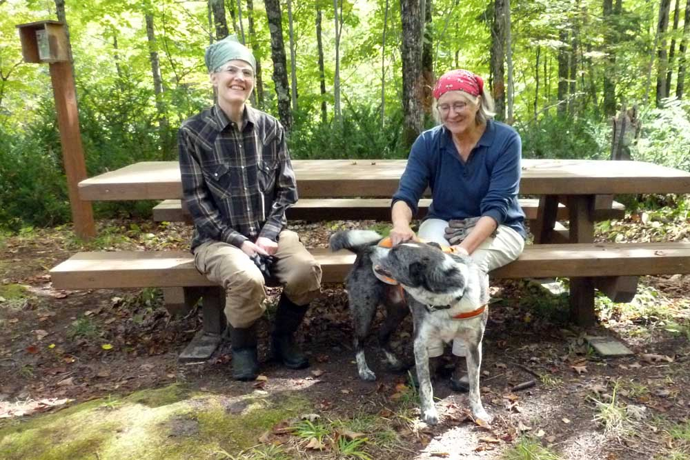

We have some large picnic tables we care for which are located at remote locations. The finish is starting to peel so they need to be scraped, buffed and refinished. For cleaning and buffing them I thought I'd bring my generator so I could use my 4.5 angle grinder to do that job with. We'd then blow them off with air compressor when done. What pads might we use? I thought about trying these soft pads in 120 grit.

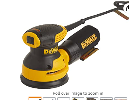

Those work out to be about $2.80 each at the price I saw. Normal orbital sander pads are anywhere from .40 each to maybe $1.80 each. At the rate you may be going through pads, I'd suggest you buy an orbital pad sander. The orbital action is going to be more efficient at sanding. The sander itself will be easier to control just using one hand.
I'd also recommend buying both 80 grit and 120 grit. Outdoor wood may need more aggressive sanding to clean up followed by the 120 to get it smooth. Orbital sander pads use hook and loop fastening so they will be much faster to change than changing pads on an angle grinder.
I only have used a corded orbital sander. Can't really speak to whether it would make sense to pick up a cordless version so you don't have to carry a generator or listen to the noise. But I would encourage you to look into a cordless sander if you already have batteries for a cordless drill or other tool.

The stain used here before is not being removed, just loose stuff ground off and surface abraided for the next coat. It's the stain type that's nearly like paint which I don't like but I'm redoing it after the fact. If you note another thread here was about poor performance of water based stains.

3M Xtract Cubitron II Net Disc, for me, sanding a deck with a ROS, they lasted a long time. But if your going Belt I'd go with a 3M product.

Hey folks, I own every type of sander previously mentioned. This is outdoor park furniture so speed and durability of finish is the important thing. A belt sander will be tried.
