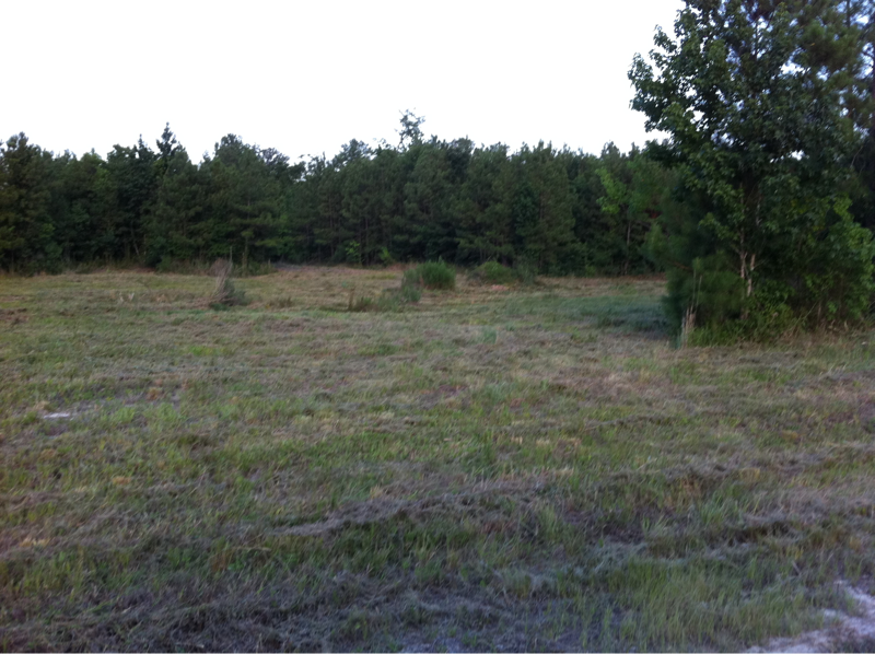

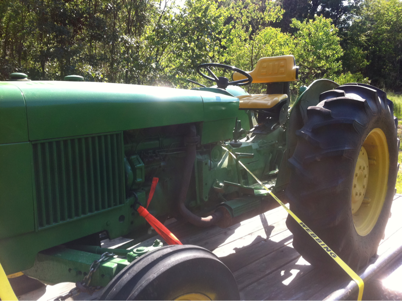

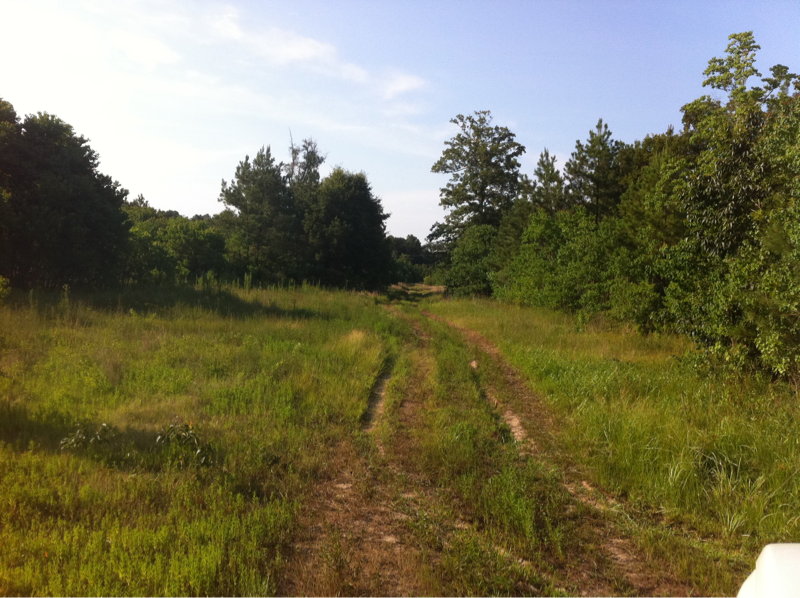

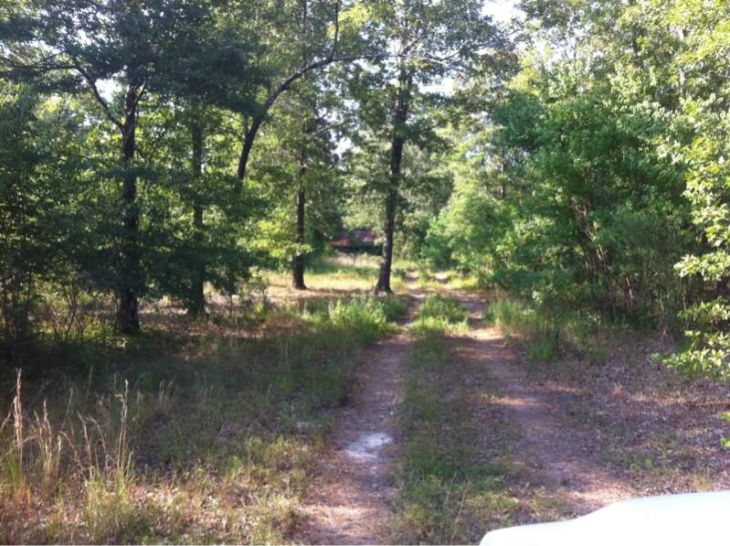

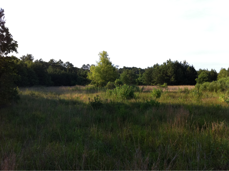

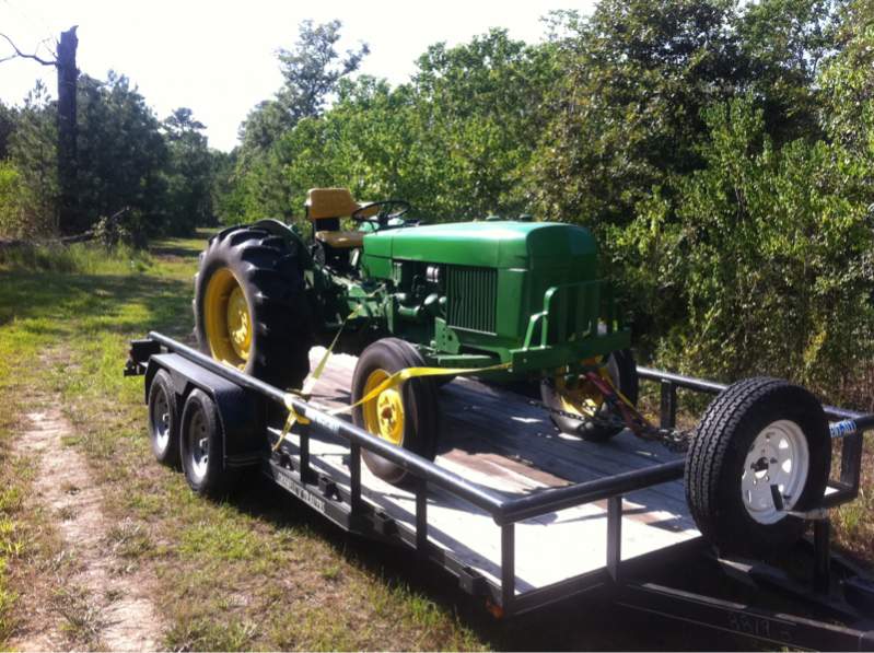

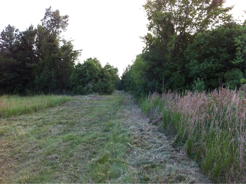

Thanks for those suggestions, I'm going to check into those models. My property is 42 acres mostly wooded with around 14 acres pasture and lots of trails and roads through the rest. I have some other portions that was thinned 4-5 years ago but it's growing up with chinese tallow trees now. I'm going to let some grow and cut a few paths through them eventually to ride horses through. I guess total maybe around 17 acres or so to be mowed, but some will be trails instead of open pasture. Here's a couple pics of the land and my "new" tractor out there!
