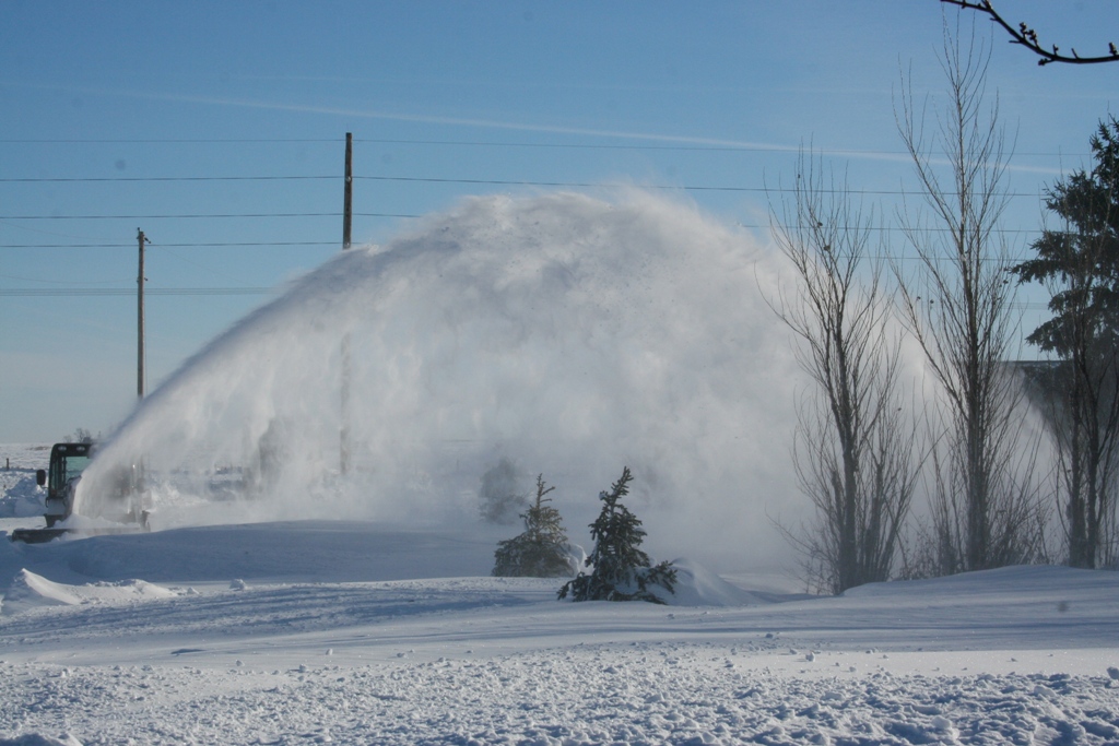

   / Which snow blower should I order? #16
Picture of our December snowblowing. Total was 13 to 14 inches.

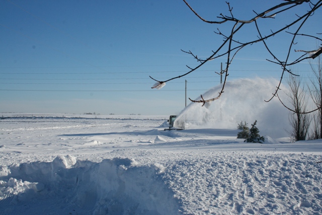

   / Which snow blower should I order? #17
Another picture
   / Which snow blower should I order? #18
That is really good throwing distance. My machine is a low flow and I got the torque motor so it throws only about 10 feet. Make sure you keep the rotation chain lubed or it will freeze and not rotate.
