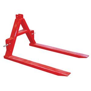

I found one at Agri Supply that will work for what I want to do.
http://mower-blades.agrisupply.com/thumb.php?f=http://www.agrisupply.com/images/l/72511.jpg&s=120
Really, depending on what you want to do will determine what is best.

Those look like pallet forks.
Essentially they are but, the dimensions are the same as the carry all. You can still bolt planks/boards to it or have multiple configured "skids". Also, with a FEL mounted hitch they can be used to load and unload stuff.
For me, the ability to have multiple uses/configurations works better than a single unit/platform
Although probaly a little bit more pricey than the carry, they are the best thing as far as durability. however, for thos that want to takethe cheaper way out, the tsc carry all is a pretty sturdy unit for the price. those pallet forks will most likey handle more than the 3pt hitch can lift
