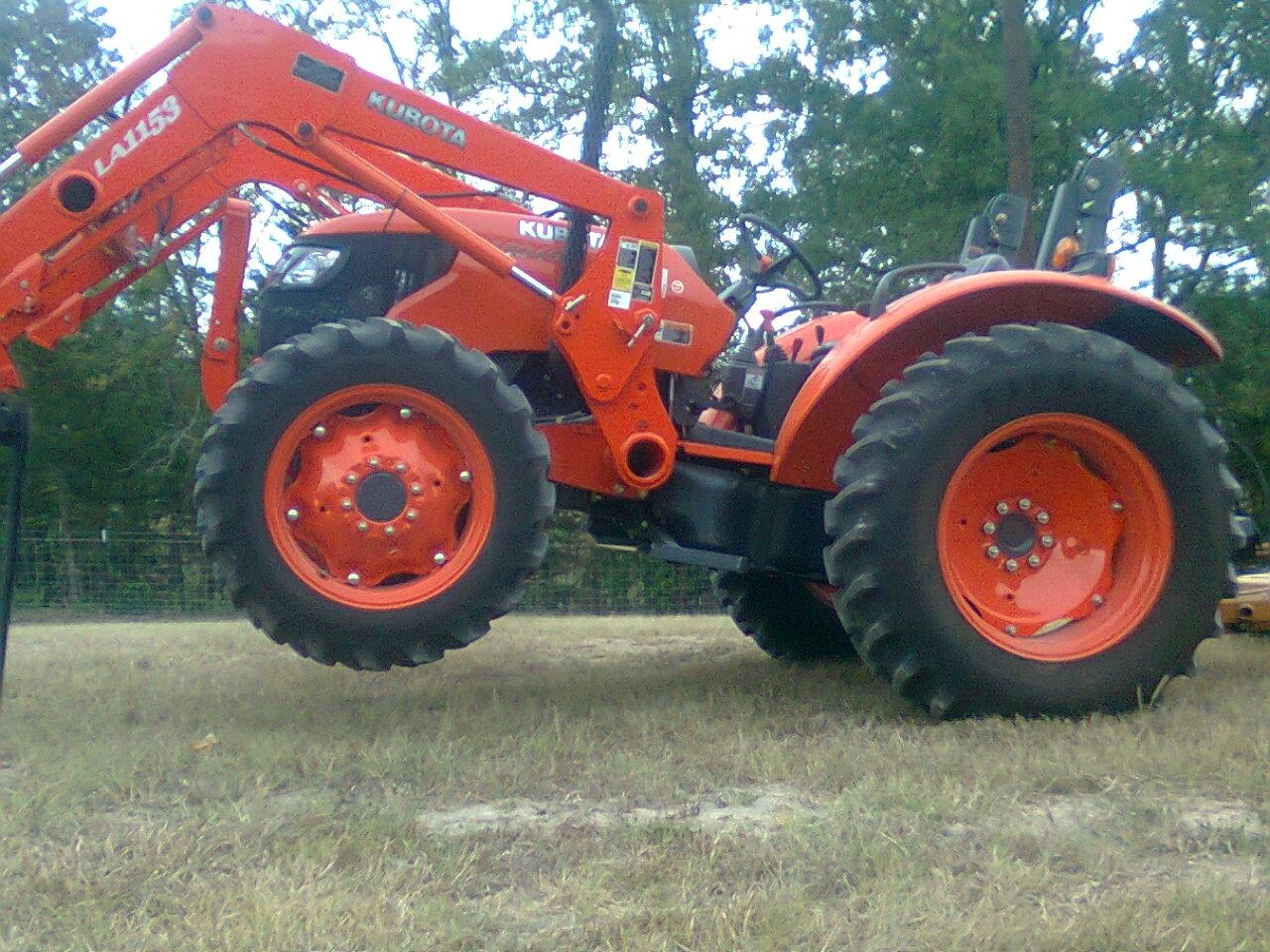

5040 and ds1440wheelie.JPG This 1!!!:D

The more people I talk to the more confused I get, I don't care that it's big and tall but dater in law keeps saying I will roll or flip this tractor because the center of gravity it too high, he thinks I will tump it over bush hogging? Any thoughts?
   / Which tractor do I need? #20
You could turn ANY tractor over, if the conditions were right.
But, if a 5 or 6 series John Deere 4wd tractor with a cab was that easy to turn over, the road ditches would be full of them. :D Around here, that's just about all they use to mow the right-of-ways.
