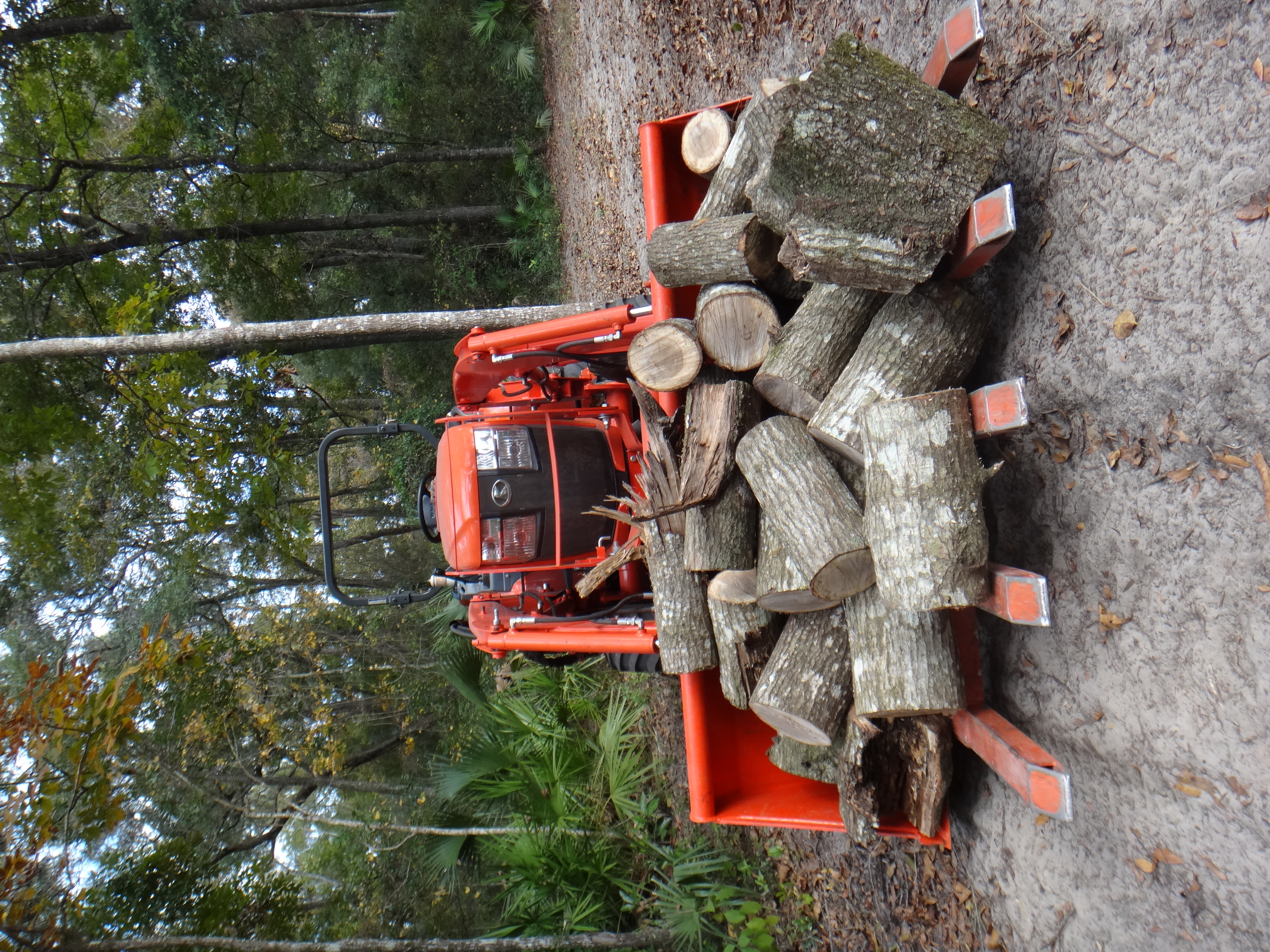

1) Chipping brush on sixty acres is an impossible aspiration. You will need several burn piles. Producing firewood makes some sense but it is not very economically rewarding considering the time it takes. Tractor hydraulic log splitters are complicated and slow. I suggest a 220 volt electric log splitter on wheels, which can be moved in and out of your garage or barn and used in the driveway. Trees 10' to 20' tall should not required much splitting, mostly cutting into billets with a quality chainsaw. PHOTO #1
2) Trail maintenance requires tractor weight. I recommend a bare tractor weight of at least 3,700 pounds. A Ratchet Rake bucket attachment is a basic trail maintenance attachment. PHOTO #2.
Tractors are designed to pull. Any tractor of 3,700 pounds or more will pull several 10' to 20' tree trunks at one time using chains connected to a rear/center drawbar or cross/drawbar. PHOTO #3 ~ Cross Drawbar with optional "hanging tree".
3) Kubota Grand Ls and MX series overlap in weight at 3,700 to 4,500 pounds, bare tractor weight. They have very similar capabilities with similar weight. The Grand Ls are de luxe tractors. The MX series are economy tractors. There are far, far more MX tractors sold, new and used, than Grand Ls. Loaders on new Grand L and MX tractors can lift more than 2,000 pounds.

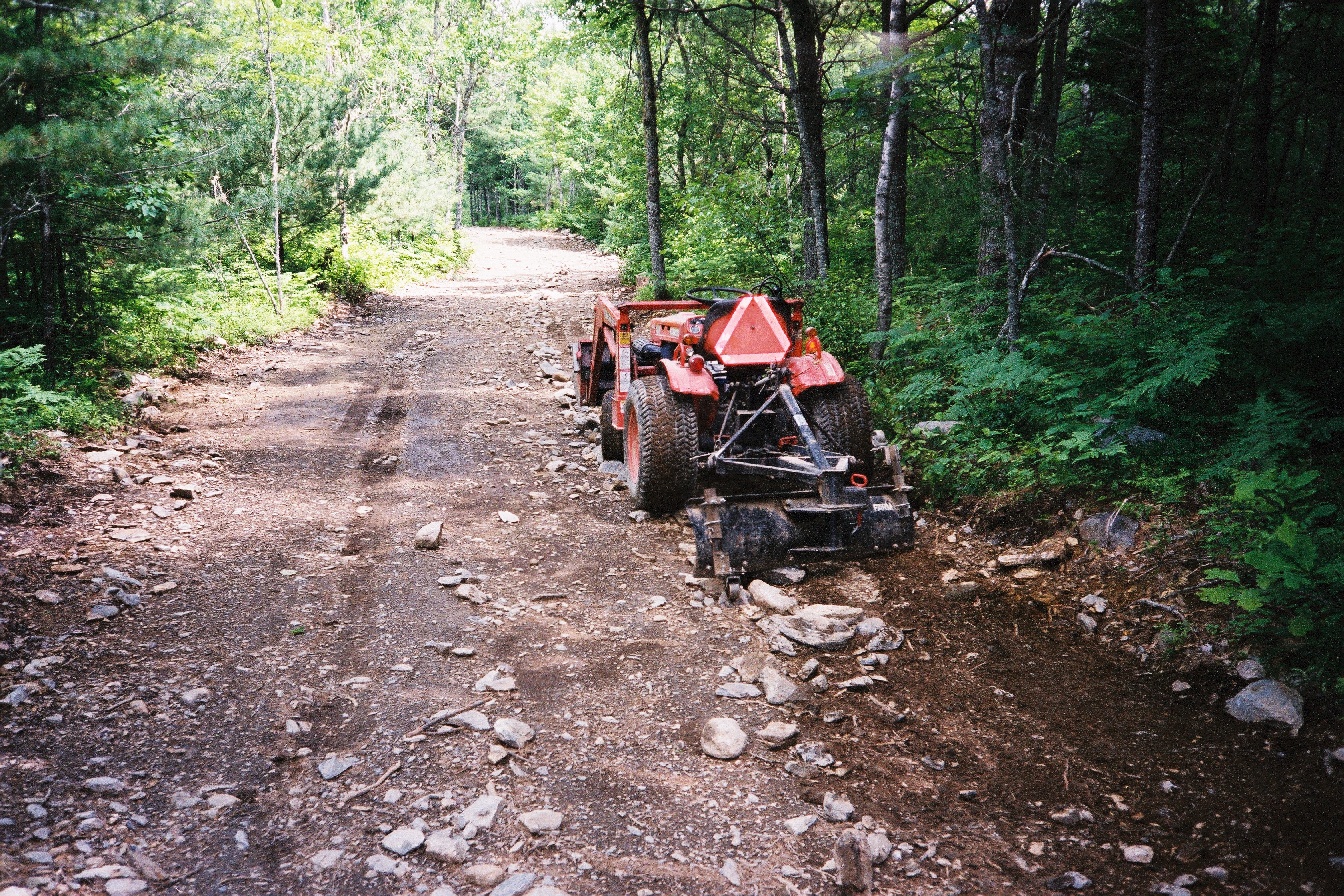

Tractor for 40 acres:
As I take it there may be a budget involved and suggestions of a used tractor. The following pictures are from a few years ago of my Kubota B7100 working on our 68 acres of land in Nova Scotia. Access road, trails, trees removed and stones and logs dragged and snow removal. The little 16 HP tractor was put through its paces. The bucket bottom and cutting edges had to be rebuilt/replaced twice. At times there were chains on all four wheels. It spent about 2000 hours doing this type of work before being traded for a JD 4200.
