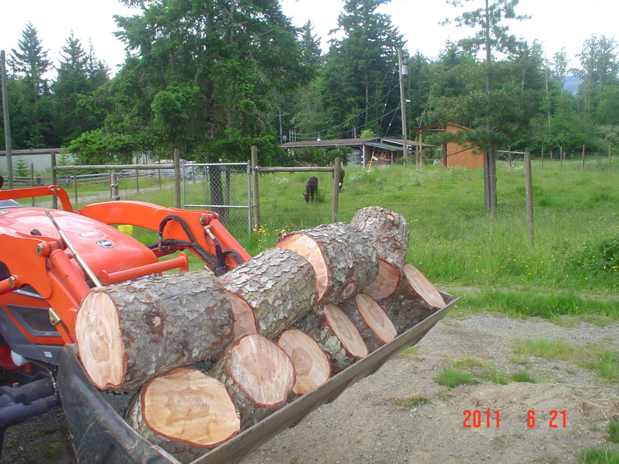

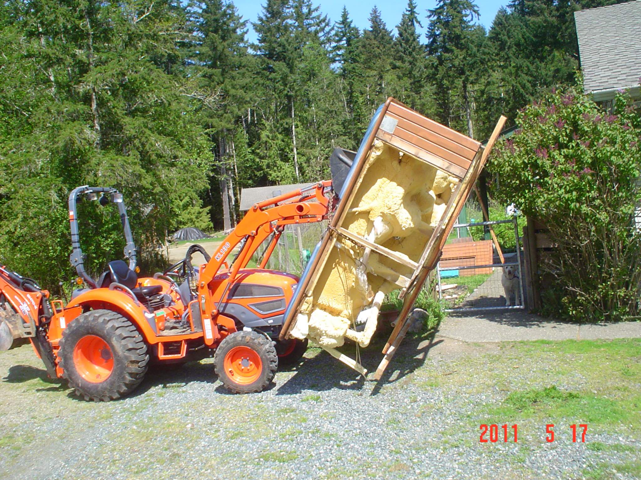

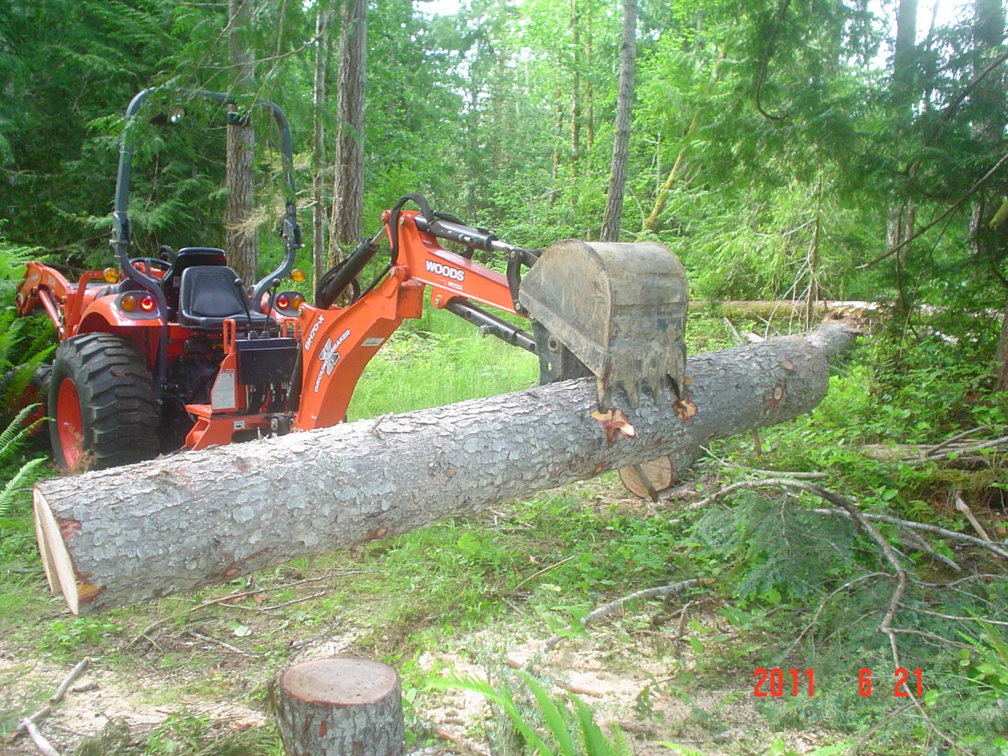

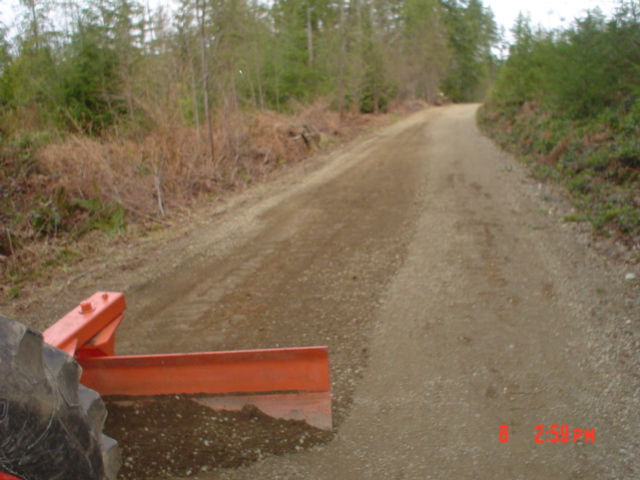

Got my CK35 HST in 2008. Because I wanted to make it easier on my back I ordered it with a 7 ft Woods Backhoe complete with a 7 position thumb.
Our 14 acres is mostly treed and lifting rounds onto my wood splitter was getting tougher. Nice to be able to lift logs to a nice cutting height, that bending over with the chainsaw is hard on the back. I have 335 hours on it and still marvell at what a great tractor it is. It has surpassed my expectations for sure. As well as the backhoe I also have a back blade, box blade and post hole auger. The DK40/45 seems to be a real popular tractor as well. Make sure you drive both the CK and DK models and then think how it would fit into doing all the things you want it to do. :)
