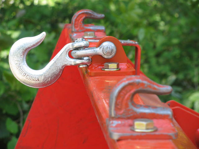

Ken's bolt on bucket hooks for 5/16" chains

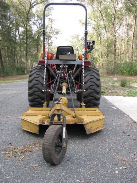

King Kutter 'hog
Bush Hog Rollover Box Blade

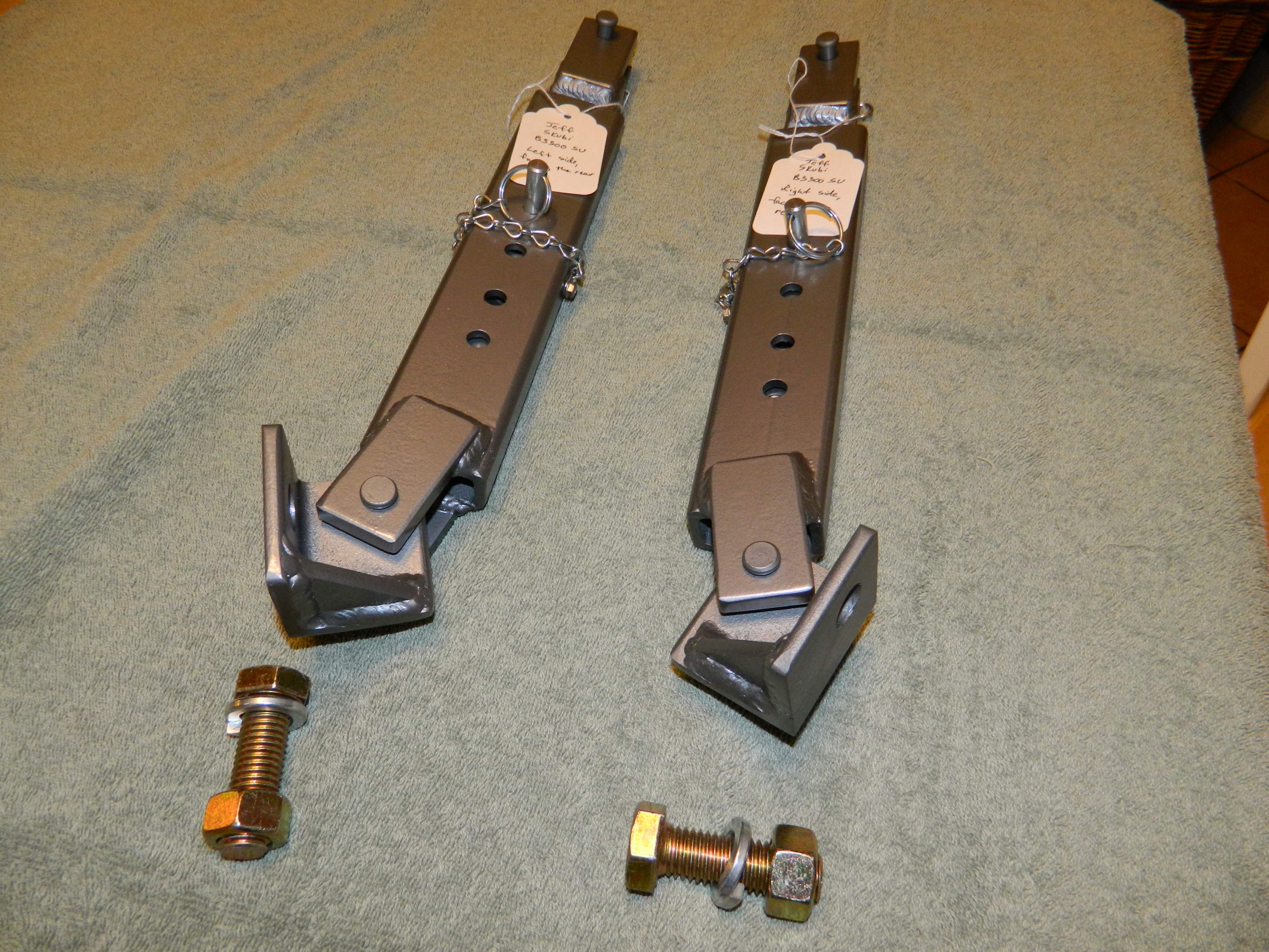

I would early opt for aftermarket Stabilworks rigid stabilizers to replace the factory check chains/turnbuckles early on. Stabilwork's mechs not only make loading implements MUCH easier, they also reinforce the lower links when pushing in reverse with KK RM and ROBB.
