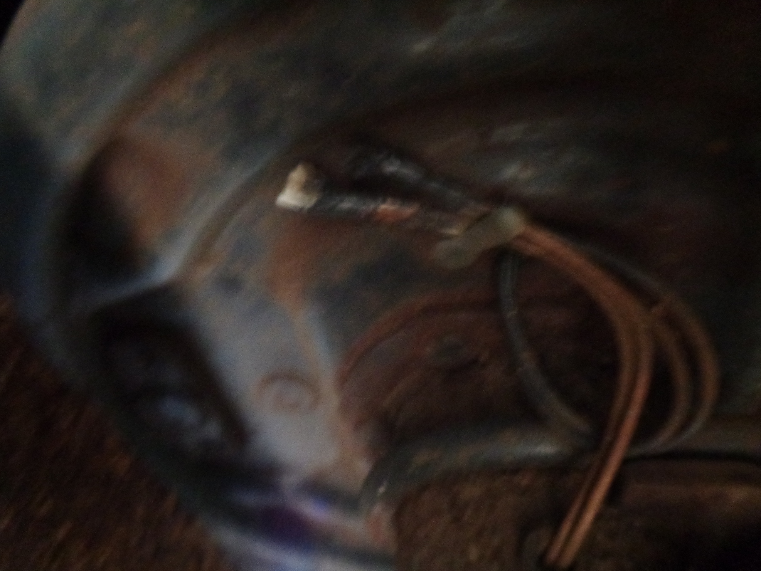

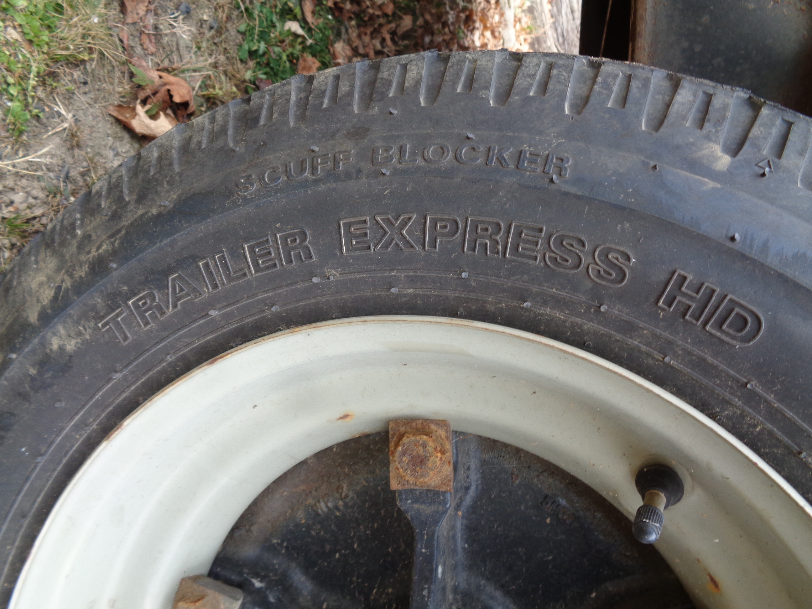

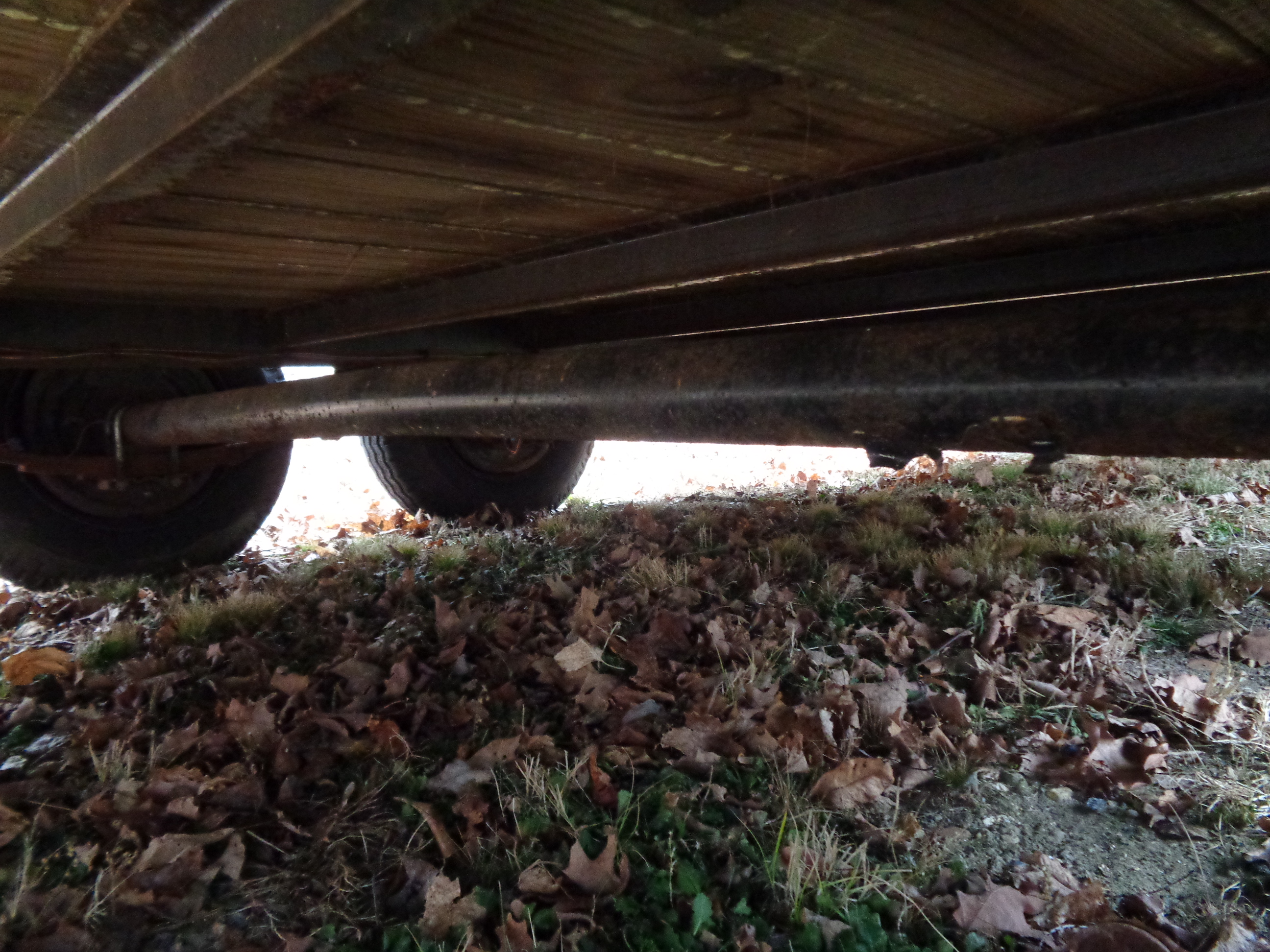

Thanks Aaron for those links. Anyone reading this and looking at the tire links will notice the MH after the tire size which means Mobil Home and the LT after the trailer size for Light Truck/Trailer. Here are some more pictures of the tires, axles and backing plates on my trailer. The backing plates are held on by five studs, I think. I wasn't laying down on the ground to make sure. The axles are sprung in the center for wheel camber. Aaron ?? for you. Are the 7-14.5 and 8-14.5 mounted on the same width rims? I have 7-14.5's on my rims. I found where the 8-14.5's are one inch taller. My guess is that the tires are the same width. I can't seem to find any information on rim sizes for these tires.. I'll keep looking though. My ramps have an added section 2 feet longer than standard. They are 6 feet long total. They will be getting the helper springs added to them for easier lifting.

They make that style of axle/wheel in both non-serviceable "mobile home grade" (cheap, undersized bearings, oddball spindle size, welded brake backing plate, straight axle tube, etc) which are intended to be used once or twice and serviceable "trailer grade" (full sized bearings, standard trailer spindle size, bolted backing plates, cambered axle tube, etc) which are intended to be used day in and day out.
Both are generally rated for around 6000# per axle, one is made to be used once, the other is made to be a heavy duty low profile axle.
One is junk, the other is not.

From the picture, the wheels are mobile home type!
If you read some history on mobile home wheels you will find that due to the different (cheap) wheel construction style, the mobile home wheel itself will often fail, before you can stop after a high speed blowout.
On a tandem trailer, that failure is sometimes followed by a second tire/wheel failure on the same side.
Regular 8 hole steel wheels are much safer!
