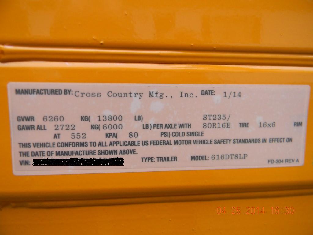

As a general rule if the trailer has 2- 3500# axles it's a 7K GVWR. Subtract the weight of the trailer (say its 2000), That gives a load capacity of 5K. Every trailer Mfg. rates their trailers differently. Some figure in the fact that some weight is transferred to the tow vehicle and increase the load capacity of the trailer by how much weight is transferred to the tow vehicle. That may be the case on the Big Tex. Some don't even give a clue as to the actual load capacity and just state the GVWR. To the uniformed, a person buying a 7K car trailer may think they can haul 7K when that is not the case.
Another example is my own dump trailer. It has 2- 6K axles which to me says it's a 12K rated trailer. Yet the Mfg. rates it at 13.8K minus the trailer weight of say 3300 giving it a load capacity of 10.5K. They figure weight is transferred to the tow vehicle so they rate it higher. See tag. Apparently they figure at least 1800# is transferred to the tow vehicle.

My dump trailer also has 8 lugs. axles are rated for 6K with 16" E tires as shown on my tag in the previous post.
