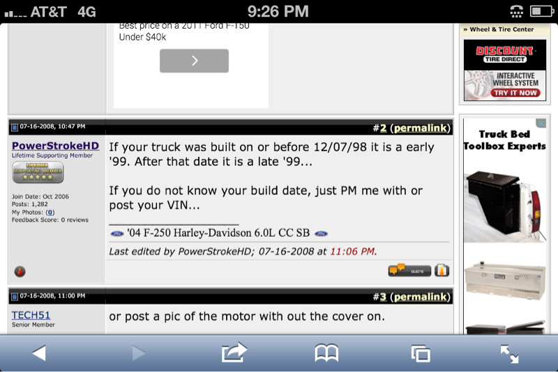

3. There was a slight difference in '99 trucks as the early ones had some different engine components and brakes, so there are times when the build date is needed to ID the correct parts. Some people refer to the later ones as 99.5. Feb or March was the break point for the 99.5 if memory serves me correctly.
FYI... I just got rid of my 99.5 4x4 dually with 95,000 miles a few months ago.
   / which tranny does my 99 f350 ( 4wd, auto ) have? ( 7.3psd )
my 350 is a early one. in fact.. build date of 12/98 for a 99 yr model. And i have noticed a few differences to my late 99 450. there are some dash light differences too at the 99 split as well. the old one don't got it.. the newer ones does. :)

   / which tranny does my 99 f350 ( 4wd, auto ) have? ( 7.3psd ) #8
This is what I found for dates of early and late model 99 superdutys
