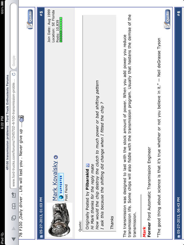

what are the 4r100 trouble spots?
   / which tranny does my 99 f350 ( 4wd, auto ) have? ( 7.3psd ) #19
he torque converter is the weakest link.
   / which tranny does my 99 f350 ( 4wd, auto ) have? ( 7.3psd ) #20
Adding power without transmission mods also can cause problems
